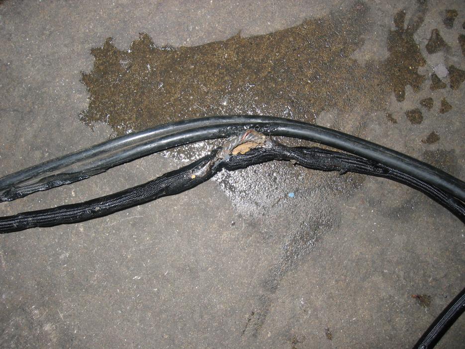

    Without a water solenoid valve, remember you will have to start and stop the water and it will run all the time, not just during arc on time.

    Oh it's absolutely great if you have a cooler, but I was thinking more about your sink type constant loss method. Most welders that use constant loss have a water valve to limit the amount of water they use. I used to work at a place where they had some welders running constant loss and because of the way the building was laid out it was easy to get water to the machine, but there was no drain around. So they had the drain hose stuck through a small hole in the wall and it drained into the parking lot. You could always tell when someone was welding by the puddle outside. What surprised me most was how little water it actually used.

    Oh yeah, it really helps to keep the torch cool to have it run all the time. But you'd better be damn sure you remember to turn it on, before you start welding, or your power cable will go poof! With an automatic setup you can't forget. Or if you have a cooler, it's no problem to just wire it up to come on with the welder. I think the 200DX has an outlet in the back just for that. But if you run off the sink, maybe hang a sign on the power switch to remind you to turn on the water.
    That's one other advantage of CK torch setups, they have a thing called a torch saver that has a fuse block that will blow if there is no water flowing. I think I saw that the 250EXT had a water flow sensor that would cut the current if your water stopped as well.
    Relying on yourself (or other human) to turn on/off water valve is risky...
    Here's what happened to an expensive CK superflex cable when someone in the off-site shop I was welding at turned off the water in a laundry tub faucet cooling the TIG setup I was using. That was not a good day...
