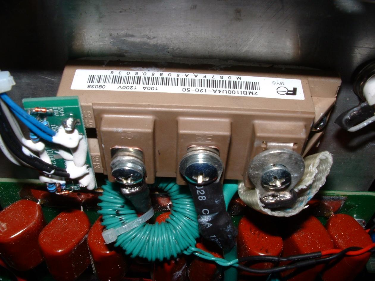

    The difference in IGBT modules versus individual transistors improves overall quality control and serviceability, and service life. Plus it offers a weight reduction and a decrease in component circuitry. The Modules just bolt on basically. These are a "pack" of IGBT's that are premade into one little block. The individual IGBT are hand soldered onto a larger circuit board and have a larger room for manufacturing defects. Here's what the difference looks like, although this one picture is of mosfets, instead of IGBT's. They are similar in appearance, but the way they are mounted, the idea is the same:

    So simply put, just so we can be sure to follow, the difference is that with the 'modules' if there's an issue that block can be easily swapped out, whereas in the other machines without modules, the whole board has to be serviced?

    Less weight, greater reliability and simpler internal design. Also the lower arc start on the 250EX is helped by the modules.
    Generally speaking, you want fewer parts as that means fewer pieces that are manually assembled. Manually assembled pieces could possible increase the chances of human error. Higher density packaging allows the overall heatsink to be smaller so the case can potentially be smaller. Smaller heatsinks and fewer components also allow for a lighter package.
    More components doesn't mean less reliability if the manufacturing process is performed by skilled assembly staff using quality components on well designed product.
    When it comes right down to it, for me, I bought my welder because of the company behind it. The actual electronic components used inside were secondary. I want to be able to sleep at night after plunking down my hard earned cash.
    Actually, more components do mean (all things equal) greater changes of failure. Chances of failure on machine that has 10 parts is less than a machine with 100 parts. Electronic or mechanical parts fail and the more there are the greater chance you have of something failing. Design yes, has something to do with reliability, but when you are dealing with something that has the potential of sufferering a lot of abuse, the simpler the better off you are. The best designed cars in the world are from Mercedes and BMW, but they are not known for the extreme reliablity because of all the sophisticated electronic and component design.
