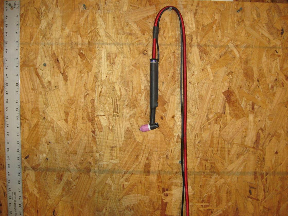

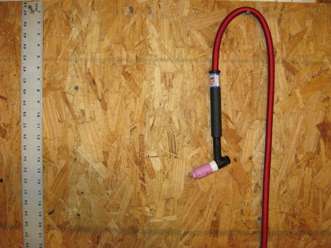

    Here's a couple pics of the CK 130 and CK 210 hanging to give an idea of flexability. Click image for larger version.

ID:	8408 The cable/lead is much heavier on the 210.

    The CK 130 or better yet the CK Flex-loc 130 with a superflex lead is the way to go as it will handle 150 amp ac or dc at 60% duty cycle with no problems.
    If you go up to the next size torch that's gas cooled you'll have a much heavier lead that pulls on your torch and gets in the way.
