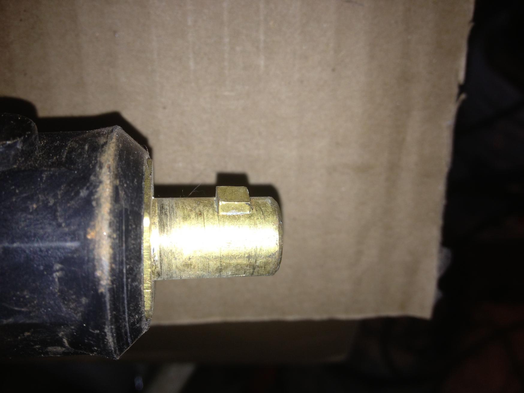

    is the CK-SL2-35-LG the proper adapter to use a ck flexlock torch on the 210ext ? the dinse on the torch that came with the welder has a shorter pin in front of the lock tab than what is on my lincoln torch.

    Most of the time they will work. The one on the 210 ext is actually a 35/50. The biggest difference that you need to observe is where the gas/water line is connected, because the recess on the torches we sell for the other units is a little too close to the connector and the line hits on the bezel when you try to screw it in.
