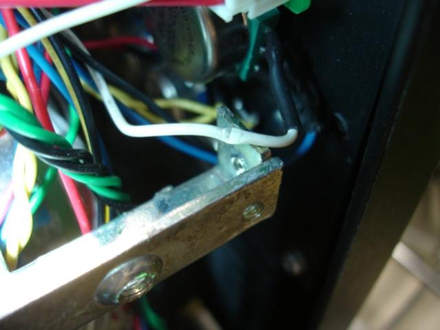

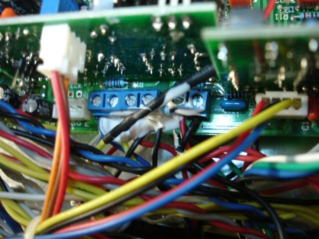

    So I was told that the behavior I was seeing in the video was the pulse unit being enabled so I took off the covers and here is what I found>Click image for larger version.
    This wire, the ground (common pin of the pulse switch) had pulled out. I assume it goes into the right most position of the 4 position terminal connector. I didn't reconnect it because I am going to make it an inch longer but I need to grab some heat shrink at work.

    Here is where that wire goes. The black wire in the center pin of the switch.

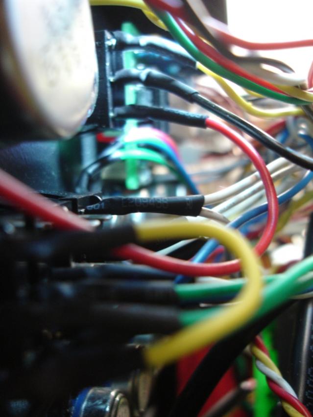

    While in the machine I also found this>

    Again it was too short to dress properly. I'm going to extend it too. I'm not sure it was grounding to the chassis because I still had control of the current but I think I just lucked out. I'm going to bring home plenty of wire and heat shrink and do a little better job of lengthening and dressing the cables so this doesn't happen again if I ever have to get in there to adjust the points. It would be nice if they were accessible from an access panel on the side of the machine but that would probably require an interlock switch to avoid lawsuits. Being an engineer myself I can appreciate the balance between cost and practicality. I can also appreciate how hard it is to get Chinese contract manufacturers to dress cable harnesses the same each time!
    All fixed up again.
    All fixed up again.
