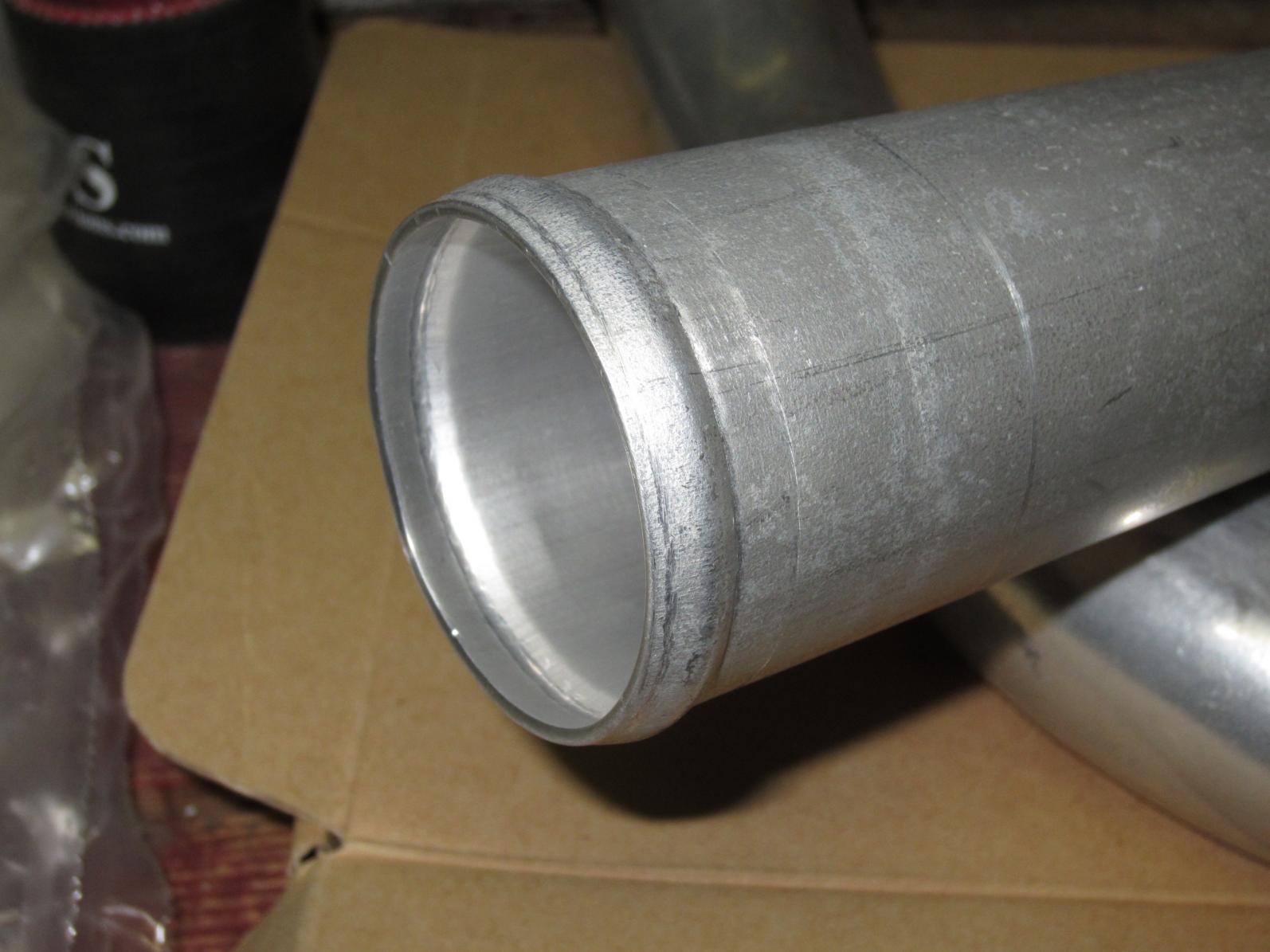

    I have a tool I made out of vice grips that I use to form a bead around the end of tubing. You have to work your way around a couple of times with it, just moving a little bit at a time, but it gives really nice results and is perfect for just doing the occasional one of these. Looks like it was rolled with a bead roller (yet takes up far less space to store.) It works well for tubing that's about 1/16" thick. Let me know if you are interested in pics

    Found it!

    I used 7" long vice grips to make it, but if I did it over again I might use 10". I think I used the cut off head of an eye-bolt to make that. The steel is a little bit soft but it works fine for thin-gauge tubing.
    Using it is not real fast, but is kind of fun and gives great, professional results. The trick is to insert the tubing a consistent amount (I used a marking on the tool to tell how deeply to insert the tubing) and also it's important to keep the tool parallel to the tubing. Then you just clamp it, open it, move it a little bit sideways, and repeat that until you've gone all the way around. (Then, maybe tighten the vice grips a bit if a more pronounced bead is desired, and repeat around another time.)
    I've had this for several years and used it on several projects. I've even used it to form beads in tubing in place (an intercooler left installed in an engine compartment) - can't do that with a bead roller!

    In follow-up to the above post, I found a decent looking bead I formed into a tube with the above tool, and got a pic for demonstration purposes. It's 2" diameter, .065" 6061-T6 boost tubing that I took off my race car; and the formed bead allows a standard style worm-drive hose clamp to reliably retain a rubber connector with ~28 psi boost pressure.

    I've formed beads in mild steel tubing with about the same difficulty as 6061-T6 for the same tubing thickness. Stainless I may have not actually tried, but would work OK I think as long as it's one of the ductile alloys (like 304) and is in an annealed state. (work hardened that stuff can get so crazy hard and might crack before it forms... but if it's mandrel-bent tubing, it's probably annealed prior to bending.) I've also formed some beads in some much softer alloy aluminum tubing that was definitely a lot softer than 6061 (although not sure, I suspect it was 3003).
