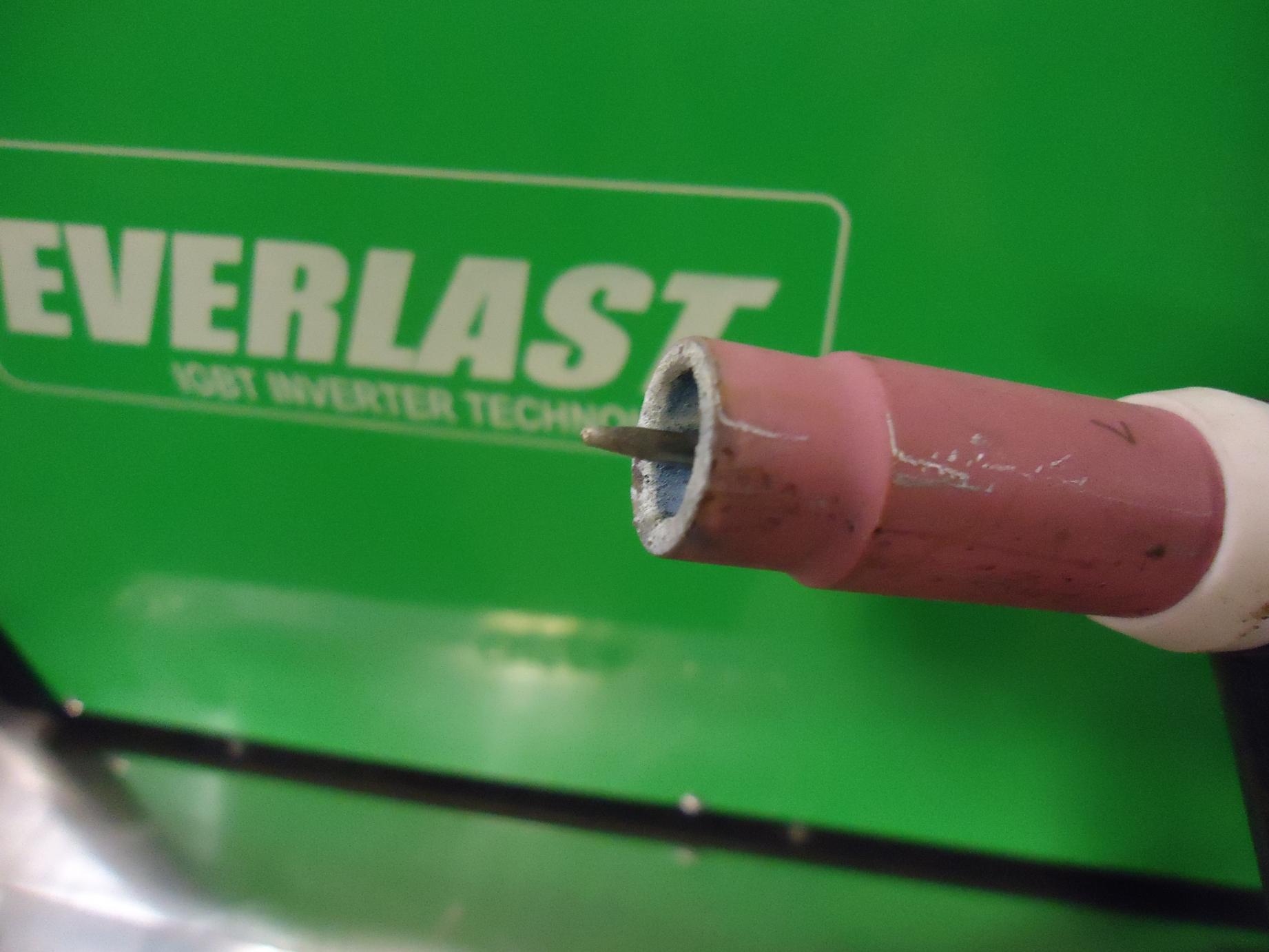

    Tried something a little different this morning, dropped amps to 95 no pedal, did some different vertical up and down welds with 1/16" Filler and 3/32". Pulled the tungsten back to about 1/4".
    All freehand no rests done while sitting.
    The corner joint was done with 3/32, Butt joint was 1/16", edge or lap joint with 3/32" turned the balance down a little also.
    I ran a couple of beads down also to see how the puddle did, feeding the filler from the bottom did not produce as nice a weld as feeding it from the back.
    Would like to some time try this with a pulse machine and maybe a different type wave also.
