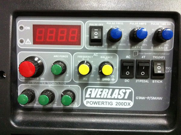

    I just received my 200dx last Thursday and here is what it has on the front panel
    It does have the extra button on the bottom that I see, don't know what is new from the old cuz I am total noob here as well as tig welding. I got mine through Amazon at a better price than what it is selling now. I was looking at the blue machine first but so far I am happy with my decision and have been playing with it, I LIKE! It came with a 20A 220 plug??? are you kidding me? They should not include that at all as it is underrated for the machine.

    You can compare it with the old one here.
    So the difference is more pulse settings and pre flow knob. Well that only makes mine more complicated.
