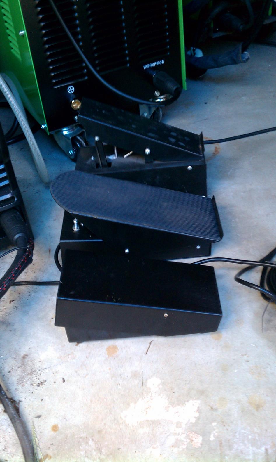

    Our pedals. No SSC in the picture, just Everlast pedals. They range from 3.5" high (far left 210ext only 1K) to 8" old school far right (47K). Our low profile is 4.25" high (47K) in the middle and not a bad pedal at all.
