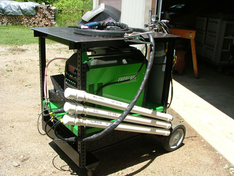

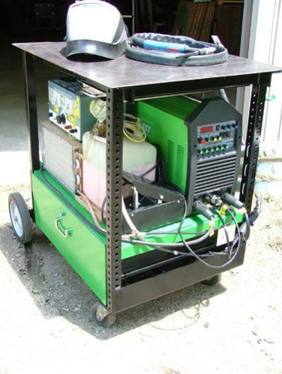

    Nice cart/table! Similar to one I made awhile ago, when I received my PP256.

    Nice! Very similar cart/table. I may do the drawer thing you did but obviously on top rather than on the bottom.
