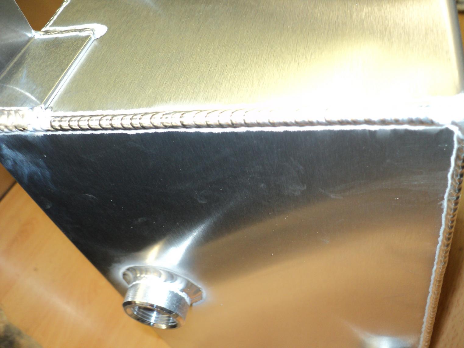

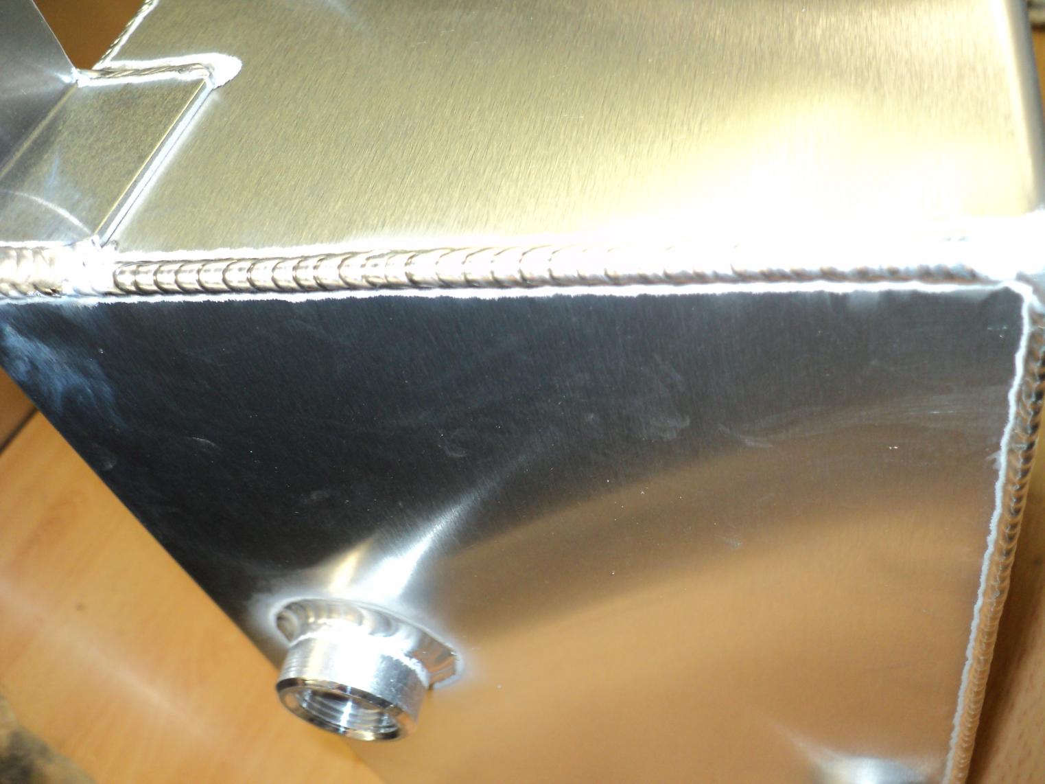

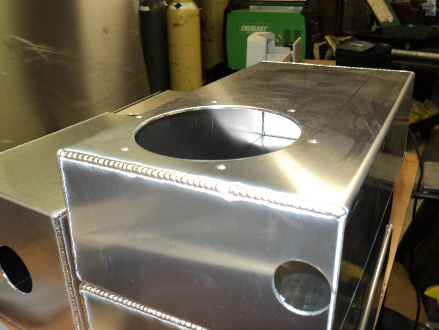

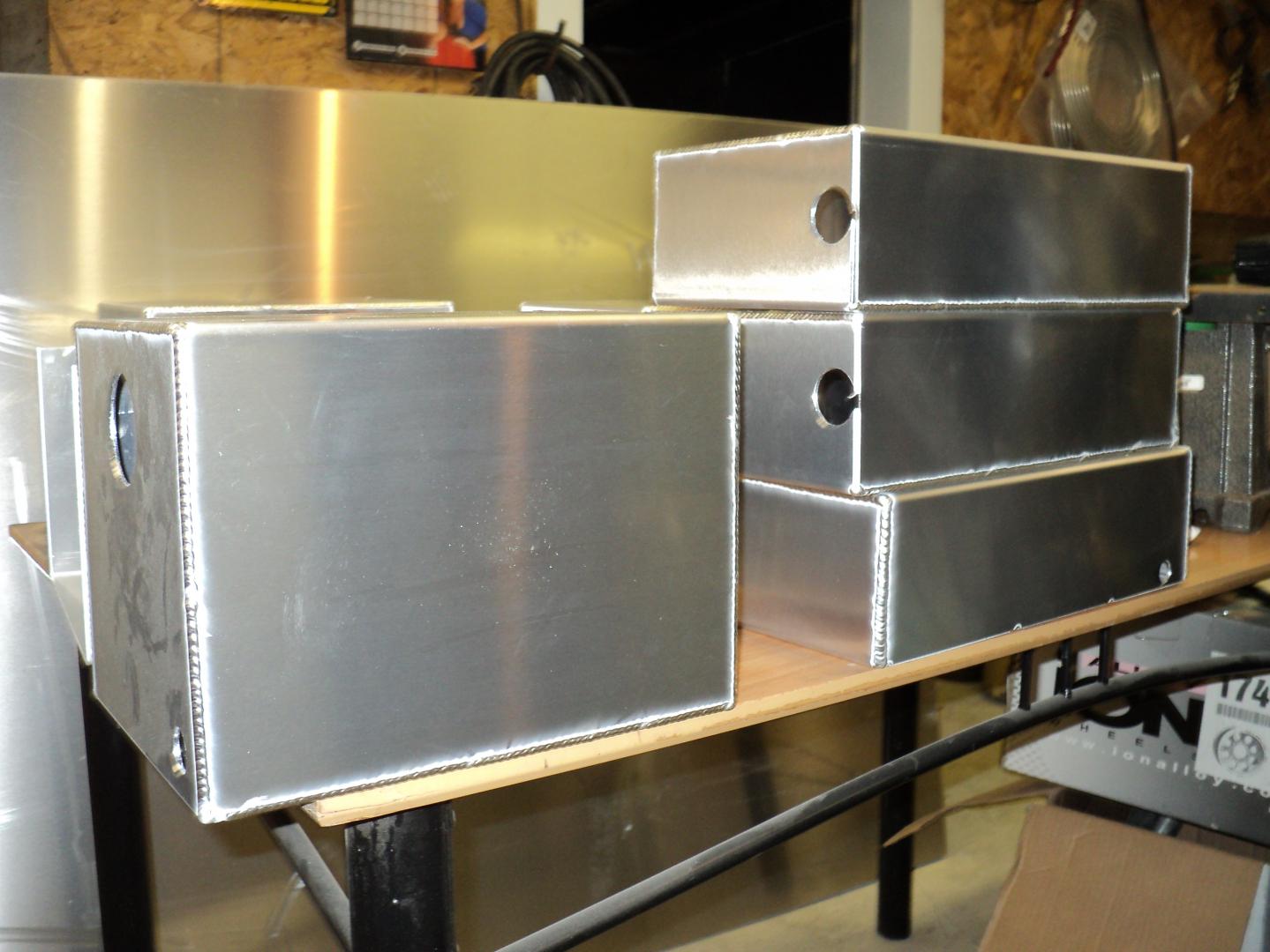

Welds look great Nice work. Glad all the bugs seem to be gone.
