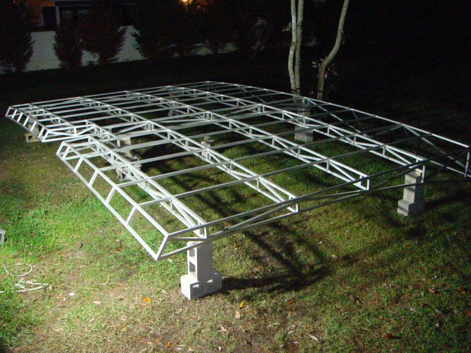

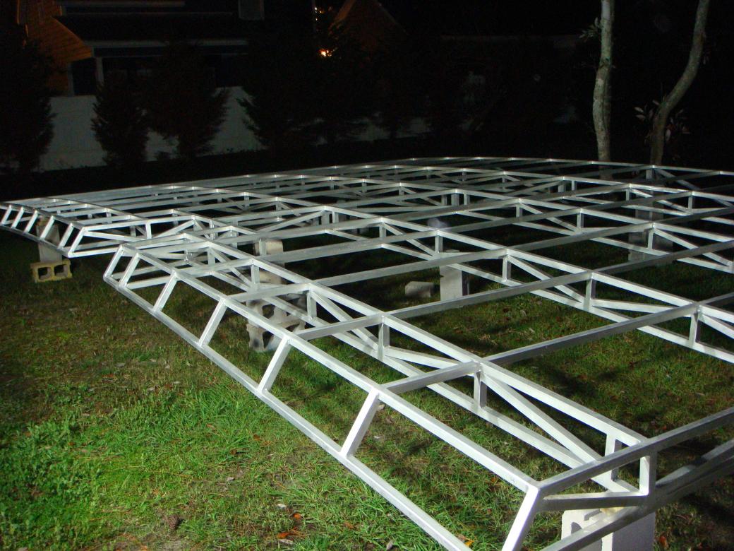

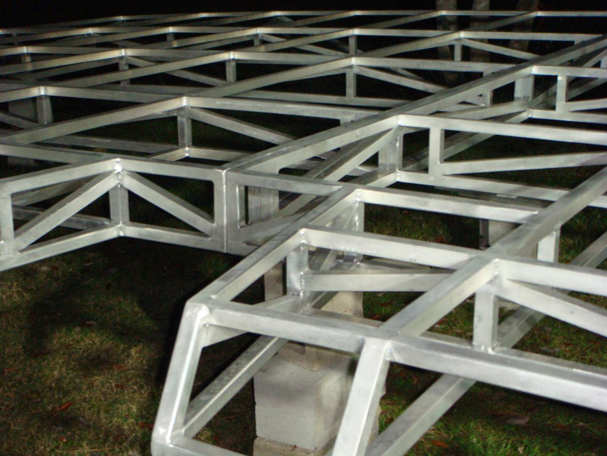

  1. Default Catamaran Awning 1,300 of tubing
    1.25 x 1/8 aluminum, everything was tig welded with my new 256 @ 240A and I’m starting to wonder where the duty cycle is I cant seem to find it LOL... really never hit it, all I ever did was wait on the duty cycle on my 300lb Lincoln precision tig 225 the old fat girl just sits in the corner these days just watching the the little green machine work...

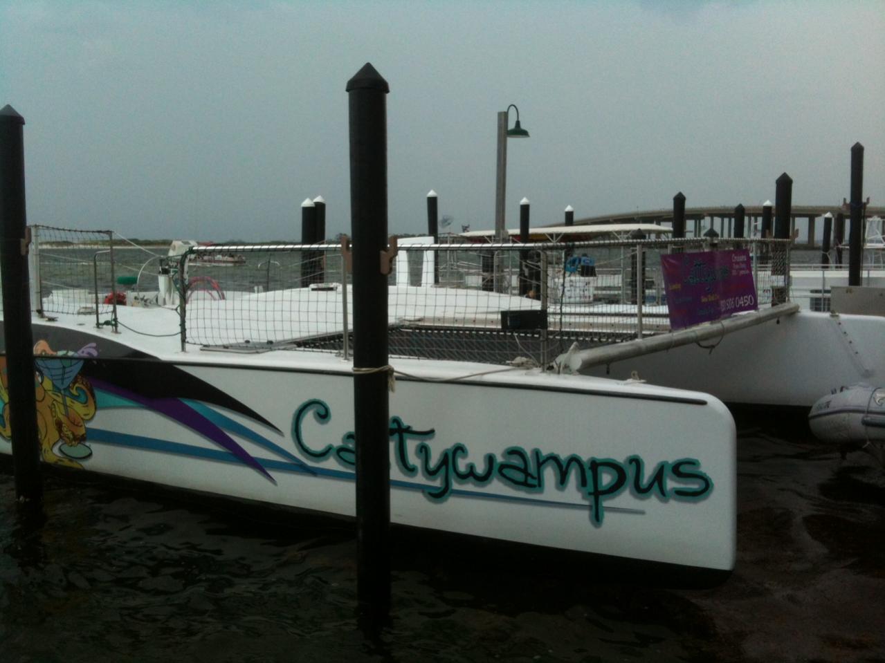

    Nice work. What are the dimensions and weight of this awning and how big is the boat ?
    I'm going to guess a tick over 800lbs finished weight, depending on how much scrap was made with the cuts.
    Were you really using 240 amps to weld this or was the machine just set on 240A?
    Pedal or torch switch?

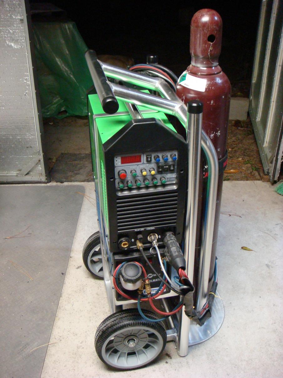

    240A maxed out start tapering off the amps right at the end, I did all the welding at night when it was cool. its around 700lbs of tubing but is built in 2 pieces its split in the center. catamaran is 50ft long 30ft wide, I did the handrail on it to. I always used a pedal until I picked up this rotary now I never use a pedal

    Thanks for showing just what the 256 can really do. I have been undecided between the 250EX and the 256, and seeing things like this really helps.
    10lbs+ 3/32 4043, 1lb 1/8

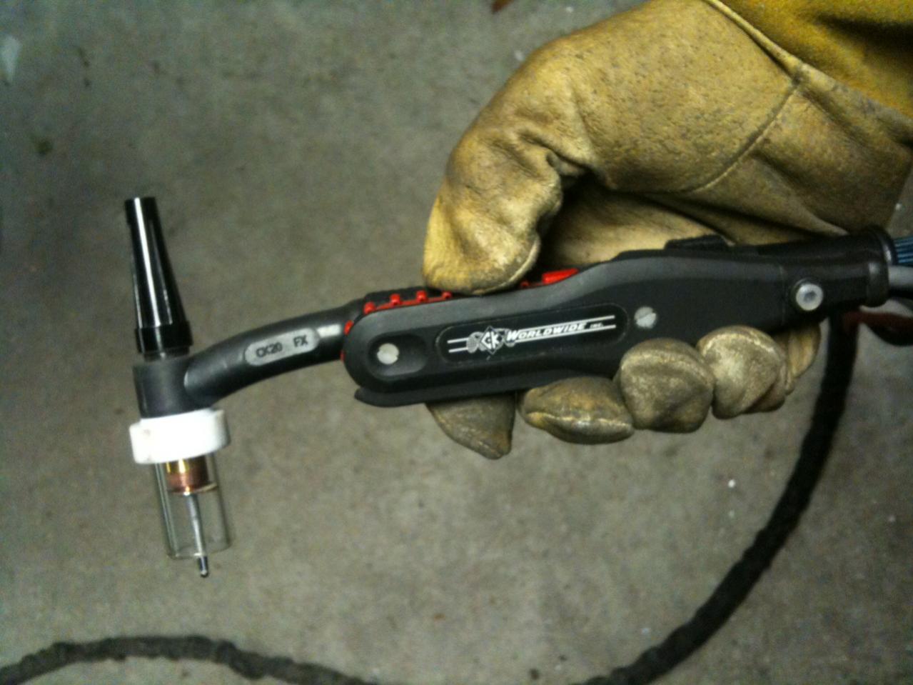

    yea the only hold up is the amperage limitations of a 1/8 size tungsten
    Quote Originally Posted by balleman3 View Post
    Have you tried 2% lanthanated ?
    I read somewhere 1%zirconaited holds up best on hi amperge AC so I ordered a 10 pack but I will try out the lanthanated thanks
    I will put it this way. Though the 256 is a capable machine, it is not designed for this kind of continuous production work. Long term use like this will demonstrate why eventually. 35% duty cycle. Just because you didn't hit the thermal switch does not mean you did not push past the duty cycle once in a while if you were welding at night. It's a thermal switch on the heat sink. But the transistors need a rest once in a while even if the heat doesn't trigger the thermal cutout. You may have an exceptional unit there, but we are telling you that the 256 has its limitations...IF you plan to do something like this regularly (or ever) the 250EX is the best and preferred choice.
    Zirconiated is for transformer welders mostly. It does not enjoy an advantage with inverter welders on AC that I am aware of.

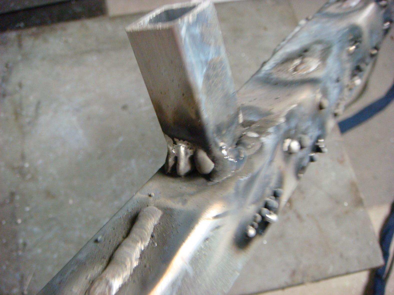

    Well how do I know how much is to much and when to let it rest? The air coming out of the vents never got warm. It will be some time before I can get a 250 as I already have 2 tig machines, I used to hit the thermal cut out on my precision tig 225 all the time and got an idea of where it was after awhile, I could also feel the air temp and heat of the machine itself, there is no indication of where my limit is on the everlast. I weld at home as a full time job so now you have me concerned about this

    yea as soon as it started to puddle i was on the move fast and I’m used to tiging as fast as the power I have on tap will let me, done a lot of aluminum in the past. sometimes after running for awhile it seemed like the amperage would start to drop off on its own toward the end of the weld I thought it was my imagination but now I think I was overdoing it, I just figured it would cut itself off if I hit the duty cycle like my transformer unit. I only welded one flat at a time so most of the amperage was expended on getting thing up to temp the air temp was in the 60's and machine was outside
    on a side note
    is my 250p supposed to have a - symbol in front of the amperage display the lcd shows -250 is that correct? could the plug be wired wrong, It is not welding good at all, like the polarity is wrong, same with the spoolgun

    No that shows it is reading relative wire speed. It will change to amps once it starts to weld.
    Are you using pulse? Don't until you know how to set up the MIG without it.
    What wire diameter are you using? Do you have the work clamp in the negative, or rather, work? Which groove are you using on the drive roll? What wire type, gas type, and gas flow rate are you using?

    clamp in (work) - pulse seems to help on flat surfaces but no not using it now trying to get it to weld proper without first. tried
    Steel %75ar-%25co2 .035 1/8-1/2 in thickness all kinds of combinations of V and amperage always starting with the recommended settings and slowly moved around from there.
    Aluminum %100 ar spoolgun .8mm wire .090-1/4 in thickness all kinds of settings and thicknesses always starting with recommended, same result piles up on the surface or jumps to spray arc and melts to a ball 1/4 away from work and flows with gravity from there only looks good on flat steel cant really put it where you want it
    I have worked as a mig welder in the past so I have experience adjusting mig machines, also used to build aluminum awnings for another company using a spool gun everyday
    I still have to put the tie bar in for the awning caves I really dont want to have to tig weld the 125ft of 3/4 by .090 aluminum square tubing thats what I bought the mig for
    is there any way to adjust the wire speed without messing with the amps?

    It almost looks like you might be sucking air into the gas line from somewhere. Maybe do a through check for leaks, end to end, especially inside the MIG gun, if you haven't already.
    MIG is CV, all the machine sets is voltage, amps are drawn based on wire speed and arc length, it will deliver whatever is required to maintain the voltage you set, until it maxes out.
