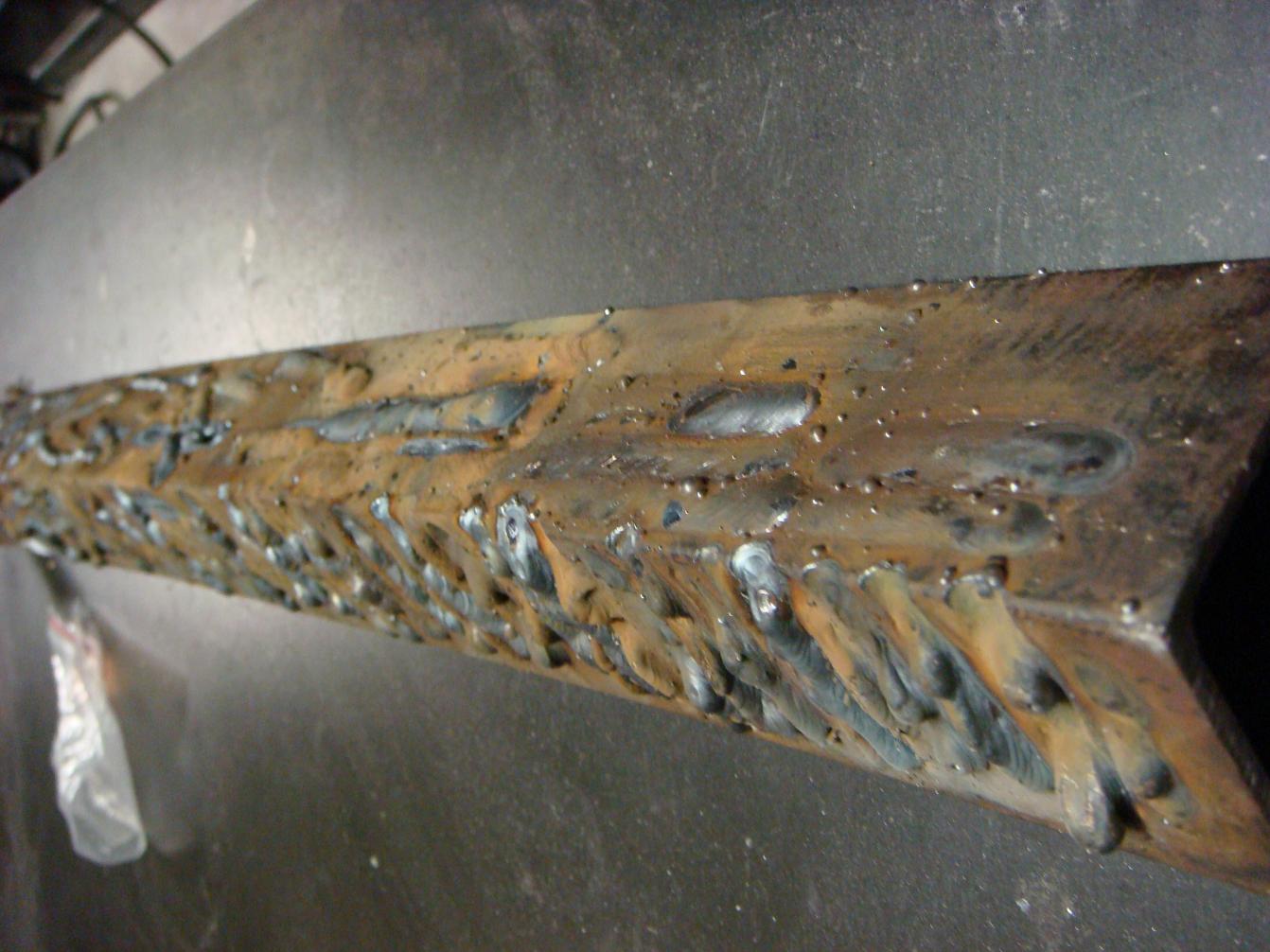

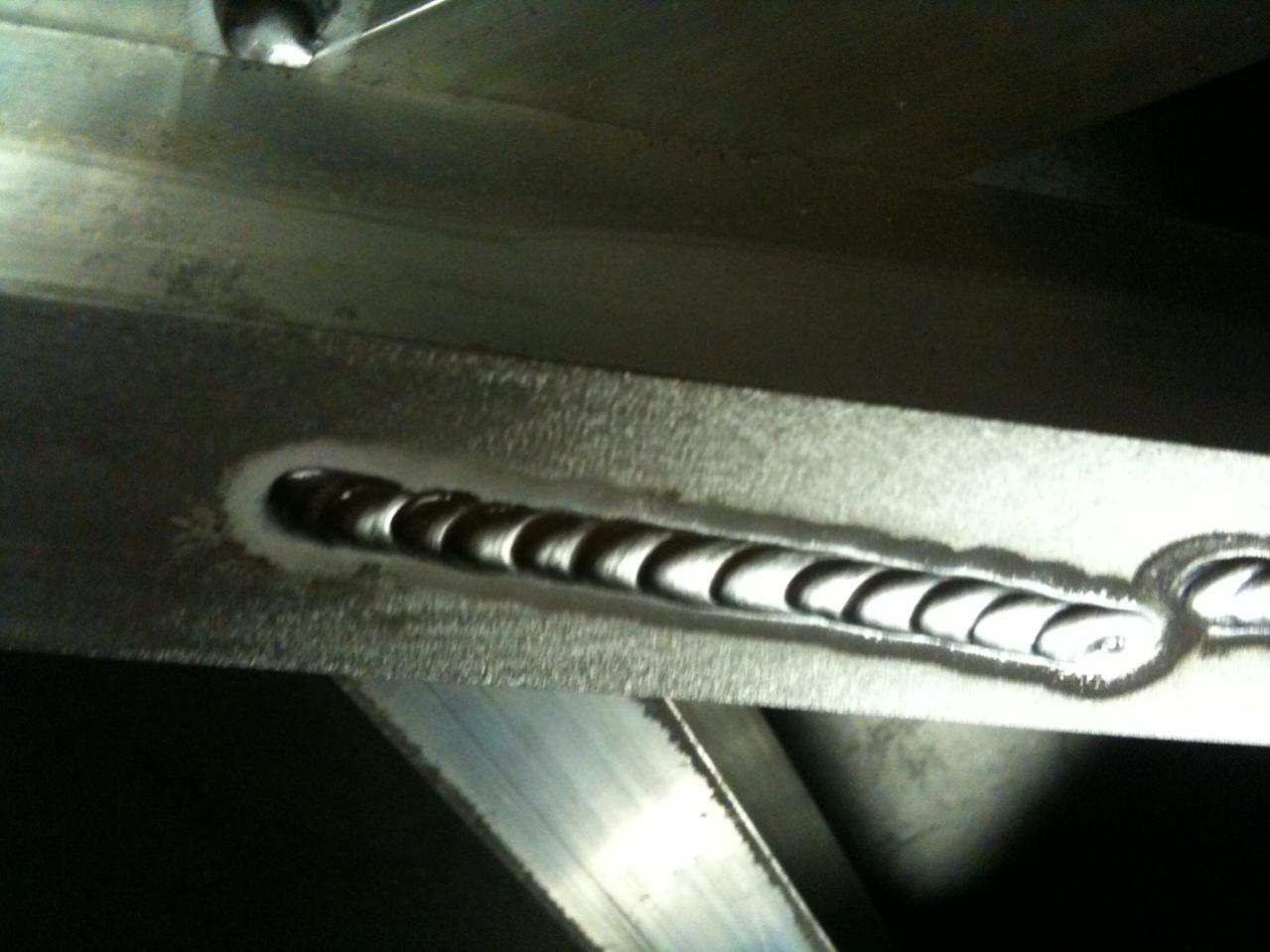

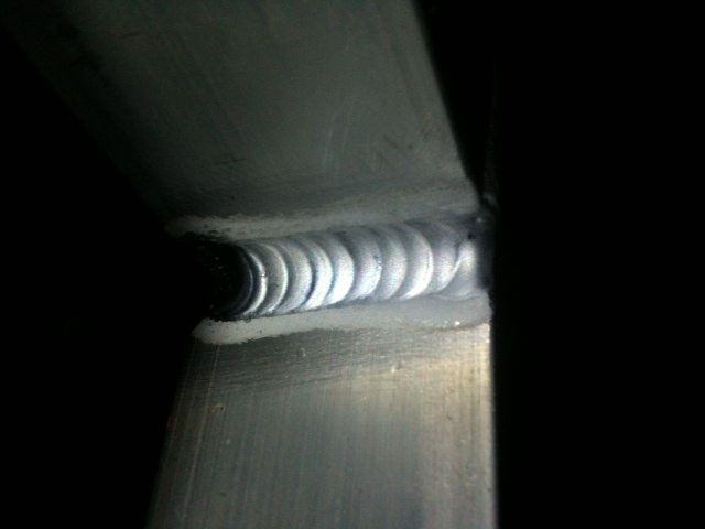

    clamp in (work) - pulse seems to help on flat surfaces but no not using it now trying to get it to weld proper without first. tried
    Steel %75ar-%25co2 .035 1/8-1/2 in thickness all kinds of combinations of V and amperage always starting with the recommended settings and slowly moved around from there.

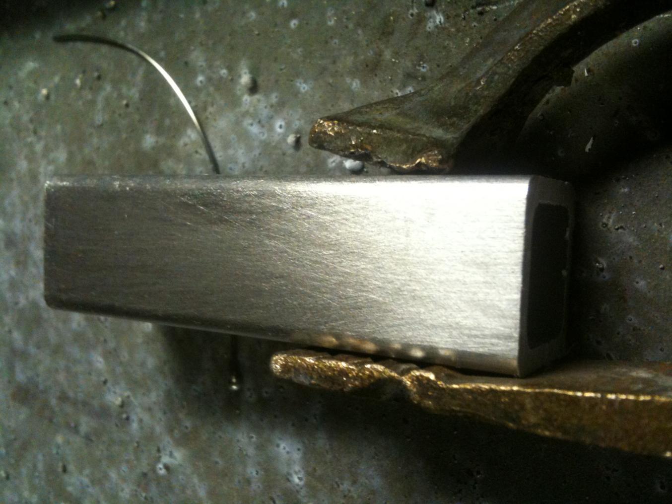

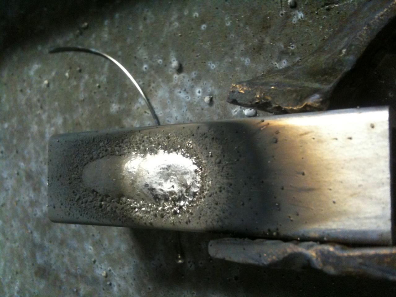

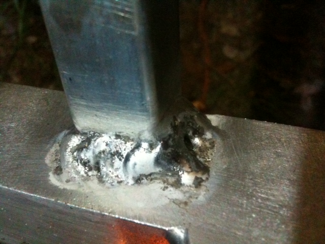

    Aluminum %100 ar spoolgun .8mm wire .090-1/4 in thickness all kinds of settings and thicknesses always starting with recommended, same result piles up on the surface or jumps to spray arc and melts to a ball 1/4 away from work and flows with gravity from there only looks good on flat steel cant really put it where you want it
    I have worked as a mig welder in the past so I have experience adjusting mig machines, also used to build aluminum awnings for another company using a spool gun everyday

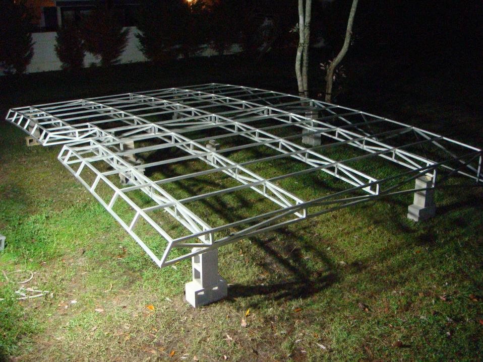

    I still have to put the tie bar in for the awning caves I really dont want to have to tig weld the 125ft of 3/4 by .090 aluminum square tubing thats what I bought the mig for
    is there any way to adjust the wire speed without messing with the amps?
    Attachment 8269Attachment 8270Attachment 8271

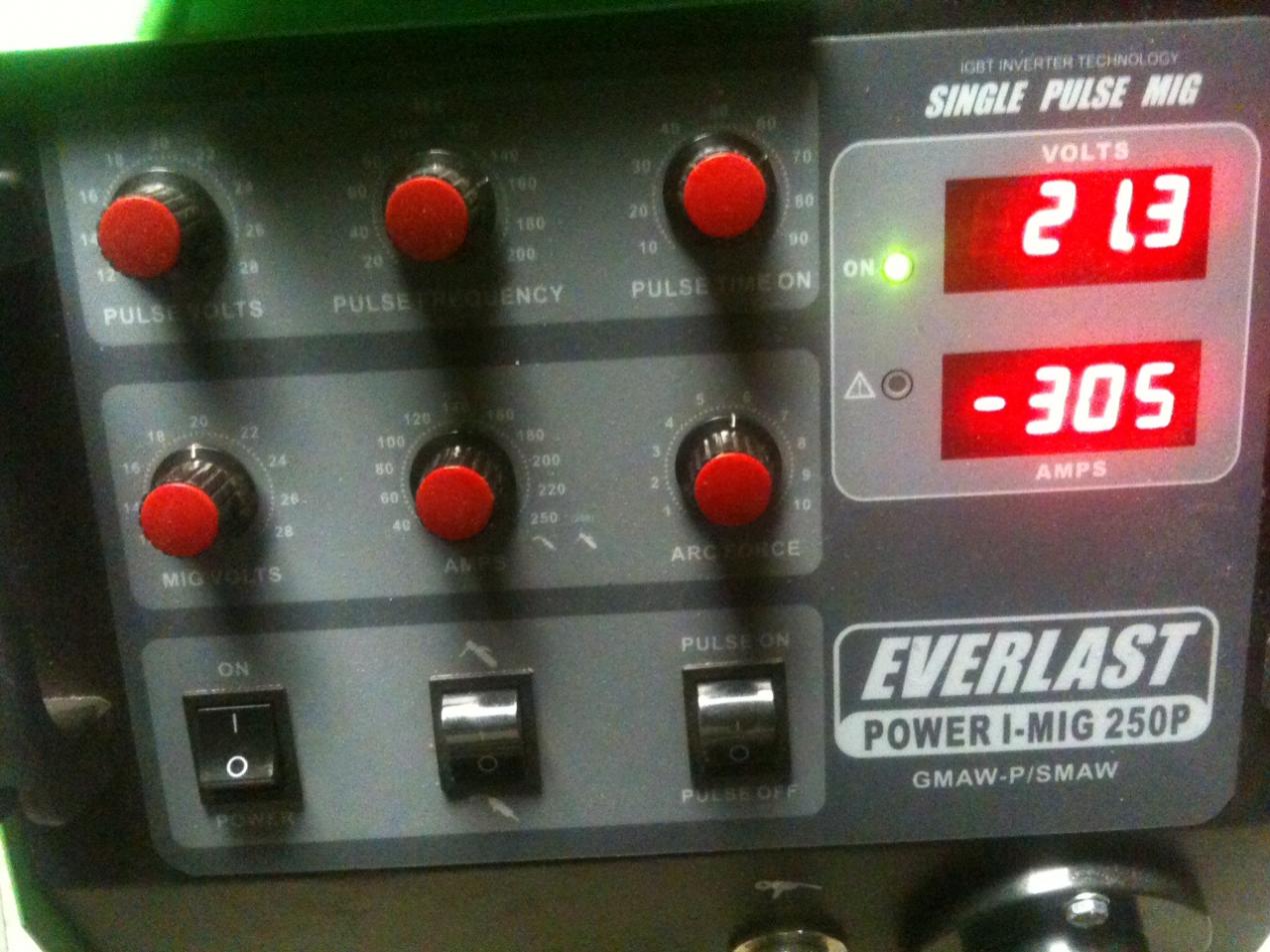

    I don't mean to sound harsh, but it sounds as if you need some instruction in MIG, because wire speed and amps is the same thing...you cannot divorce the two EVER...not in true mig. Where is your arc force set? What settings are you using? Again, which drive roll are you using for the steel? And how are you controlling wire speed on your spool gun?
    AND Pulse in MIG is designed for spray.
    Also what I see is a shielding gas problem. What is your gas flow rate?
    Tried arc force in all positions but usually start on 50%. gas flow rate 25cfm 75%-25%co2 on steel with the mig gun, same with argon on the spool gun. I am using the .8 drive rollers that cam in the machine for .035 wire. sorry about the confusion on CC and CV I was just used to adjusting the wire speed at spool gun it has been a few years since I worked as a mig welder, had a brain fart but I never had a problem before adjusting a mig machine just went with the recommended settings and adjusted from there I have a lot of time on a mig and can lay a good bead in all positions but something is definitely way off here
    same result globular transfer piles up on the surface with no penetration or jumps to spray arc and melts to a ball 1/4 away from work with no control

    Are you sure you are using the .8 mm and not the larger groove? Also if you are using our regulators, they are in lpm, not cfh. You are blowing out about 50 cfh if you are using our numbers as a guide.
    The spool gun adjusts on the panel. With .030 wire, try about 17.5-18 volts then run wire speed up to about 200-220....with standard steel and the regular gun.

    I also have to cycle the power on the machine a lot because the arc doesn’t start is this normal

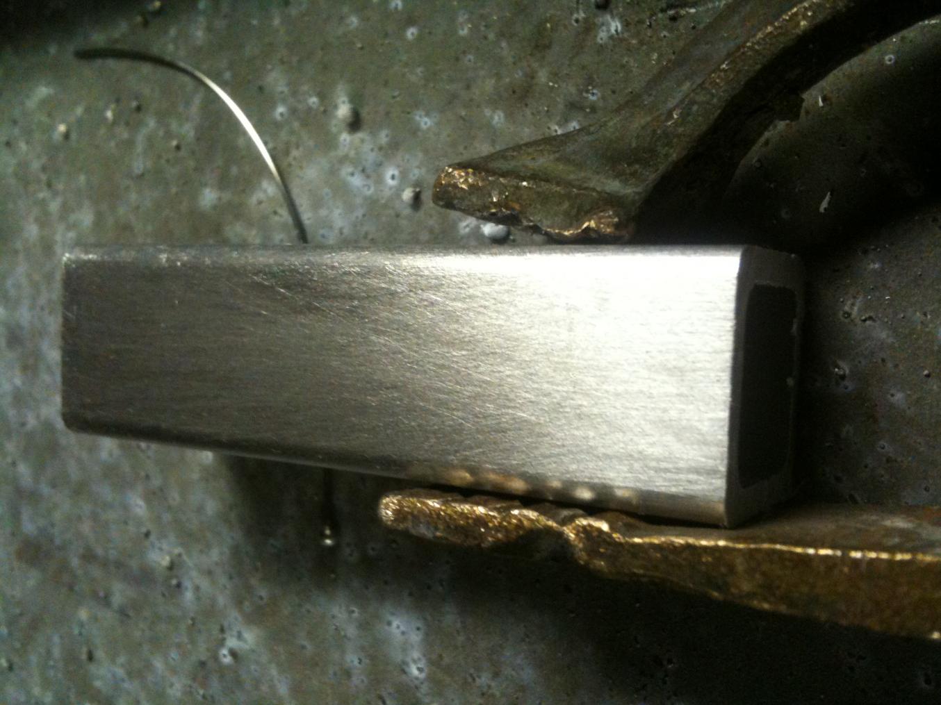

    I also have to cycle the power on the machine constantly because the arc dose not start when the wire makes contact, Its the same ground cable-clamp I use on my tig with no problems

    Can you try it with the gas down around 12-15 CFH. It really looks like there is some kind of shielding problem. Granted you may also have an electrical fault, but black soot only happens when there is oxygen present around the weld. Even if the machine is putting out some crazy wave form that will never weld, you shouldn't be getting the soot. That just isn't caused by the electrical properties of the arc. The other symptoms may very well be a problem with the machine, but you need to isolate things one step at a time. If you have a volt meter you might want to double check the machine polarity. Make sure the torch is really positive, forget what the labels say and measure it. At the same time you can verify that the voltage matches the display. Is the wirefeed displayed about right? Hit the button for 10 seconds, without welding, and measure how much wire comes out. Someone from tech support can walk you through opening it up and checking the main connections inside the machine, if you want. Does it act like the power is weak or cutting in and out? There just really isn't all that much happening in a MIG power source. It's basically plain old DC. As long as the voltage and polarity are correct it should weld. If you can post a video, it might help, even if it's just the sound.

    There are still some things that you have not answered. Most important being what is your arc force setting? This is important to how the arc lays out and the penetration received. Typically about 75-85% works for me, but everyone's different.
    1) FORGET the charts. An experienced welder should set the welder by his eyes and ears not some chart. The setting I gave you is for steel, and is good place to start albeit a little low. The welding you are doing looks like the voltage is too high anyway.
    2) The wire speed is not in inches per minute...It's in a rough ball park, but it is a relative wire speed. To get actual wire feed speed, you need to press the trigger and spool off wire for 10 seconds, then measure it and multiply by 6.

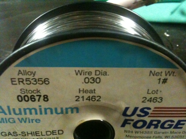

    3) When you use a spool gun for aluminum, you have to go to the next size up contact tip or buy a special aluminum tip or the wire will try to seize.
    4) Aluminum Spool gun welding IS spray transfer. It does not work anyother way. Aluminum sprays at much lower voltage settings, but with higher wire feed/amp settings than steel.
    5) Again, the purpose of single pulse mig is to use it in spray transfer mode...but don't use it until you get the welder set.
    6) Instead of moving voltage to meet wire feed speed, you should be moving wire feed speed to match voltage. This is another issue. You'll never get the unit adjusted doing it this way.
    7) The arc is probably not starting because you are putting the wire in contact with the metal when you squeeze the trigger. This will happen and cause an over current condition.
    8) Set your burnback so the ball comes about 1/4" back to the electrode after welding.

    As I told you on the other thread, IF you are making contact with the metal with the wire or the cup when you start the arc, you will create an overcurrent and shut down the welder.
    Run the lower gas rate per Rambozo, and Change the direction you are welding. Use Push rather than Pull technique. The gun should be aimed to flow gas over the area you are about to weld, not the area you just welded. You will still get some soot with AL mig, along the sides beyond the bead, it's part of the process, it is not clean like TIG, but pushing the gun will clean up your welding about 90%+.
    Also,for Every start, cut the wire back to the tip, this does two things. First it provides a nice sharp edge to begin the arc, but more importantly, it gives a moment of pre-flow, which is needed to create an environment that can support the arc. Some of your examples show that there was no shielding when the arc was initiated.
    Don't mess with pulse yet, soon maybe, but get the hang of it in short-circuit transfer mode. Pulse mig is really for one purpose, to provide a faster freeze for out of position AL Spray transfer mode. In that mode you are running really hot, big puddle, and without pulse, religated to flat position welding.

    From the looks of the aluminum mig, it does look like ar/co2 mix instead of pure ar. But you said it is not I believe, so, the next issue would be the brown/black haze. That is from improper shielding no matter how you look at it. And, typically MIG aluminum does have a lot more dirty appearance to it. It's not for a tig weld look, even with single pulse.

    I would use 18-19 volts on 1/4" myself, but again, you will get in the ball park. No two people weld the same. The crazy CFH is one issue. It is probably not the machine... You might have a bad tank of gas too.
    I will also ask again, you are welding inside and no fans or breeze?
    well I went on a telephone welding trip with mark the other day and the over current light would not stop tripping whenever the wire speed started getting up to where he wanted, I still have not heard back on the issue and am really in need of a mig unit that works as I have to pay the bills with my machines
