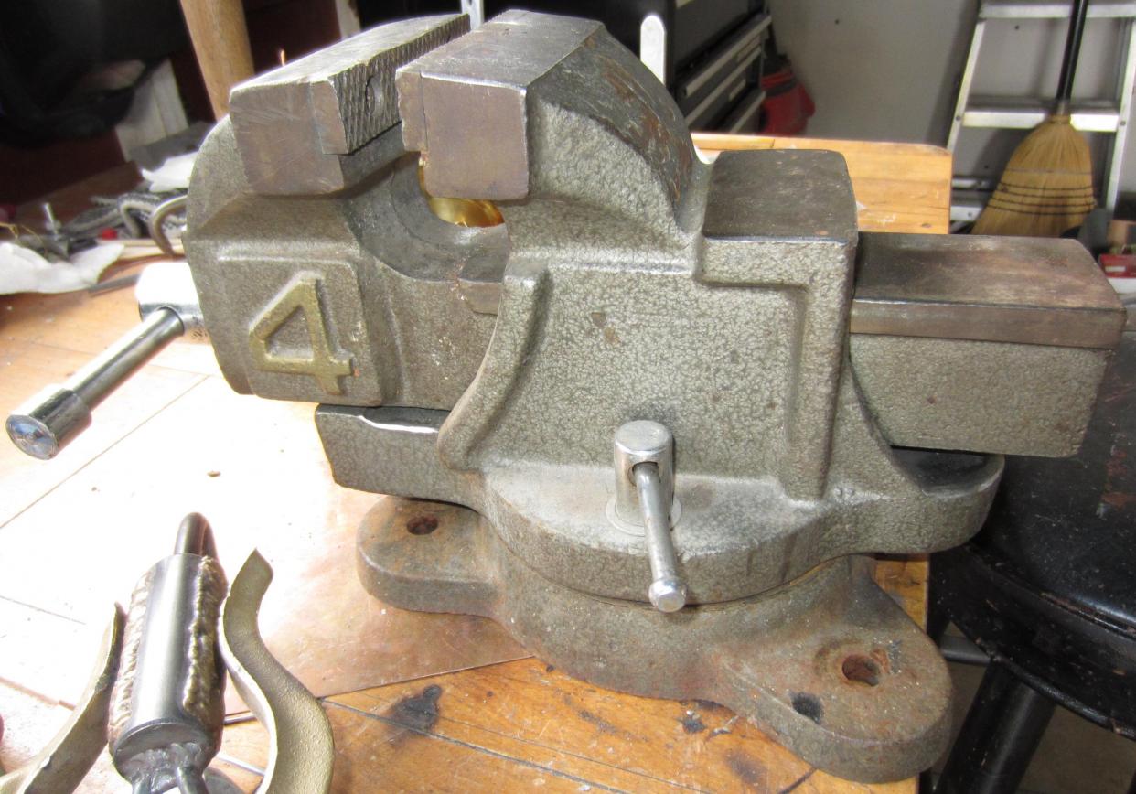

    Hey guys - I picked up this vice in a frozen and abused state. I unfroze it, straightened a rather bent acme screw (for the most part straight), and also really securely seated the forged steel acme nut into the main body (by grinding down its tapered surfaces so they more fully engage the corresponding wedged surfaces inside the cast iron main body.

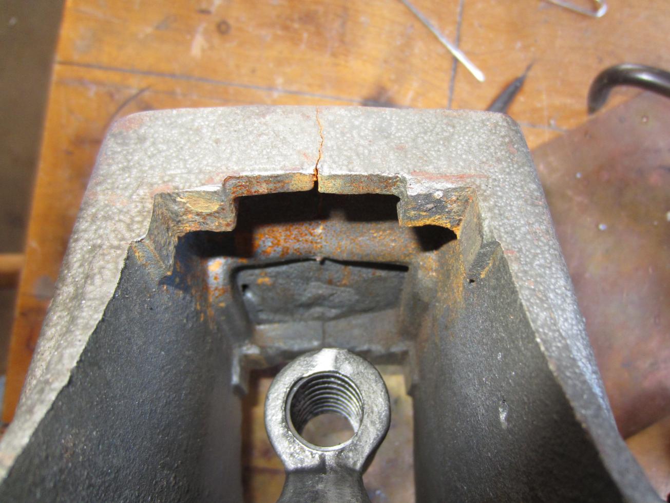

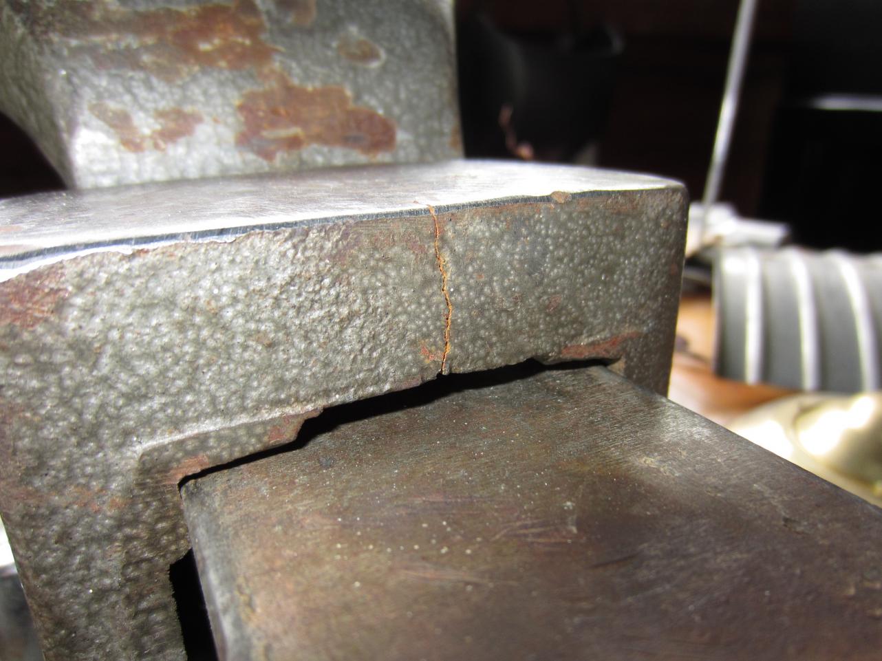

    Now, the vice has good strong clamping power it seems, but its jaws are pretty sloppy, and there is a crack in the back of the main housing (I believe caused when the vice was opened too far, and then jammed closed.) There seems like excessive slop in pretty much all the sliding points, including the opening below the crack.

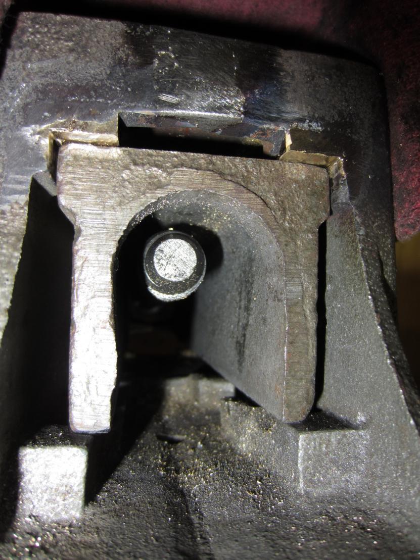

    With some .055" shim and an .065" shims inserted on either side, it eliminated about 1/4 turn of handle rotation to get the vice jaws to clamp. So I think it's be nice to eliminate this play.

    Thanks for the feedback, guys. I ended up using nickel-55 for welding the crack, and aluminum bronze A2 for building up four of the sliding bearing pads:
    Here's how it went...
    The crack was propagating along the casting seam:

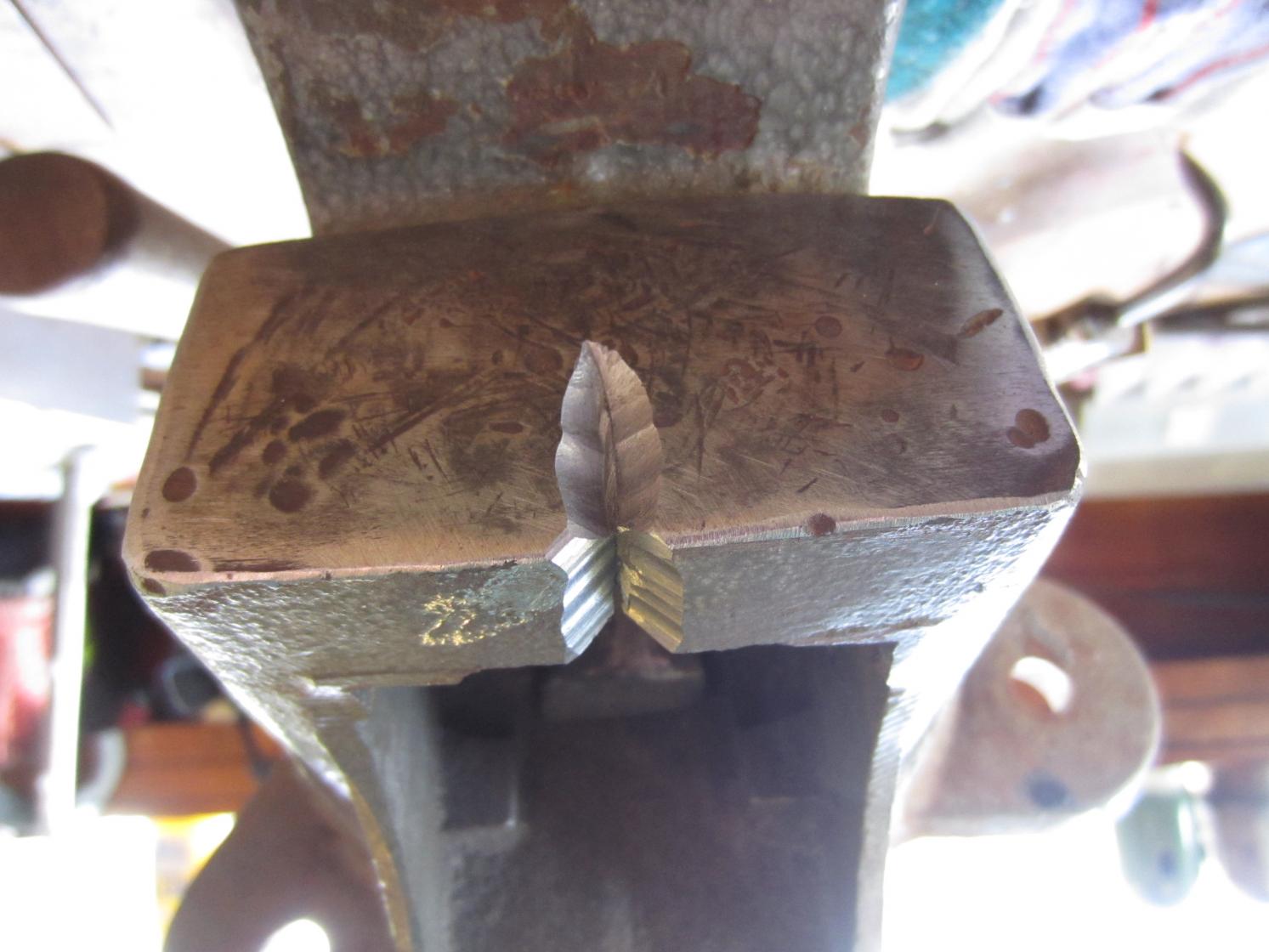

    I started by vee'ing out the crack (and also cleaning some of the other nearby surfaces where I was going to be depositing bronze):

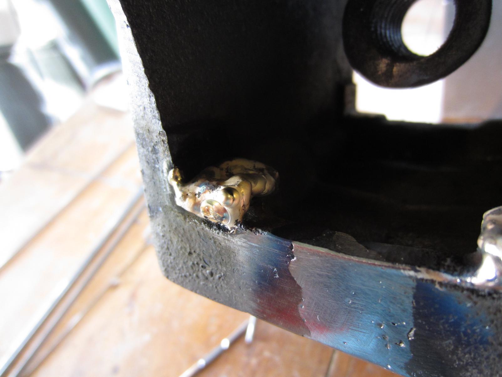

    Then I deposited nickel-55 in the crack; no pre-heat but rather, AC TIG to minimize heat input and keep penetration shallow (got a little bit of porosity here maybe from not prepping the top surfaces adequately):
    Next, I deposited some bronze on four load bearing surfaces / "pads":

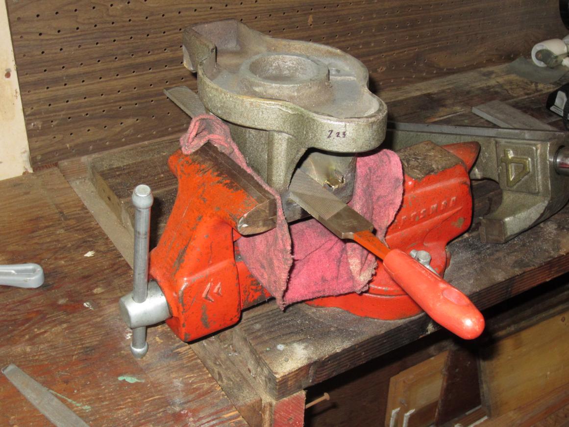

    Next, a big, course flat file was very useful for setting the pad dimensions:
    For big filing jobs, it's helpful to hold your work rigidly. Almost there with the flat file:
    Pad dimensions are tuned to perfection:
    Next, there is still play in the "yaw" direction of the moving jaw, (which I'm thinking I could eliminate by depositing some bronze on one side pad of the main body and filing ...should be easy), and also the jaws could use a little attention.

    That looks like one size XL vise. What tool did you use to vee the crack in post #5, photo #3? It's got a corrugated look to it.
    Hey Dave - I used a carbide burr (a 1/2" diameter cylinder shape with sharp lower corners), held at about a 45 degree angle.
    It was pretty amazing how effortlessly it chewed through this cast iron. Almost as easy and fast as aluminum. I think this is a special kind of cast iron called "ductile iron"
    I'd say this is a medium sized vice. My other one's a little bit bigger.
