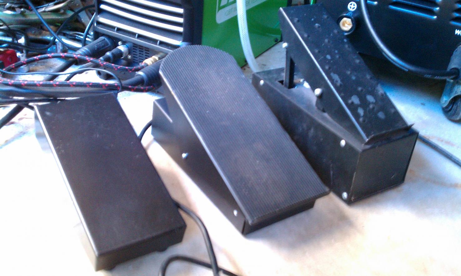

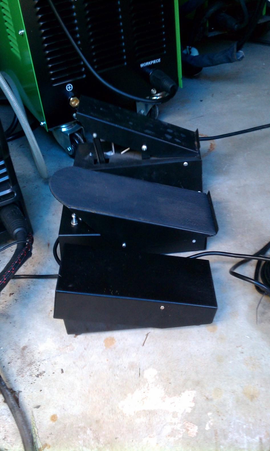

    Not sure if I posted pictures here (not sure if I saved).
    These are the Everlast pedals, no the SSC in there.
    From left the 3.5" (current 210ext pedal), 4.25" for new Everlast low profile model and 8" Everlast standard default pedal on the right.
