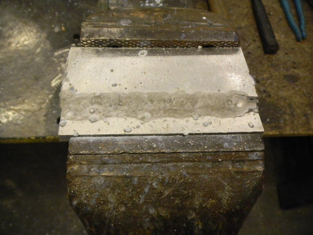

    I did a little playing around with it a few months ago. You gotta move fast! And keep the proper arc length. It is almost like spraying it on. I'll take Tig, then Mig over SMAW of aluminum anyday.

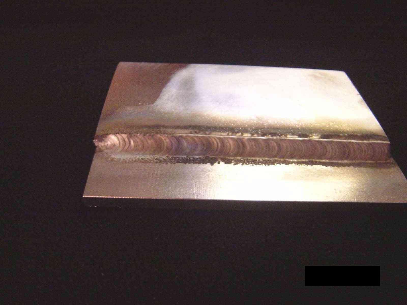

    I did this Tig weld years ago, DCEN with 100% helium.
Name:	100 % Helium.jpg
    Ok, ignore the man behind the curtain...lol.
    It takes real skill to do that...and many would question the practicality because, yes it can be done, but you need 100% He. And perfectly clean metal. He is not cheap, and Arc starts in He are terrible with most welders.

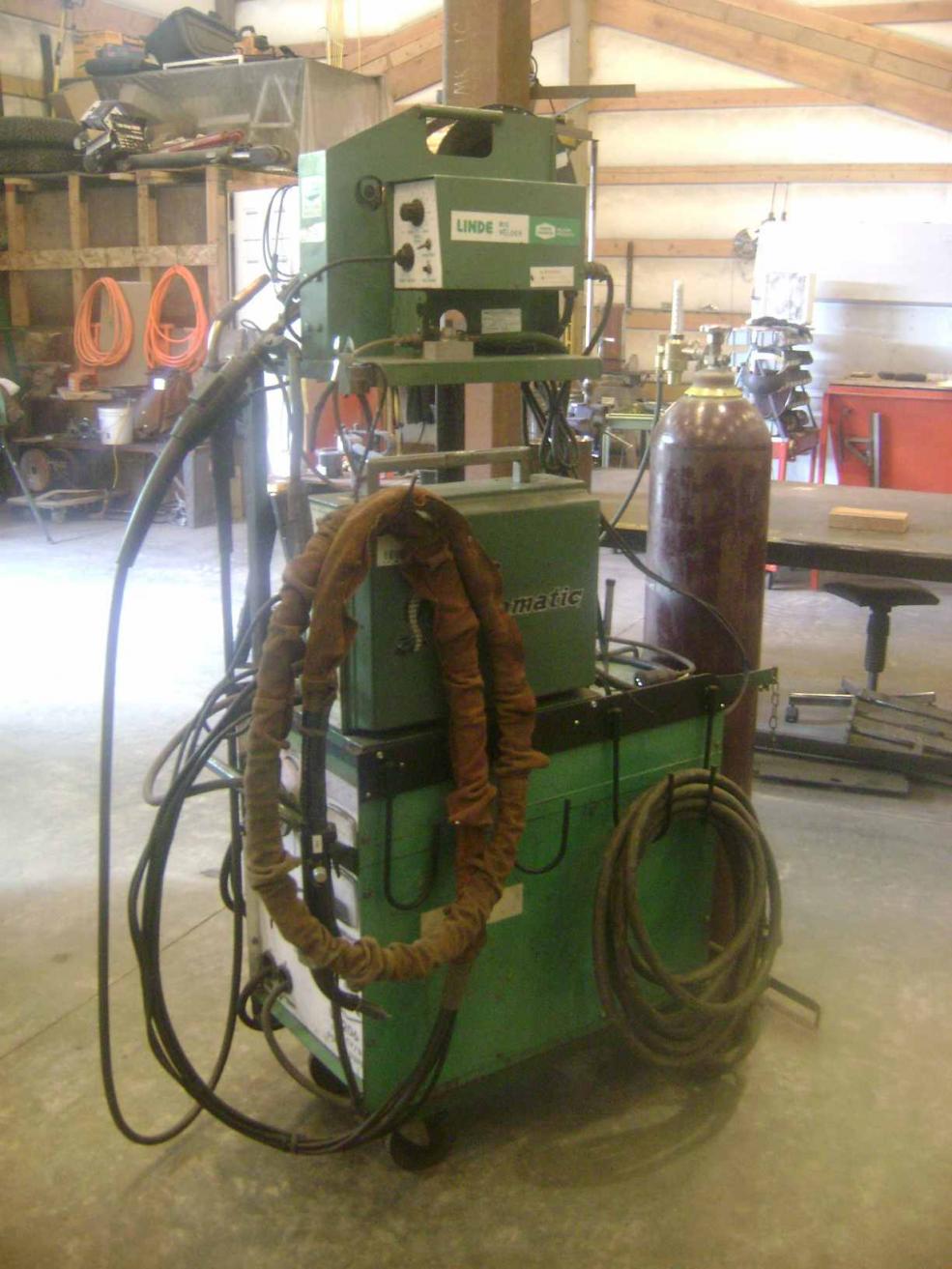

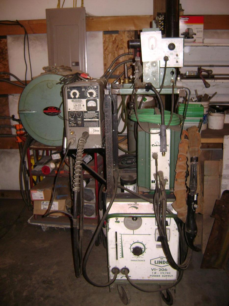

    blacksmith there are a lot of good push pull units on the market. For years I had a Cobramatic, but the gun is not a whole lot lighter than a spool gun, and then when you add the very heavy cables too, it really gets heavy and cumbersome!
    Where people get into trouble is when trying to use a low end Mig welder, without a very short gun, with nylon liner, and proper drive rolls. When it comes to aluminum work, there is just no cheap way to do it!

    By the way the older cobramatic setups still bring a premium on eBay. I have attempted to get a cobra wire feed setup several times $$$.
    that setup is serious business. it almost looks like it could move under its own power.
