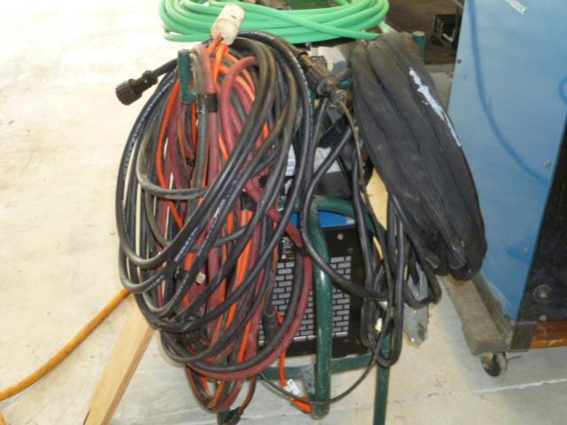

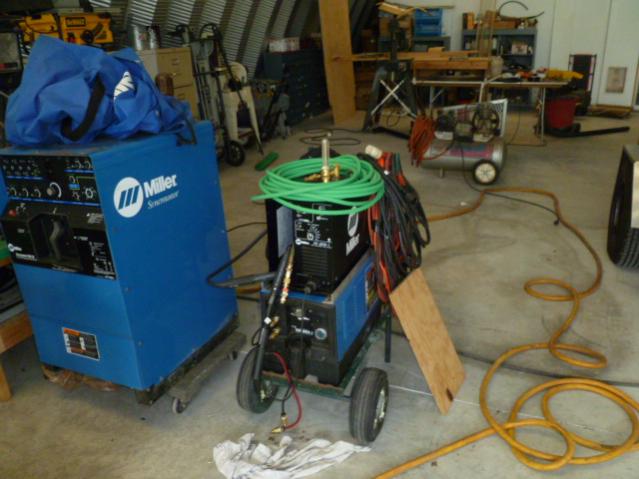

    here's a pic of my trailblazer setup with HF box.Click image for larger version.

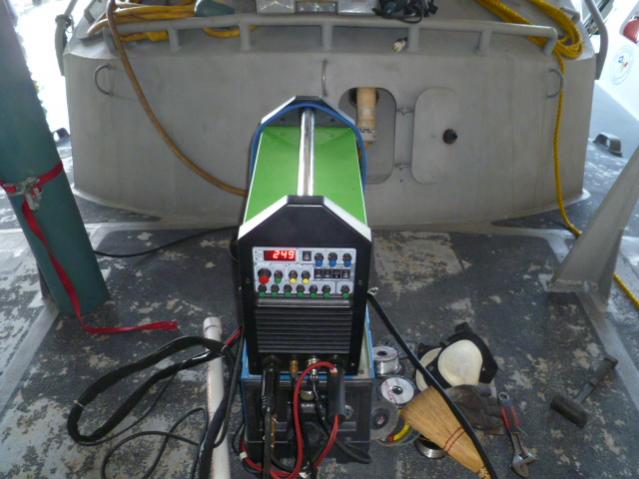

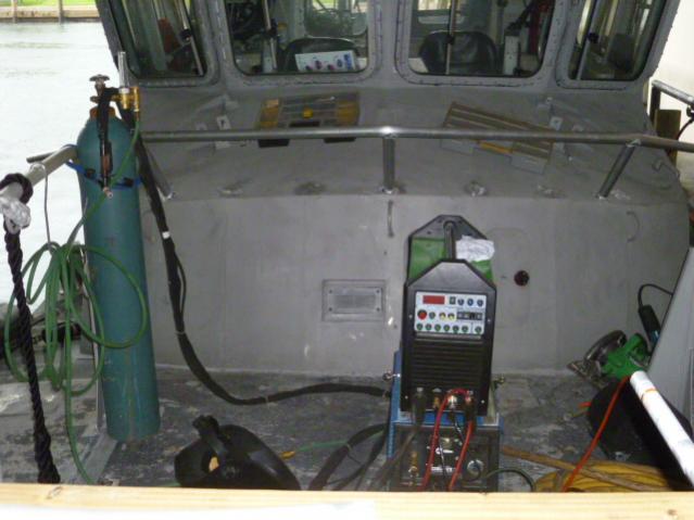

    i bought the ex for portability and easy setup for aluminum welding. check the setup for my trailblazer and i still only get 225 amps out of it. i keep the hi freq around just in case. if the ex can't handle it i pull out the spool gun and a plumber's torch. it's no accident that miller is coming out with a 280 dynasty. people have been waiting over a year for it's release, the only reason they are coming out with it is they know they are losing sales.

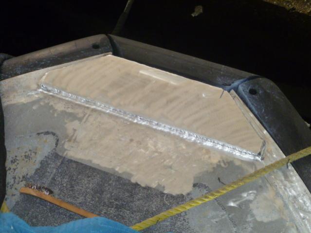

    here's a shot of the ex in action on a boat i have been doing quite a bit of work on. in this case new grip rails.
    when the material gets real thick and the tig is too slow; time for the spool gun.
    man, that last picture is a product seller; oleg needs to kick me a ball cap or something. lol
