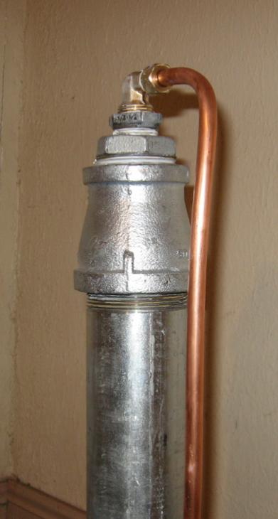

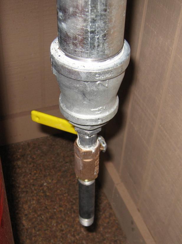

    So dry air is needed. Again, the dryer the better. I did some more research and found an idea that I wanted to try. Its a device you can build called a Franzinator. It is named after a guy who has been tinkering around with the idea for over twenty some years. What it is is a 2 inch x 36 inch pipe with end caps and an inlet, an outlet and a drain. On the 1/2 inch inlet in the center, a 90 degree fitting is welded inside to aim the air towards the bottom of the Franzinator. What it does is cool the air and removes most of the moisture before it gets to your tank. There is a lot of chat on the internet about the Franzinator and how it works so if you want to learn more, Google Franzinator.Click image for larger version.

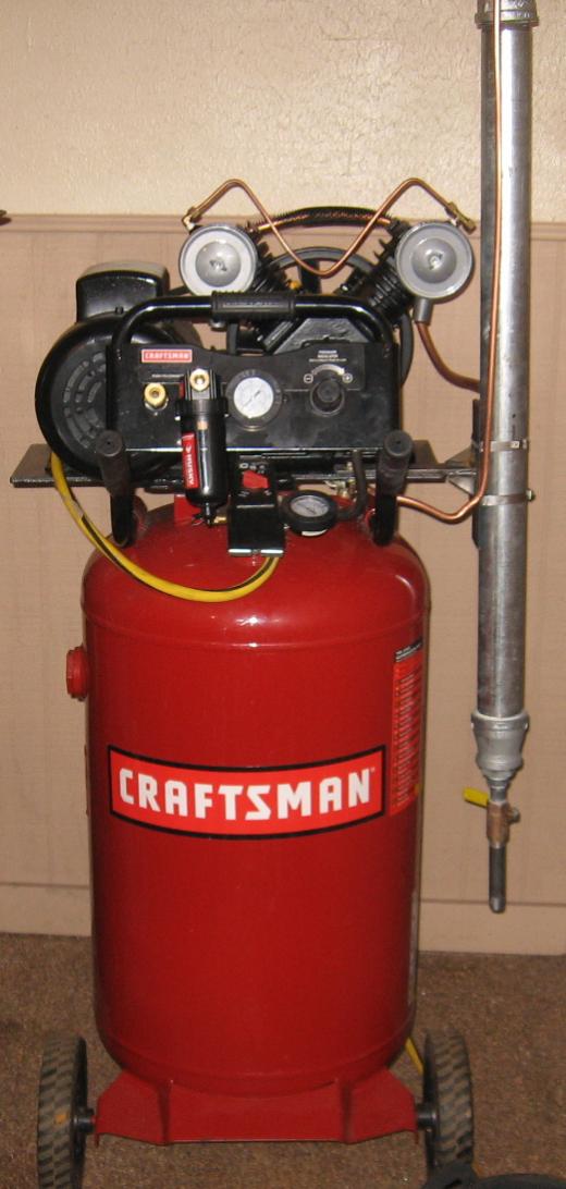

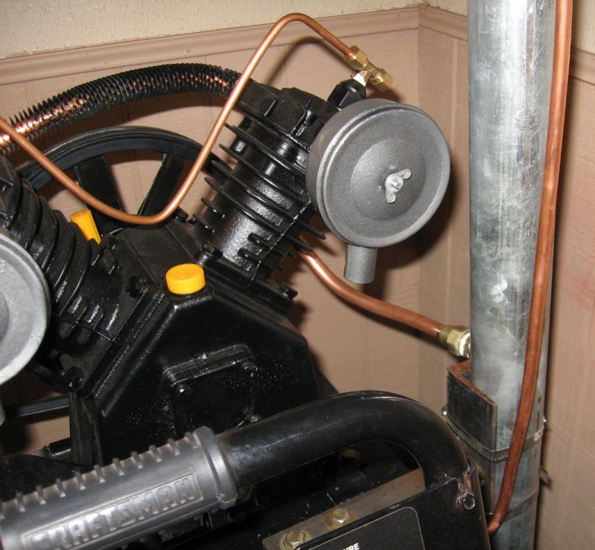

    Does it work? OOOOH YEAH! My cuts with the PowerPlasma 50 are now much smoother and I have seen an increase in the lifespan of my consumables. I still run a filter before my air line and have noticed a huge decrease in the amount of water/oil that the filter gets and almost no water in the main tank. Almost none. The drain on the Franzinator sees a lot of water coming out of it and I cannot be more happy. I get cool dry air that requires almost no maintenance and no purchasing of expensive filters. This may even help the tank on your compressor last longer as there is very little water inside the tank to cause rust which is the number one cause of tank failure.
    If you are looking for an inexpensive way to get rid of that pesky moisture that a compressor produces in the air, this project can save your consumables and make for smoother cuts. All for under a hundred bucks.

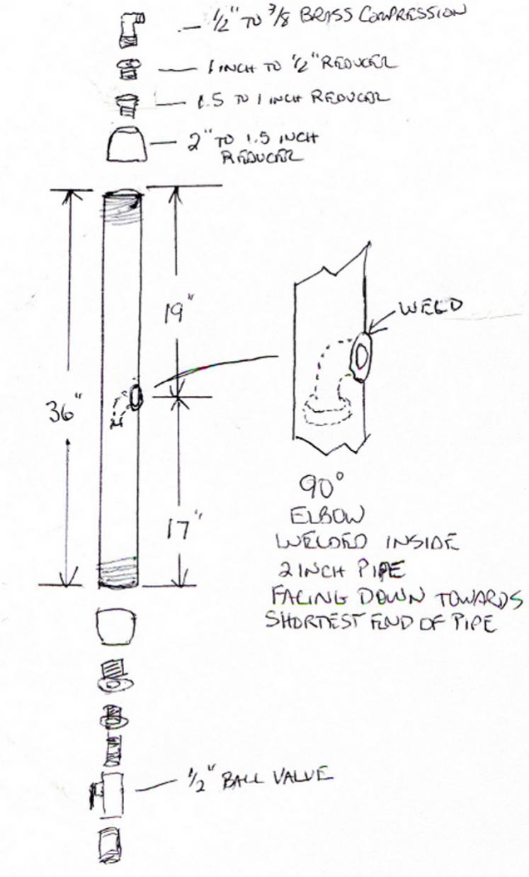

    The one thing that needs to be done is weld a 90 degree elbow inside the 2 inch pipe. Don't tig it as tig is too clean a process. Either MIG, stick or gas weld it in place as those processes can handle the impuries of the pipe and elbow fitting. Remember, this Frazinator is a pressure vessel. The welds need to be good and strong. The air will be bled off when the compressor stops so it is only when the pump is on will pressure be present. Weld the fitting with a nipple in it to protect the threads of the elbow and then remove the nipple. Be careful if you use galvanized pipe as it gives off toxic gas when heated. I will include a drawing of how the thing is built along with a parts list.
    I cannot tell anyone the lengths needed for the
    Parts:
    One 36 inch length of 2 inch schedule 40 pipe with both ends threaded.
    Two 2 inch to 1.5 inch reducer couplings
    Two 1.5 male to 1 inch female reducer couplings
    Two 1 inch male to .5 inch female reducer couplings
    One 90 degree brass compression fitting 1/2 inch male to 3/8 male ( size dependent on the plumbing of your compressor) as that is what fed my compressor. You want to try to keep it at 3/8 inch as forcing air through a smaller opening has a cooling effect on the air.
    My original compressor pump had a 3/8 inch line feeding the tank from the pump. My new pump has a half inch feed. It is best to feed the Franzinator with a half inch line. To feed the tank from the Franzinator a 3/8 inch line is best.
    One half inch male/male compression fitting
    One Half inch commercial grade ball valve female threaded both ends
    Two half inch x 1.5 inch nipples
    One bag of 3/8 inch compression rings
    One bag of 3/8 inch compression nuts
    Two 1/2 inch compression rings and nuts
    How to build it:
    First, take the 36 inch x 2 inch pipe and you will need to drill a hole with a 1.25 inch hole saw at the 19 inch point. The longer end will be the top of the Franzinator. Insert the 90 degree 1/2 inch elbow with one end facing down to the shorter end of the pipe. This is important to point the one end of the elbow down to the shorter end of the two inch pipe. Either MIG, stick or gas weld the elbow in place while having a short nipple in the elbow to protect the threads from splatter and damage. Remember, this is going to be a pressure vessel so make sure your welds are good and strong. I used magnets to hold the elbow in place to tack welded it. Removed the magnets and then I finished up the weld. Tig welding will not be a good choice to weld this. Again, either iron or galvanized pipe has lots of impurities and makes tigging a rough road to hoe.
    Now it is time to add the various reducer couplings from largest to smallest. See previous post photos. Use pipe thread tape as pipe putty will be exposed to water and will degrade. Use pipe tape ONLY or it will leak!
    The 90 degree 3/8 inch compression fitting is next at the top and then at the bottom ( the shorter end where the elbow was welded) install one 1.5 inch nipple with the commercial grade ball valve and then another length of 1.5 inch half inch nipple for the drain.
    Plumbing will be different from compressor to compressor. Mounting can be done on the wall or on the compressor depending on your circumstances. Lengths of tubing will be dependent on the position of the Franzinator.
    Don't try to improve upon it by making it bigger as bigger is not always better according to Franz. Follow what the design states and it will work. For larger compressors, you may need to have two in series to get the air dry.
    Pardon my crude drawing but here is what the dimensions are and how to put it together.Click image for larger version.

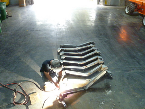

    i have built, without exaggeration, over 1500 of these boat saddles over the past five years. the clips and angle iron that contain the wood are of HOT DIPPED galvanized. big difference between hot dipped and zinc coated. i have suffered no ill effects at all. galvanized is welded every day of the year down here. it is very common around salt water. it appears that you guys that live inland have the biggest problem with it. position yourself correctly, don't work in confined space without exhaust, get a fan!!
    in the first photo i am using a carbon arc setup to remove old weld from saddles.
    after i finish this post i am headed to the gym, i will be doing forty to fortyfive minutes of cardio on a cross trainer at level 42, same as i was five years ago. i am in my sixties.
    i mention this only to illustrate that it can be done with no deleterious effects if you simply take minimal precautions. seriously, you wouldn't suck exhaust from a car, would you?
    i have visions of some of you guys going to work in space suits.
    that frazinator is interesting i am thinking of adding one to the compressor i use in the field.
