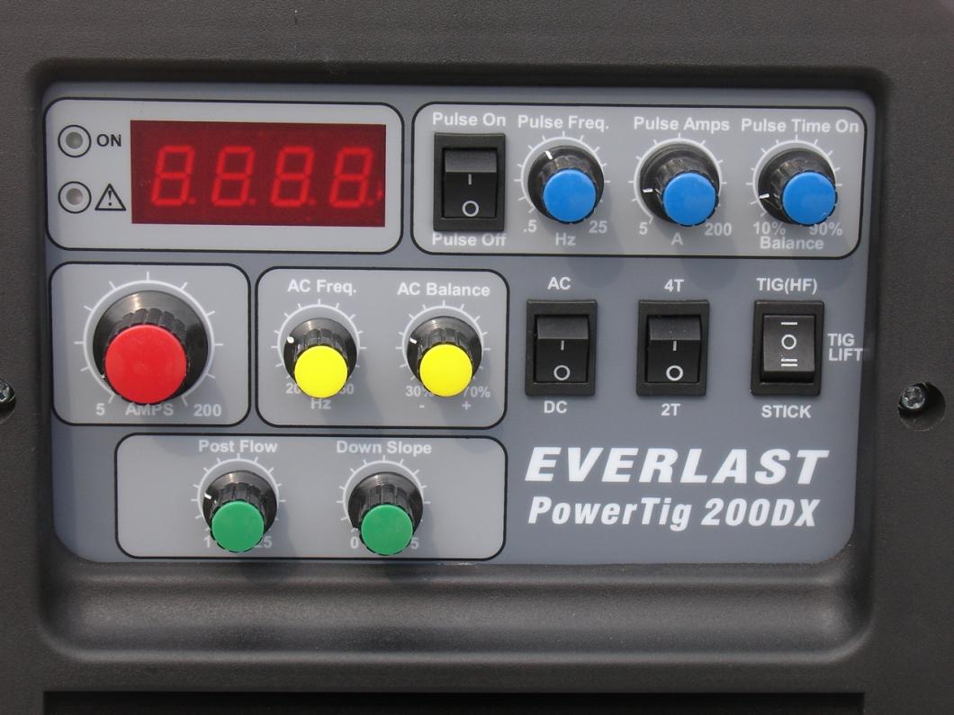

    I am close to purchasing the 200DX model. I was looking at the manual posted online and the photos do not match up to the photos that are posted on eBay from Everlast. The photos on the website look like they are the 2009 model.
    The three main questions that I have are:
    1) What is the AC Freq range on the new model? The photo has the knob blocking the high number. 20hz-???hz
    2) Is TIG Lift a new feature on the new 200DX's?
    3) When you get the new 200DX's in stock, will they be the 2010 models as shown in the attached photo or will they be old stock?
    Thanks!
    I'd buy one directly from the web site or a dealer if there is one near you. However, the frequency is 250 hz and yes, the Lift tig is a new feature. You still have HF start. The units are essentially the same in function though.
    We don't have any old stock on any units that I am aware of except the PowerPlasma 100's and PowerPlasma 60 E's which have not changed in their styling, since they are seriously commercial duty.
