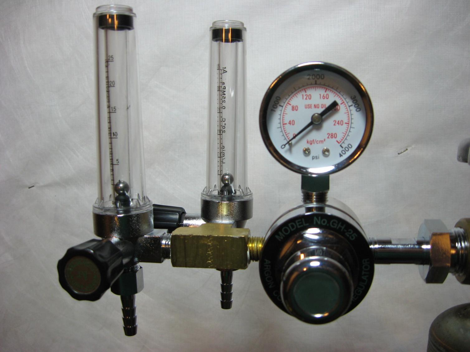

    Here's my simple solution. Click image for larger version.

    He just wondering a little about this setup. Are the fittings 1/4 npt or 1/8 npt. Also did you buy a tee for high pressure rating or is that not needed?

    That tee is 1/4"NPT and since it's after the regulator the pressure is low (under 100 psi).
    It's as Rambozo said. If you make one of these be careful not to overtighten the fitting going into the regulator, too much force could crack it.

    Hey where did you get those little regulators on the left from ? I need to back purge and this would be a quick way for me to get a set up.
    Quote Originally Posted by Vinhtec View Post
    It's the standard regulator/flow meter that comes with the welder Click image for larger version.

ID:	8219 plus a tee, a 1/4" npt close nipple and the flow meter from another everlast regulator.
