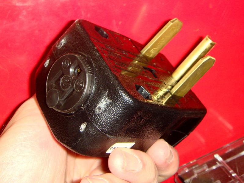

    Hello guys, I recently just purchased a 185 Micro. I wired in a male 30 amp plug to the welder, and I went to plug it in to the outlet that my dryer uses, and low and behold it uses a different style plug.
    The plug my dryer outlet uses:
    The plug that I wired on to my welder:
    I have a 30 amp extension cord that I'm not using (has the same male plug that I wired into my welder), could I get a dryer outlet pigtail and wire it in to my extension cord to make this work?
    Any other thoughts?
    You could make a short adapter with a male dryer plug and female welder outlet , But the easiest thing to do would be to wire another outlet to that box with the matching female plug on it. Just don't try to use both outlets at the same time.

    Just so you are aware, the plug you show for your welder is a 30 amp 125 volt plug NOT 240 volt. While it will work fine and you might want to use it because you have a big cord with those ends, be careful that you don't plug an RV into that (it's an RV plug). I would NOT wire an extra outlet with that plug to 240 volt or put that plug on your dryer. If anything make an adapter so it will only get used for your welder.

    I did just notice that your machine is a dual voltage model, so technically that plug is fine for 30 amps at 120 volts. You will always have something funny with a dual voltage model, but keep that at the welder and do not have outlets wired incorrectly. If you will always power it from 240 volt, then put a 240 volt plug on it. If you are going to go back and forth between 120 and 240, you will need some kind of adapter to avoid switching plugs.
    This unit is actually a 220 unit only. A NEMA 6-50 is the standard welder plug. There are any number, but the best thing to do is just make up a heavy enough extension. But we need to know how far you are running it? The plugs and receps are available at Home Depot or lowe's for the standard welder plug. What you need for the receptacle you have is a NEMA 10-30 dual voltage plug. I have used this site for a reference more than once....for those oddballs. http://www.stayonline.com/reference-...ght-blade.aspx

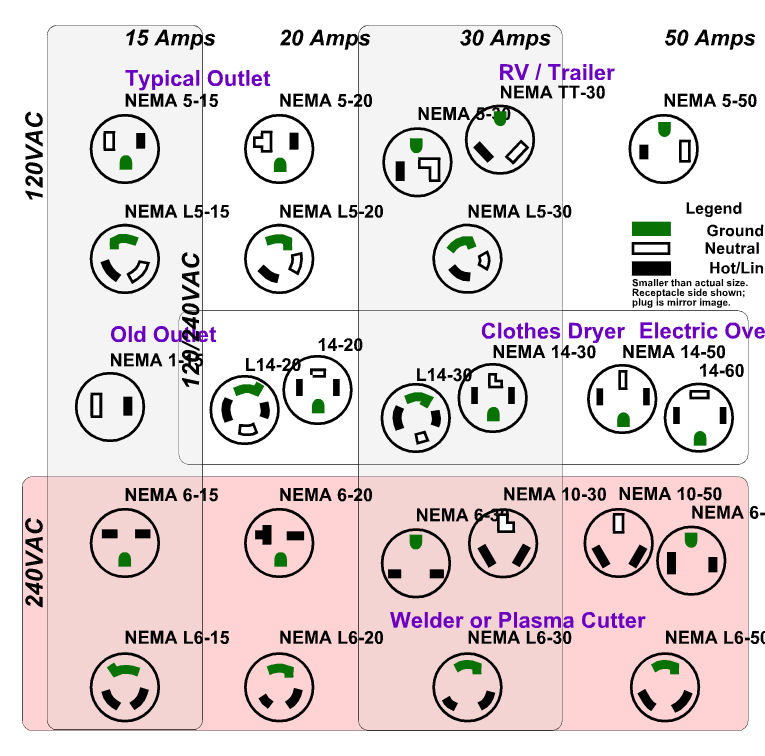

    Sure? Looks like a Nema 10-30 to me.

    Look again. His dryer plug is a NEMA 10-30, but the plug he put on his welder is a NEMA TT-30
