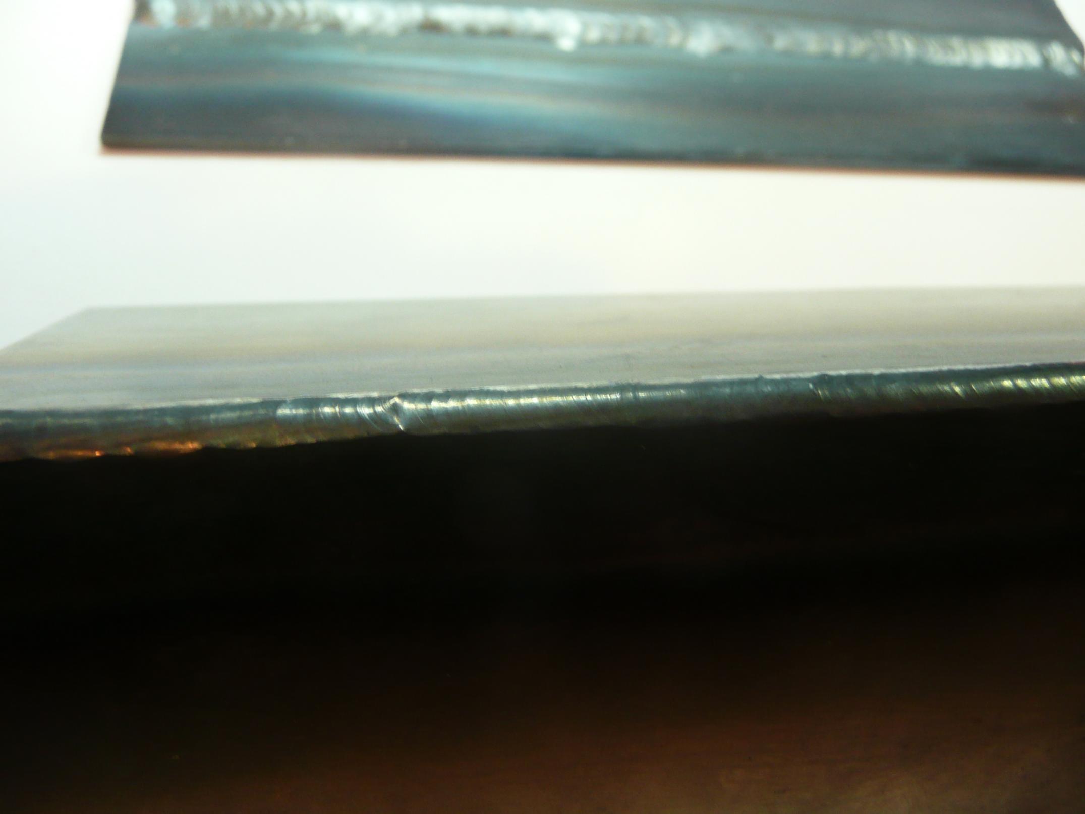

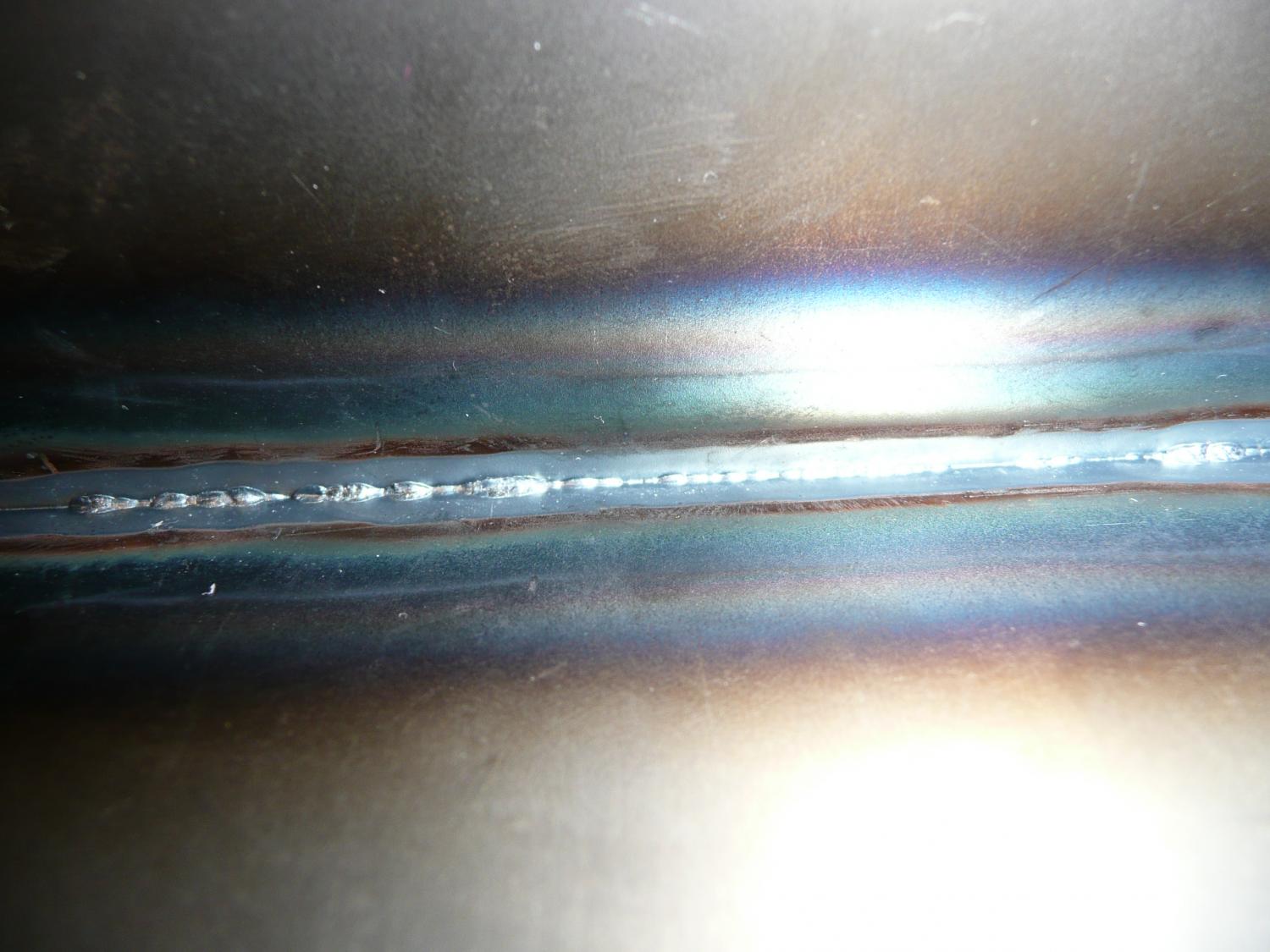

    Finally got my TIG class going- We are learning to do welds first in mild steel, then we progress to stainless Steel, And finally aluminum with 4 basic plate designs- Corner Joint, Lap weld,Butt weld, and T joint-
    My first one is merely fused with no filler-16Ga Mild steel Lincoln Precision TIG 225- set current to 90 but only use around 1/2 pedal: Click image for larger version.

ID:	8025And a shot of the backside.

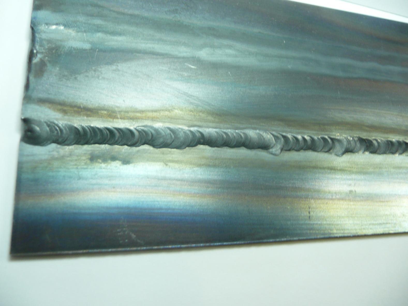

    Here are a couple of my "Lap Joint" attempts-16ga Mild steel, 1/16" ER70S-2 filler rod, 90 amps with about 1/2 pedal argon on about 5-10 seconds post flow. What do you guys think?Click image for larger version.

    Looks like a little undercutting on the right, but hard to tell from the pics, the flash washes a lot of detail out. Maybe try to concentrate a little more of the heat into the bottom piece. The edge piece needs a lot less than the other piece. Overall looks pretty good. Do they have you cut them up to see the cross section afterwards?
    I am working no my technique and its not easy! keeping the torch at the right angle/speed/heat/height and all the while dipping the filler in the puddle without contaminating the tungsten! I love it! They do not cut them up to look for penatration but I am getting just a hint of a HAZ and where it looks like it almost ready to come through

    HAZ isn't visible to the naked eye. Color change doesn't necessarily indicate the length or extent of the HAZ. The HAZ is found in the microstructure of the metal, and changes the microcystalline formations of the metal.
