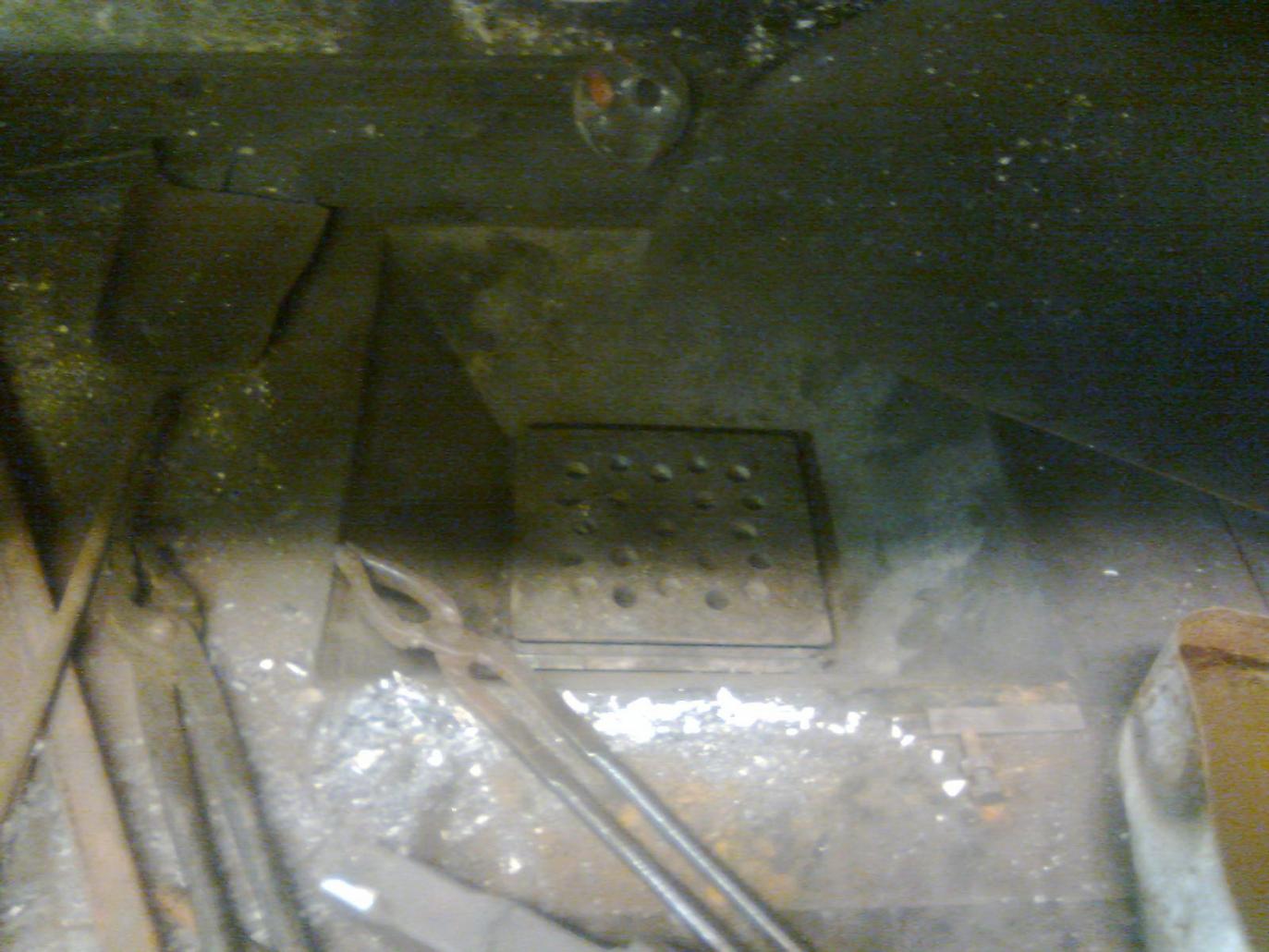

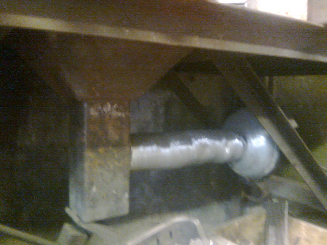

    I need to make time to build one too.
    Ruslan, did you build your own forge? If so, could we see some pictures sometime? спасибо

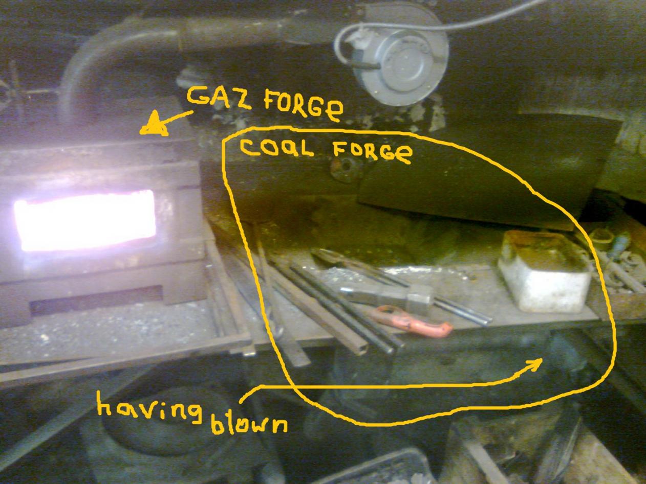

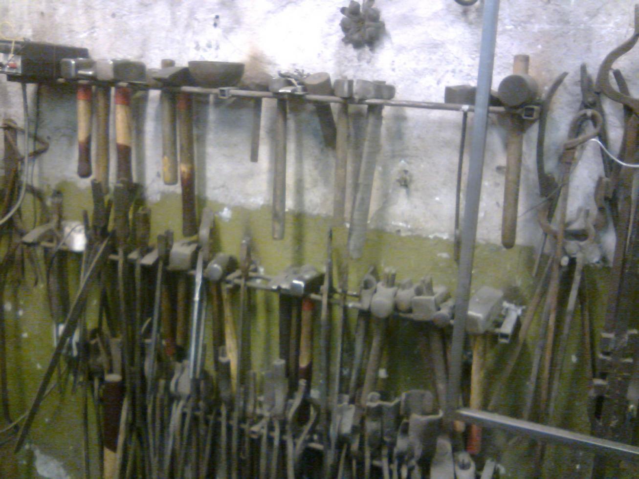

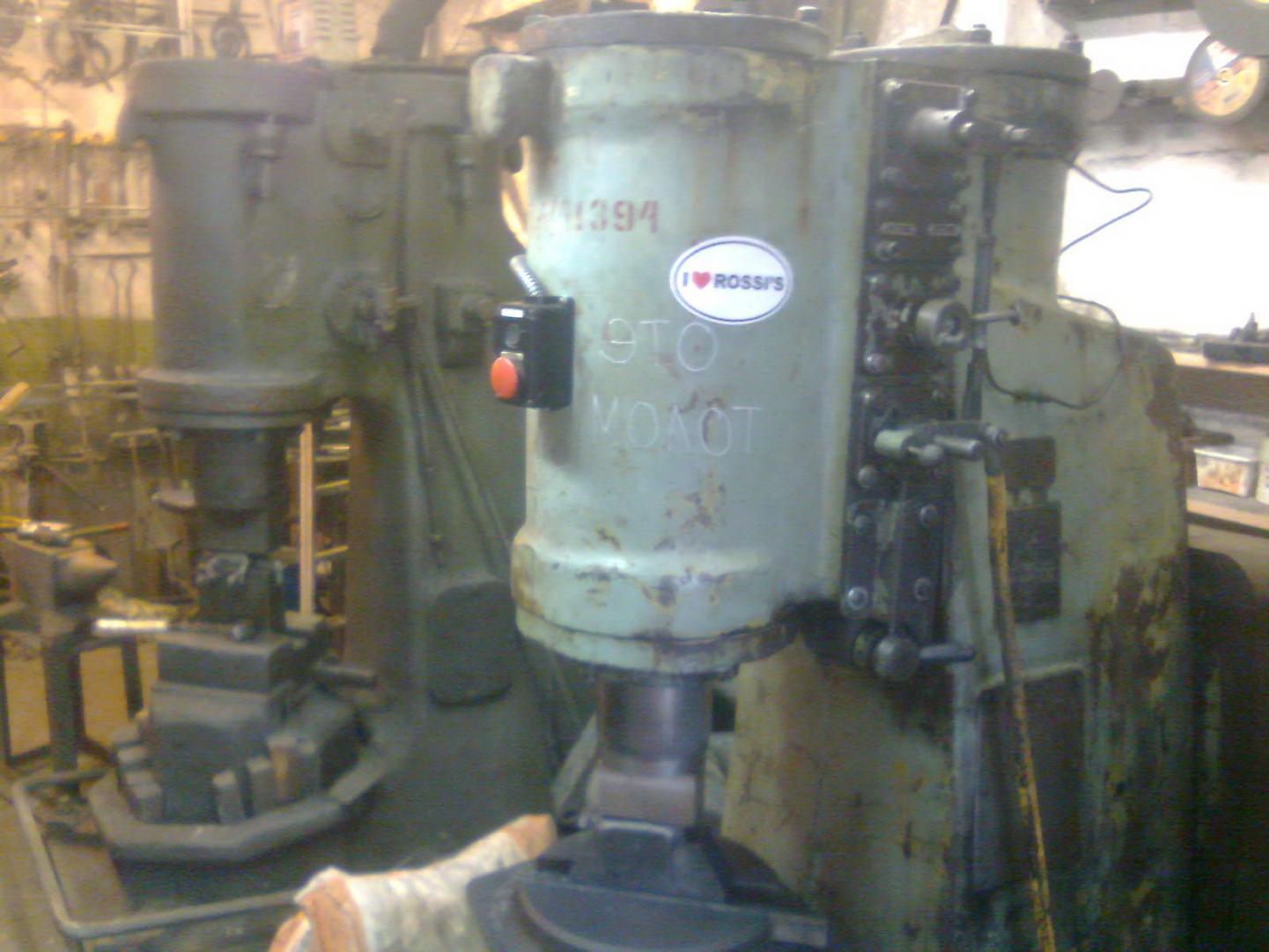

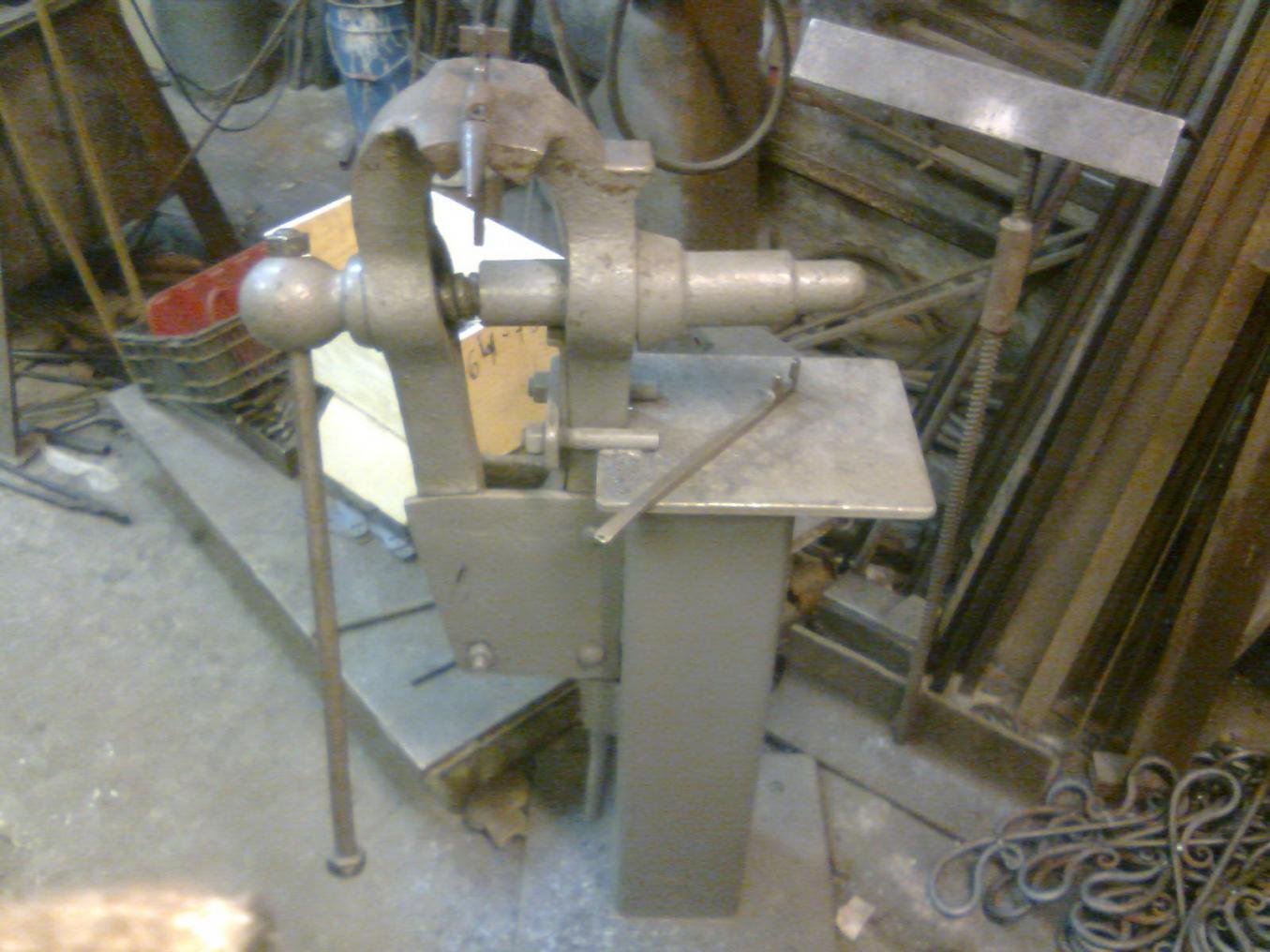

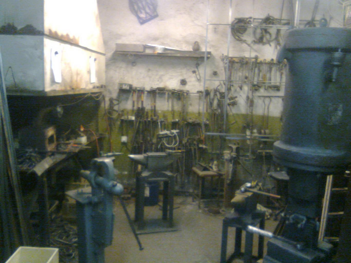

    I moved recently to this room, it is a little less than pregoing so excuse for a brothel (but is closer to the main workshop), forces sufficed while only on moving, to spread out things in places there is no time. at present the smithy looks here soClick image for larger version.

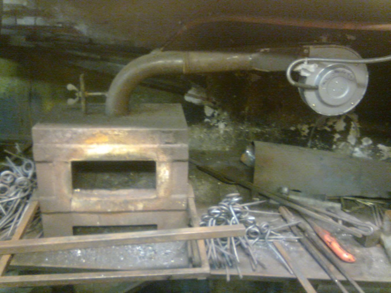

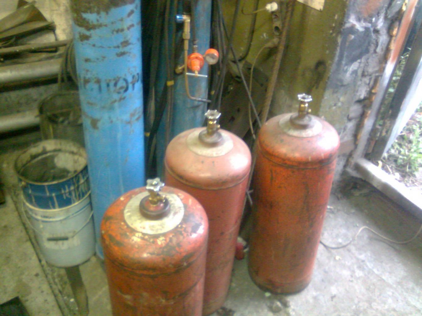

    What gas do you use? How big a tank and how long can it fire or attached to heating system on the shop?.
    I use propane in in cylinders on 50 liters (the biggest cylinders at us of Russia ) one cylinder suffices very much on longClick image for larger version.

    I will wait for someone to post a DIY oven with a BBQ propane tank and make a small one. Those are good sized tanks. The Russia leader do not want you to have too big a tank for a reason hahaha.
    Thanks for the info.

    Very nice. Is the blower motor variable in speed to get the right flow or just designed for the oven. And do you really need all those hammers I would kill for that anvil, but it must be a pain when you have to move your shop, talk about heavy metal..
    Mike, on both forge stand blower motor with adjustment of supply of air (motors are connected through a dimer)it allows to adjust a flame of a gas burner

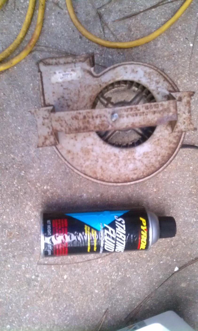

    I have an AC dimmer and found this last night. Maybe a forge in my future. Hope household propane will get me started. Here in the little fan, but it drags so I have to see if I can get it working
    He believes in the saying; "Don't force it... get a bigger hammer!"
    Very nice setup. But the real magic isn't the tools, but the artist who wields them.
    That looks like it might be the speed control box on the end of the upper hammer rack. A mix of old and new tech.

    If you are using an AC blower motor you can use a light dimmer to control the speed of the blower. I do this on my aluminum furnace works very well. If your motor is a Cap start type you cannot use a dimmer on those.

    That's the plan for mine. Motor found, dimmer found. Just need a brake drum, pipe and coal.
