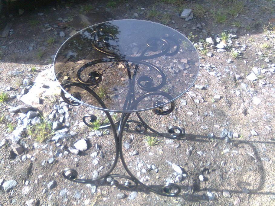

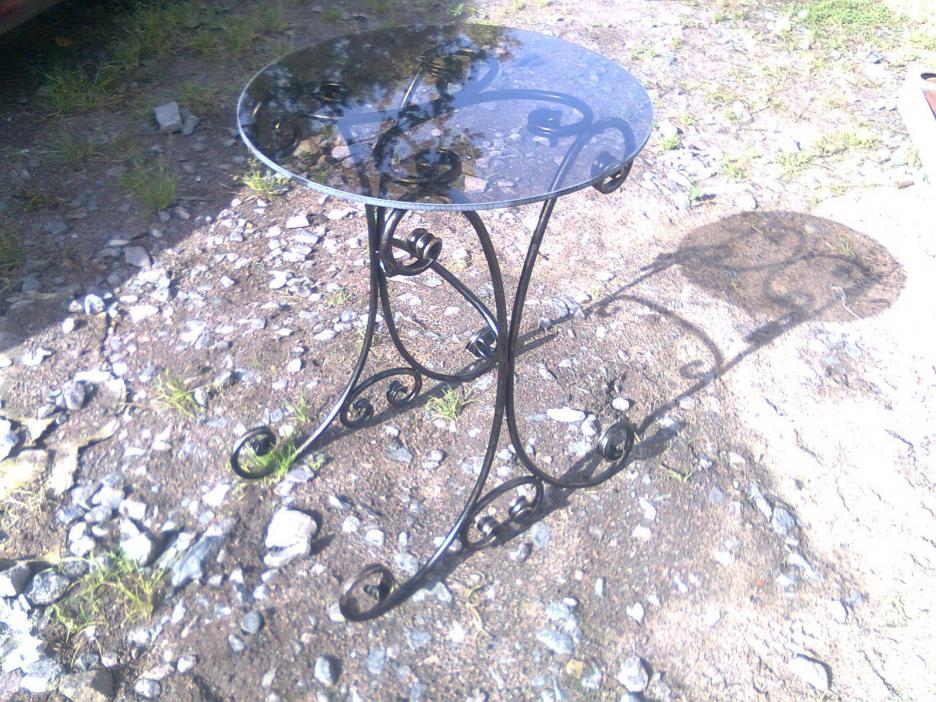

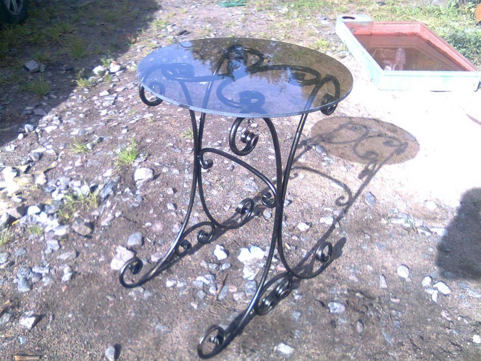

    built yesterday,glass (diameter 500 mm thickness 8mm)

    Beautiful table! Always nice to see your creations. Cheers!

    For a customer, friend or you? What did the glass set you back? Looks like a tinted safety glass. Looks nice as usual, but I think the miniatures might be your new calling
    Very cool! Makes me think I need to add a scroller to my shop ... do you think one of the Harbor Freight jobs would be worth the money?

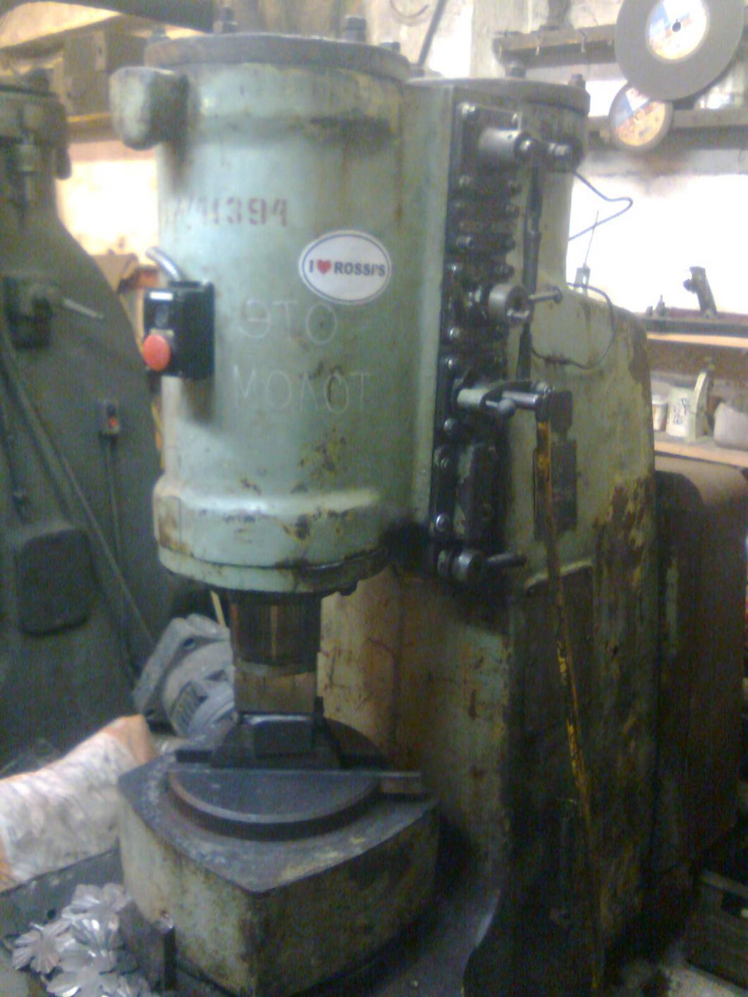

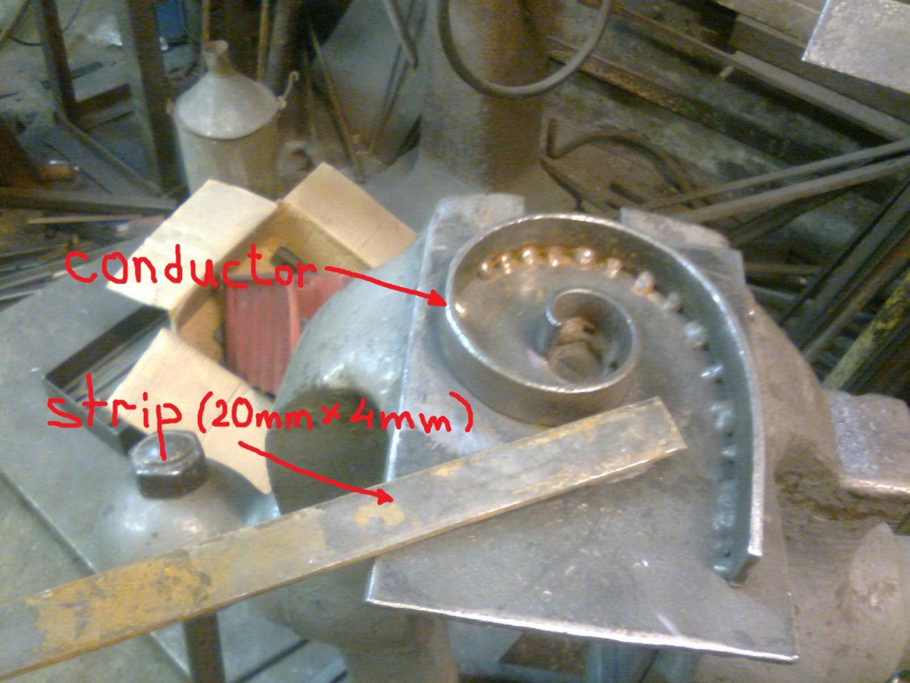

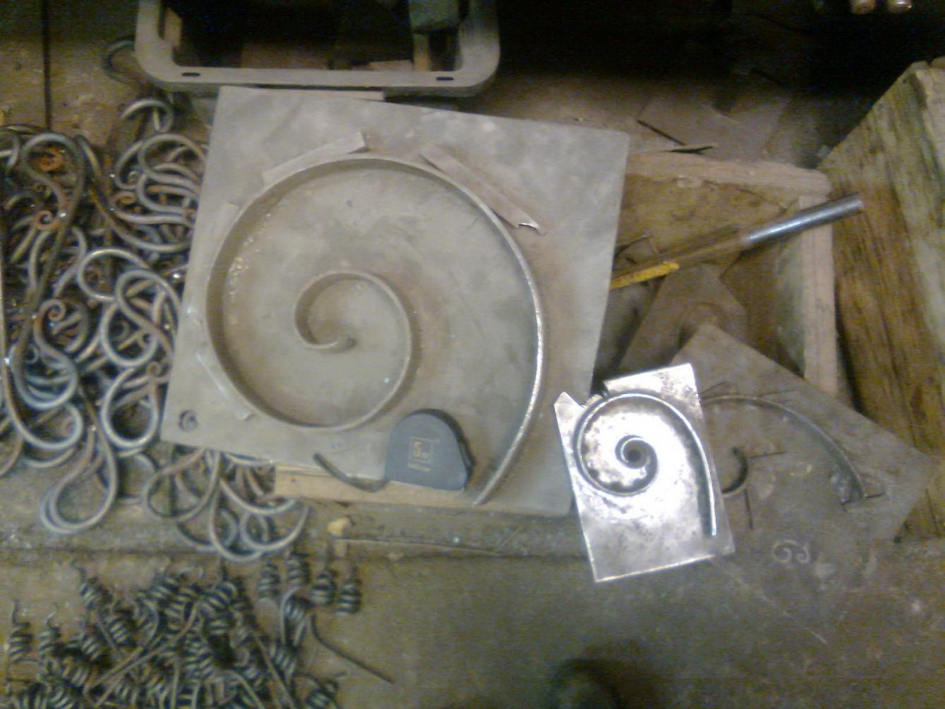

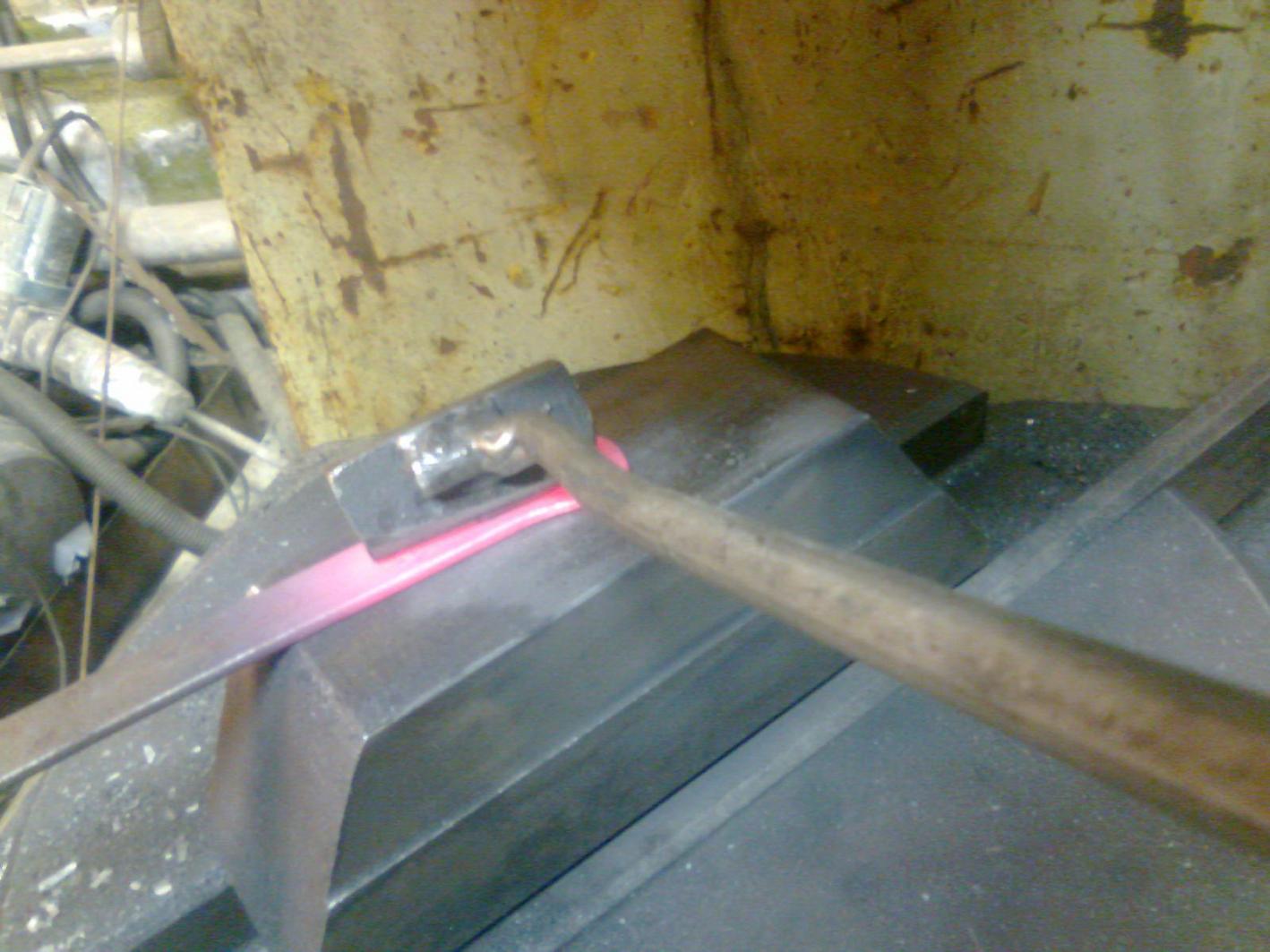

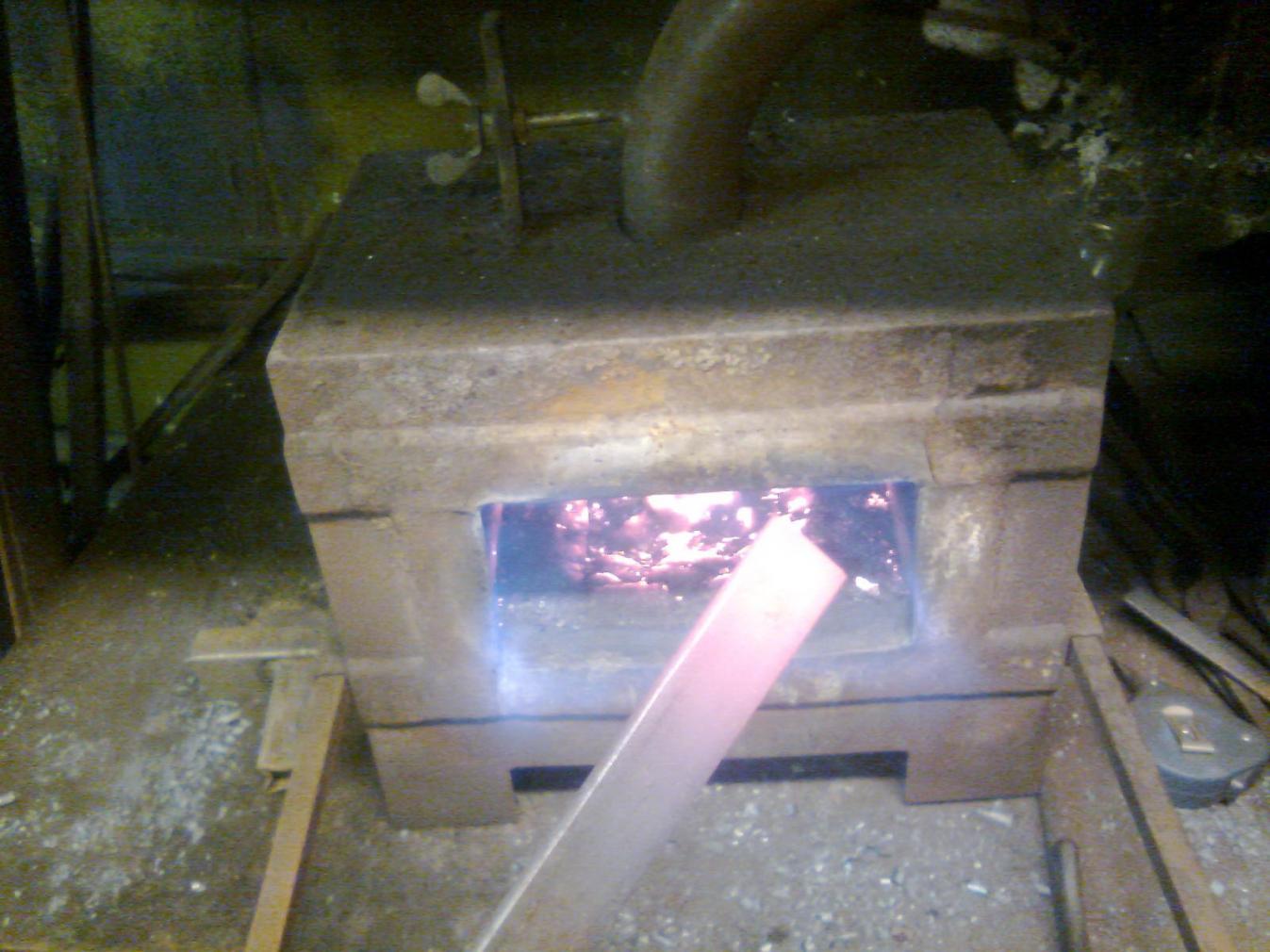

    Now I understood what was being said and what to ask Daveо
    scroll,as you call it is made by hand, ( needed for manufacturing- gas forge, anvil, power hammer,blacksmith)
    if scrolls to do not very much, then everything is forged by hand, and if you need to produce a lot of scrolls, then built on the conductor which is faster and more accurately you can do scrolls.
    if you are very interested, I can tighten, and take pictures of my conductors, and perhaps the process of manufacturing a scroll.

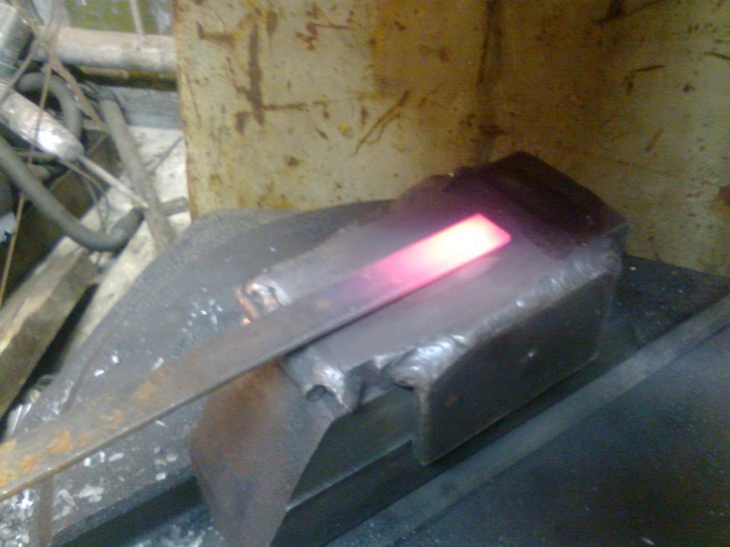

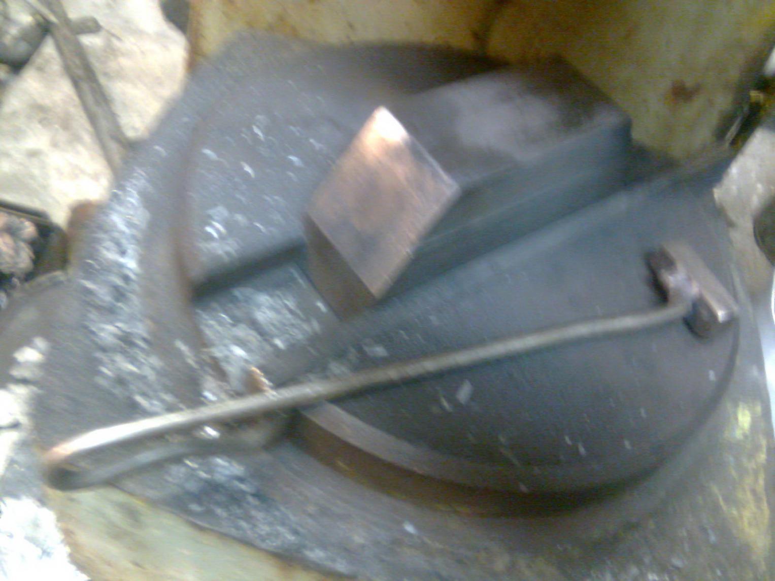

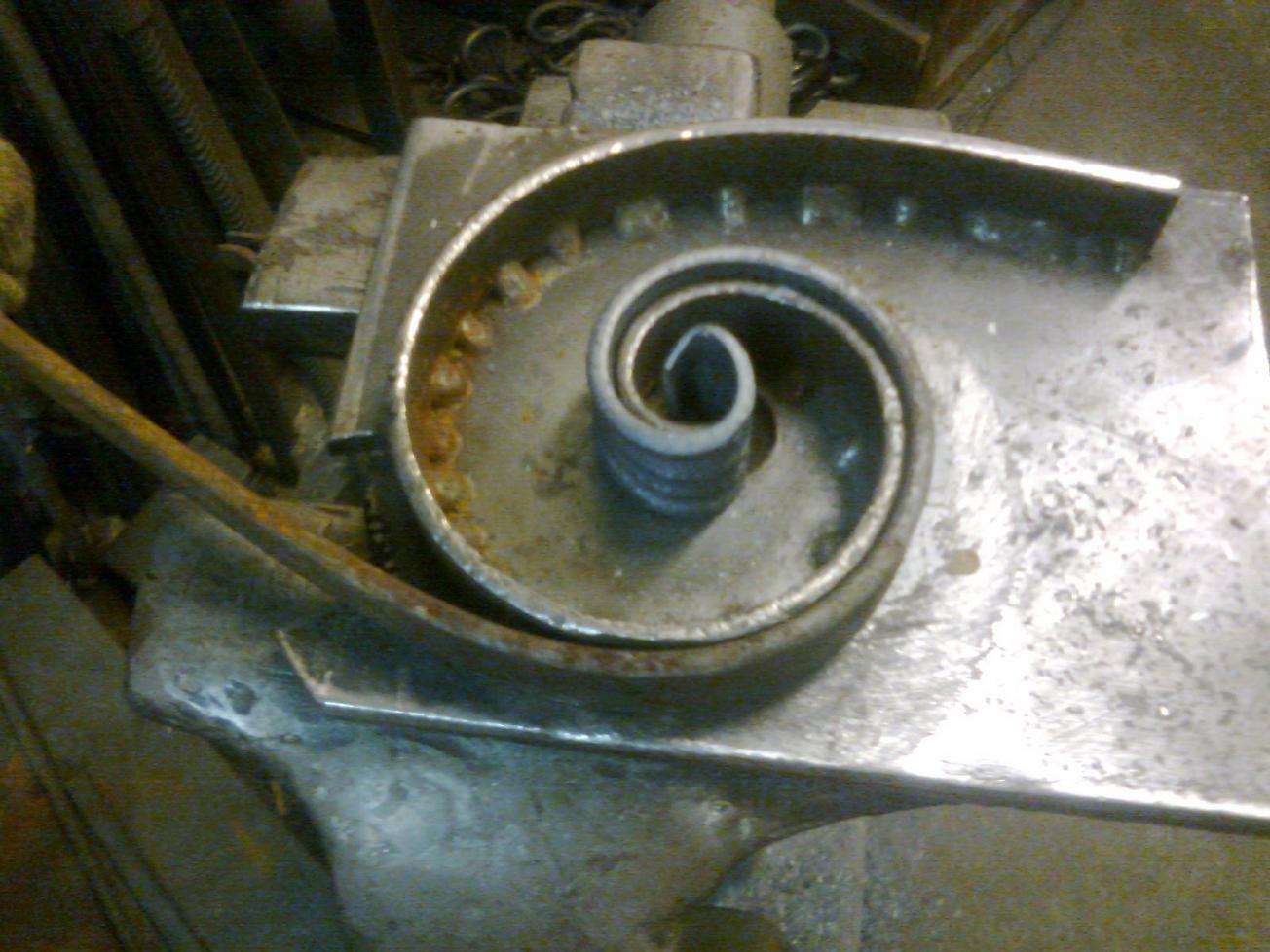

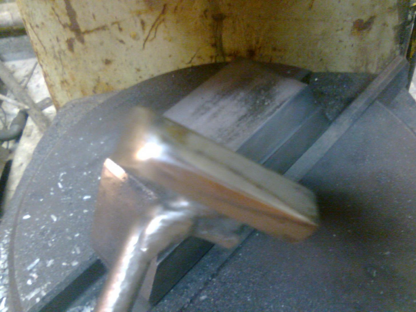

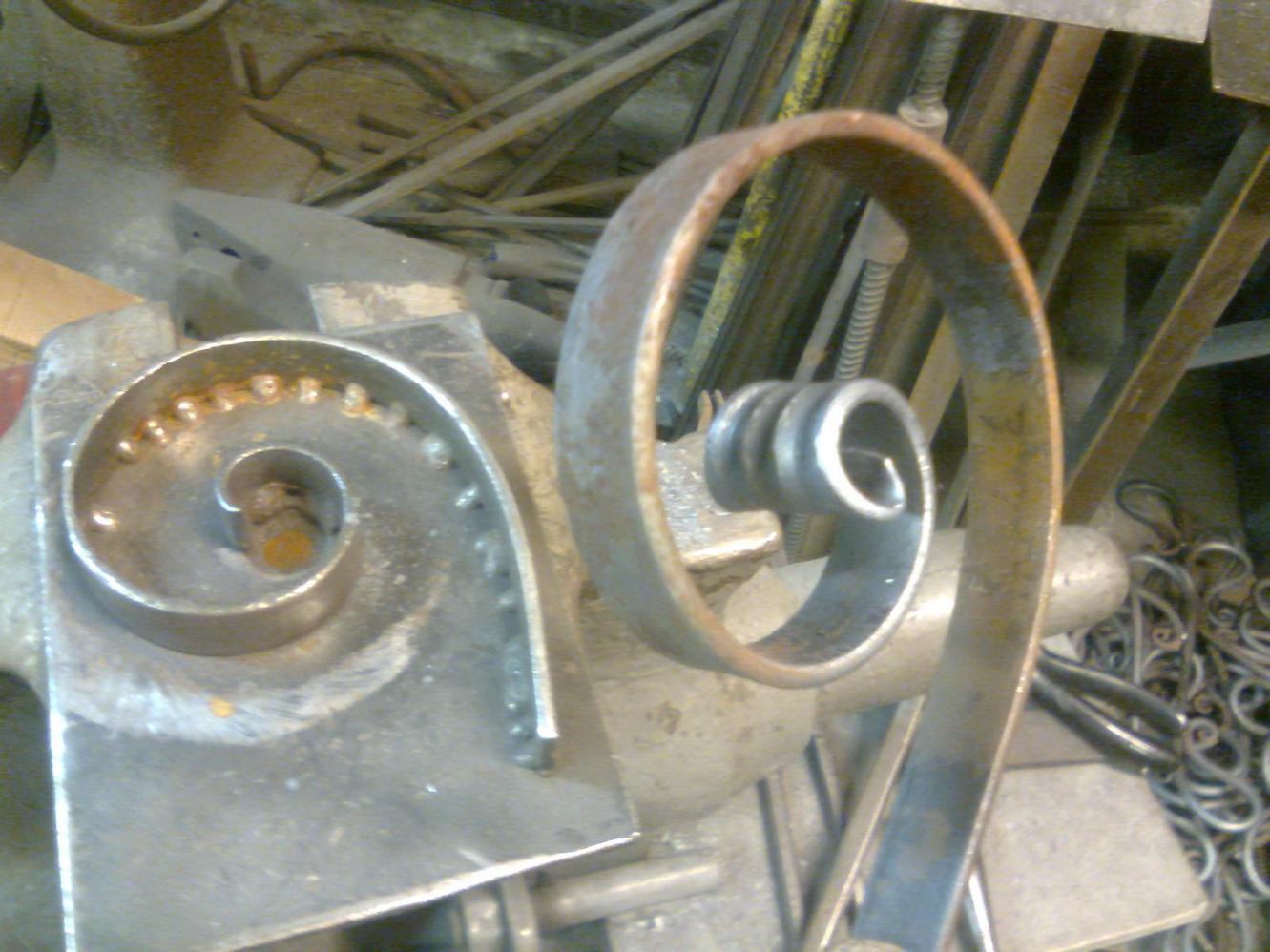

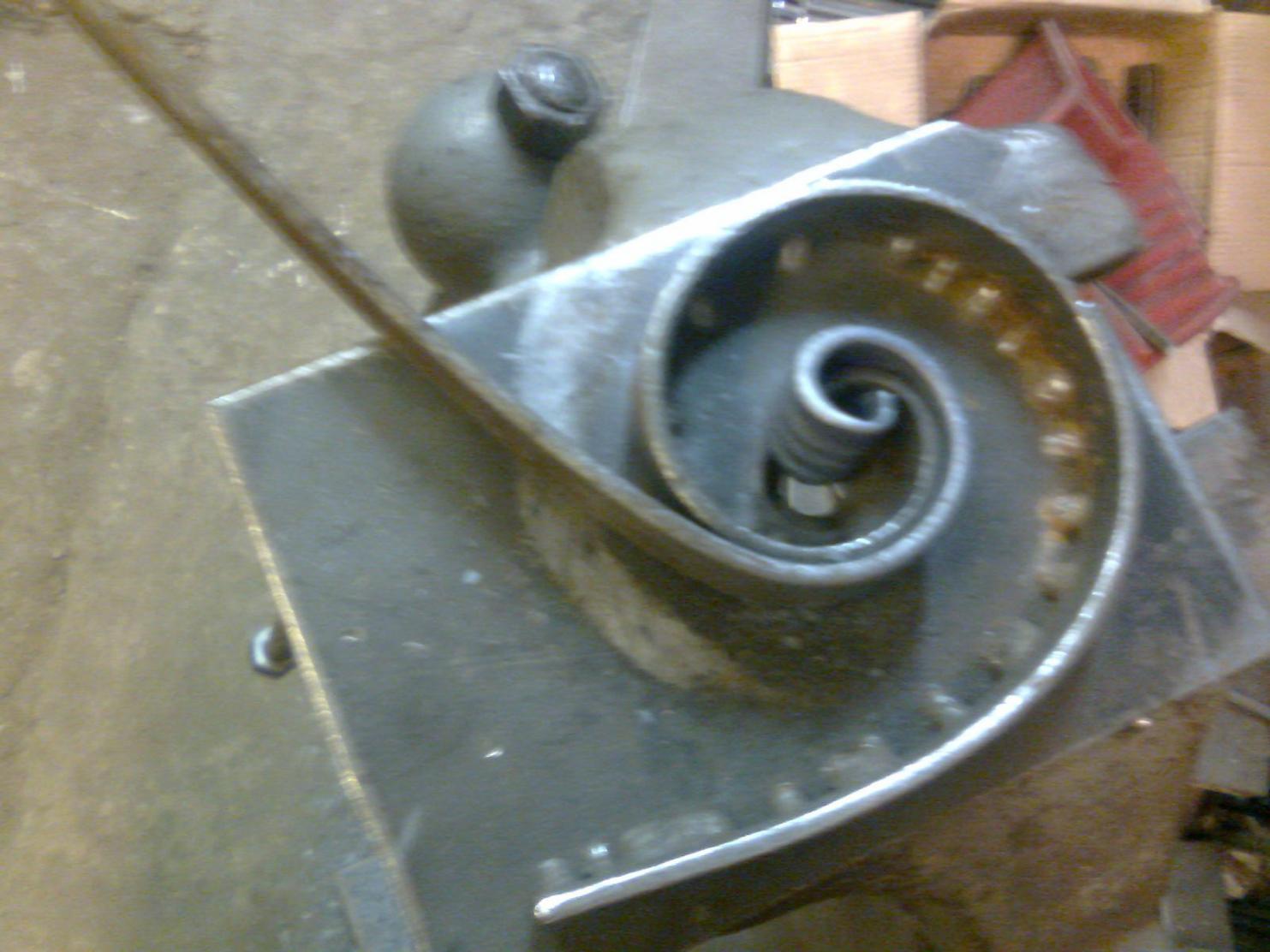

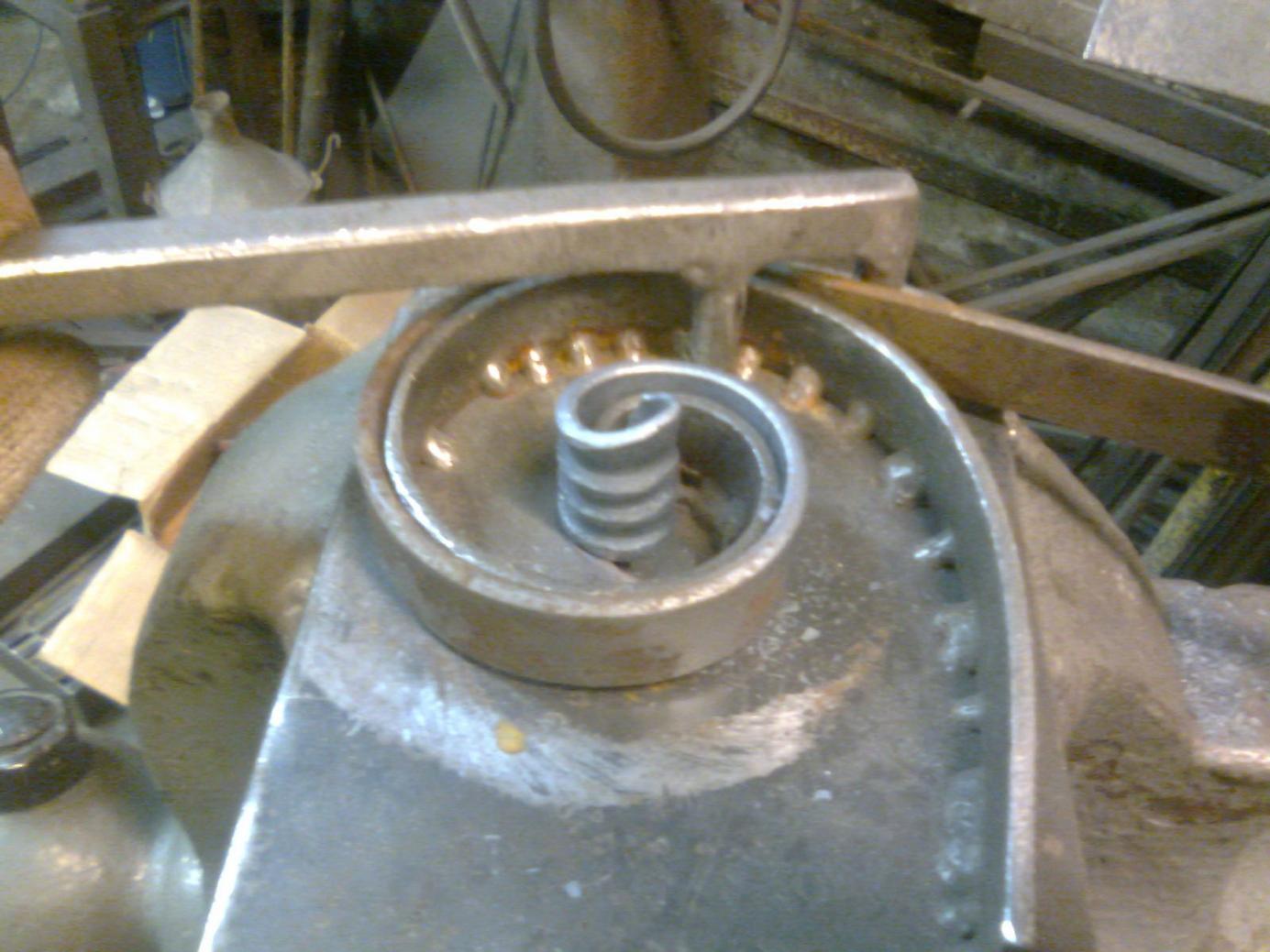

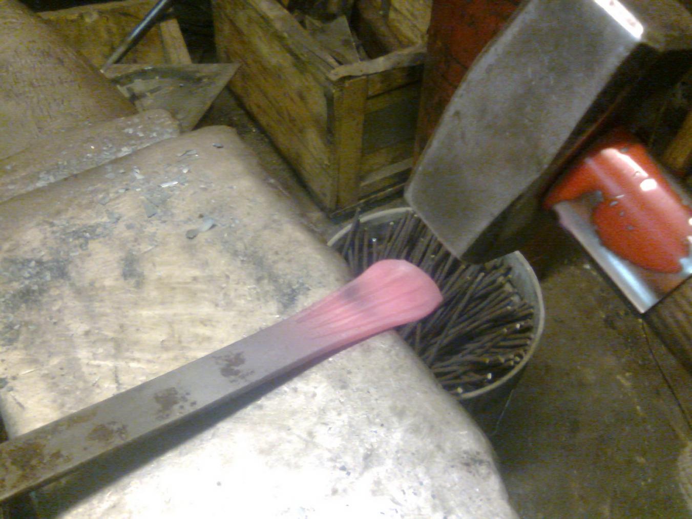

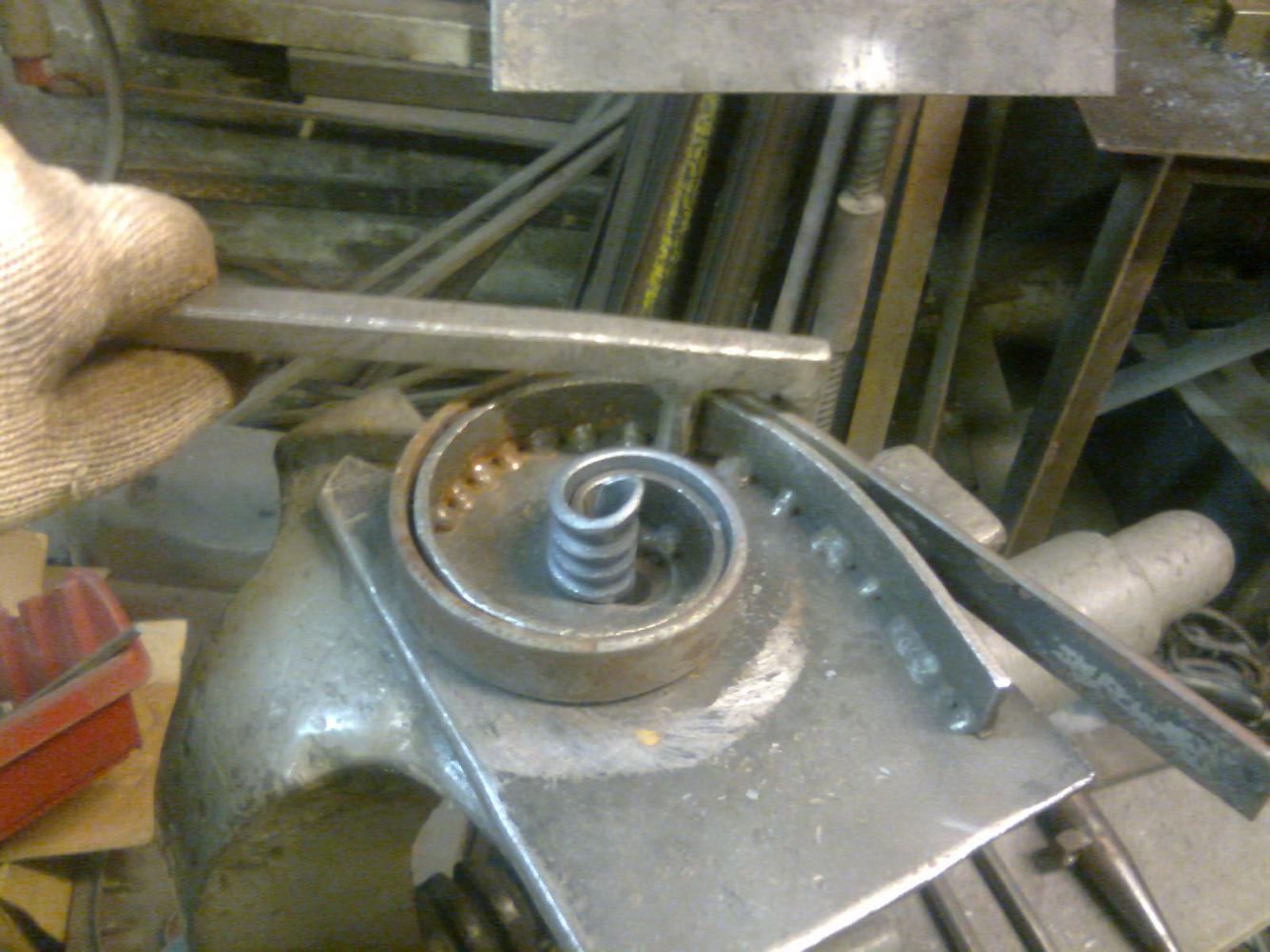

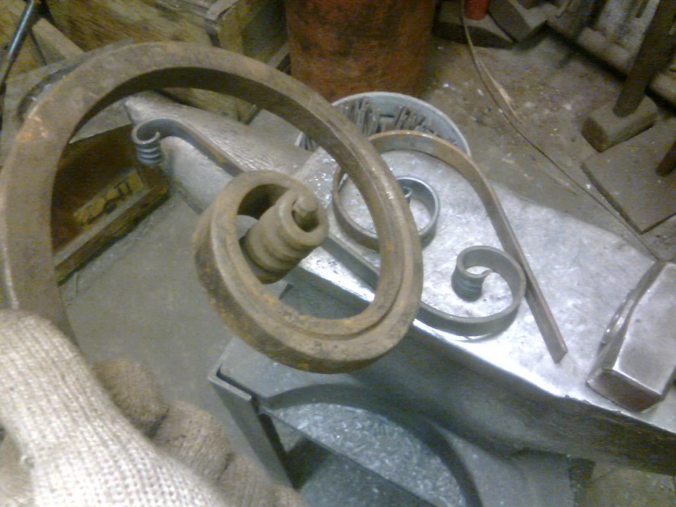

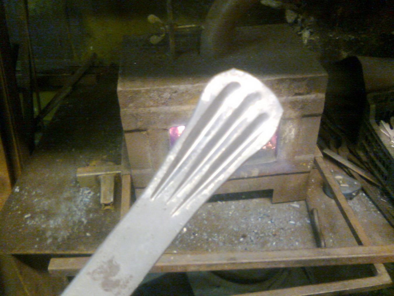

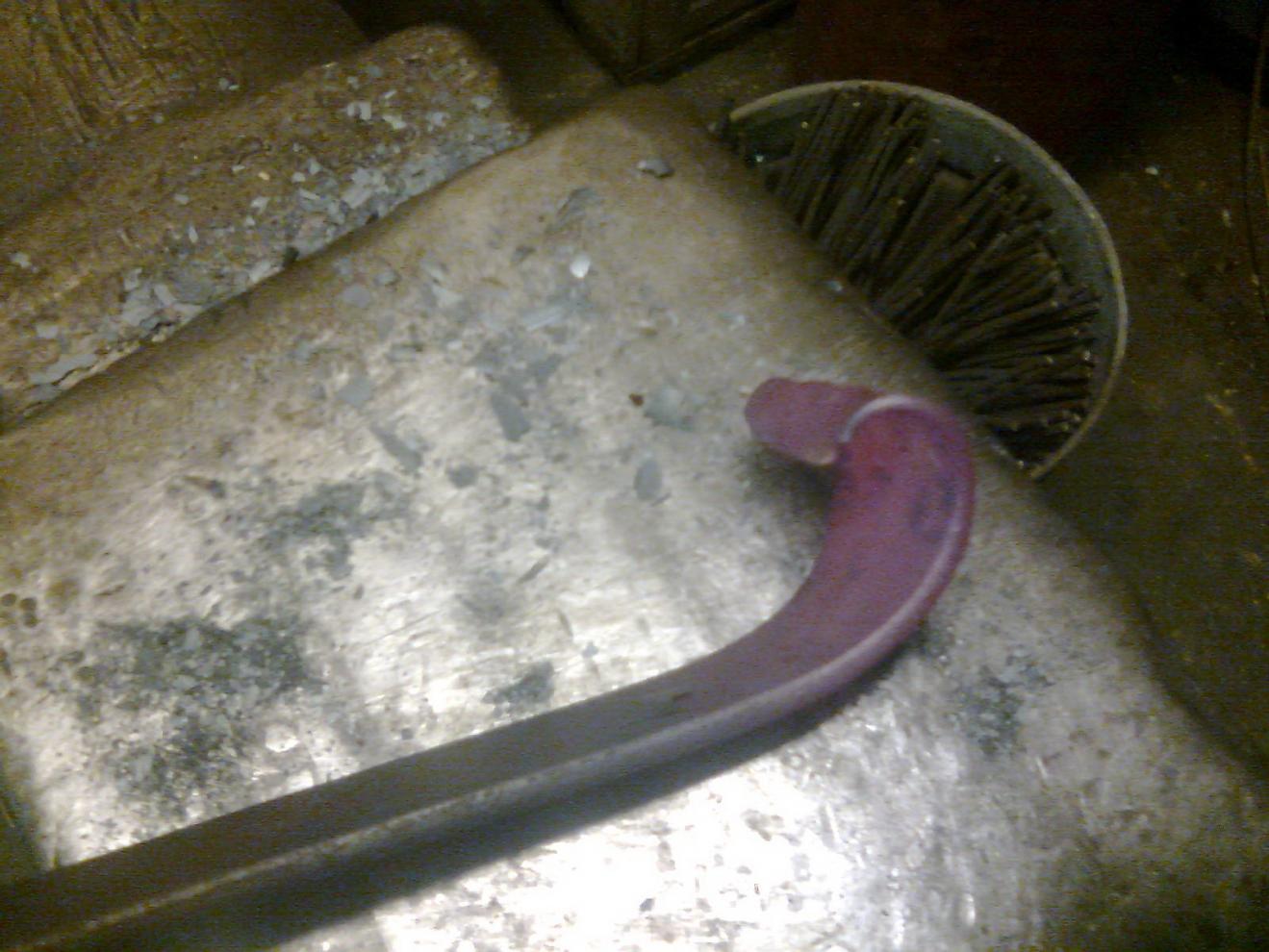

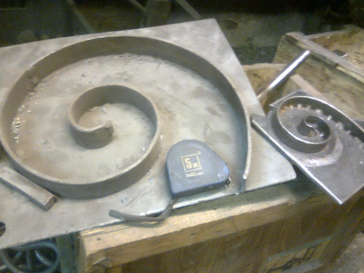

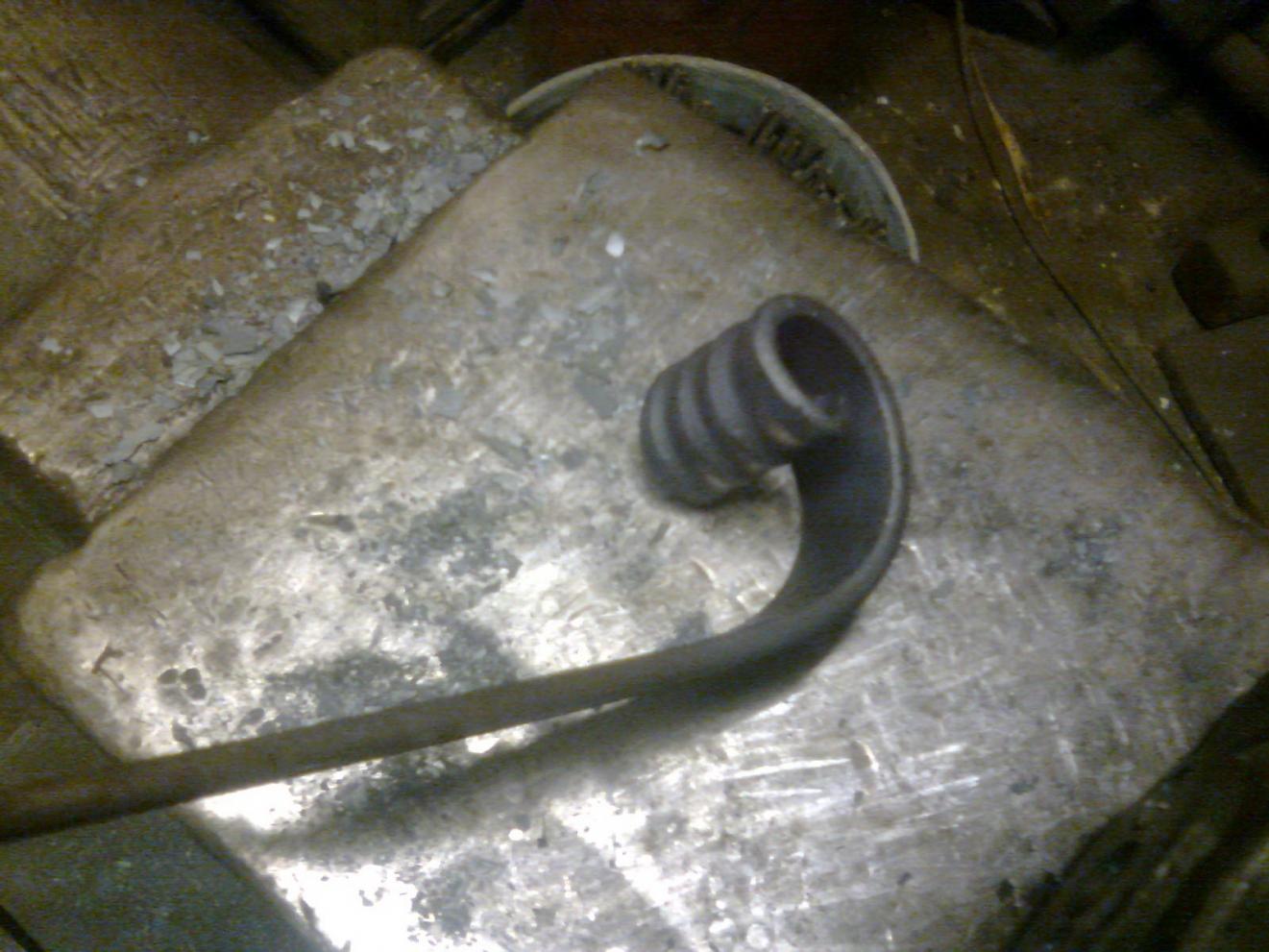

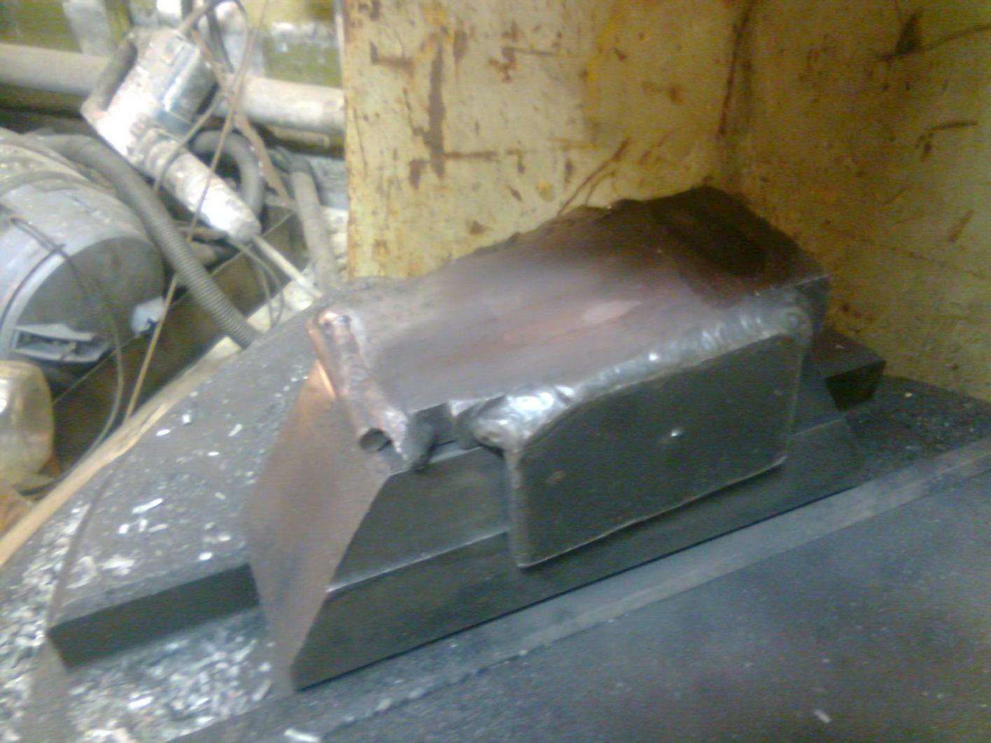

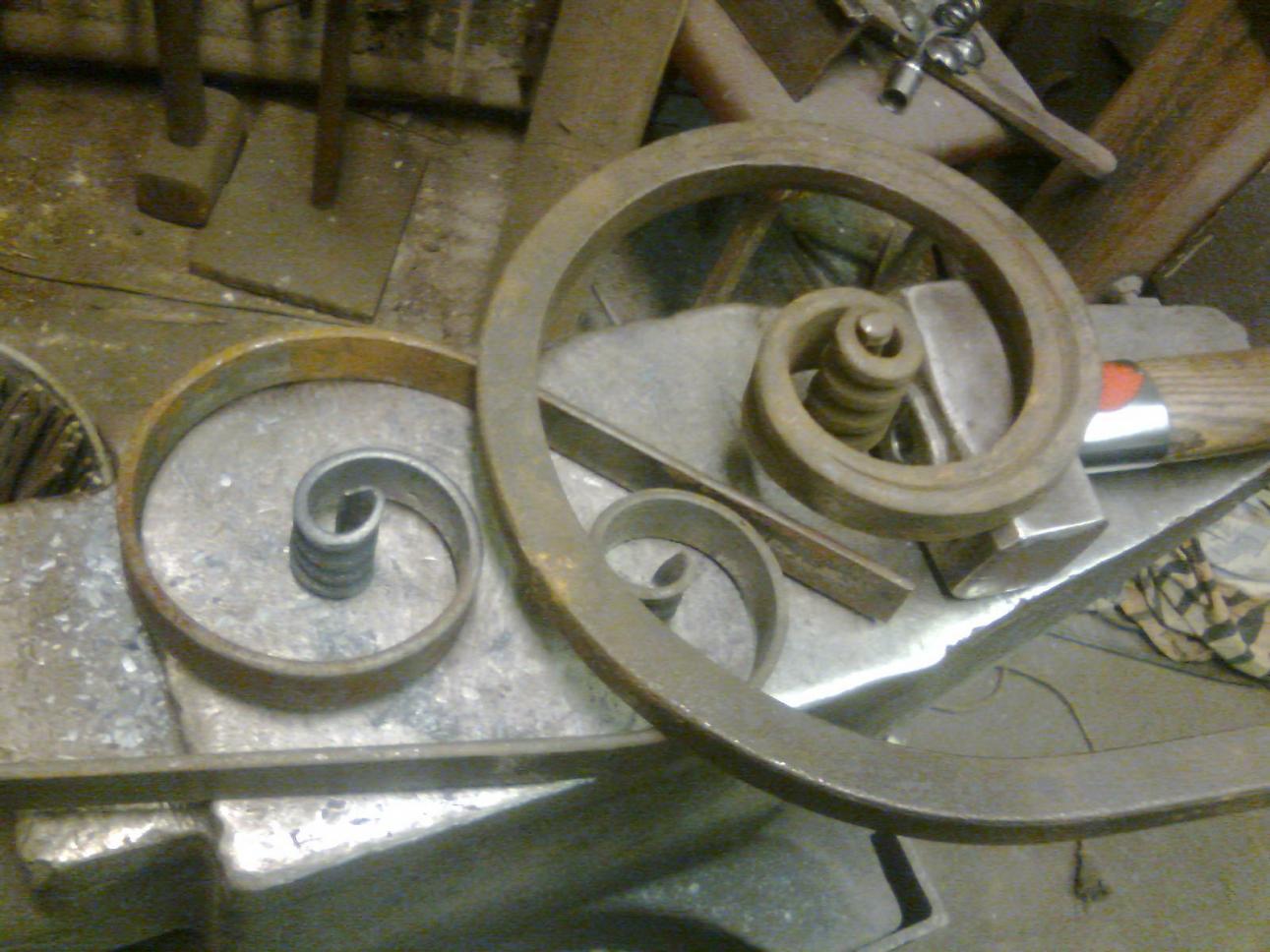

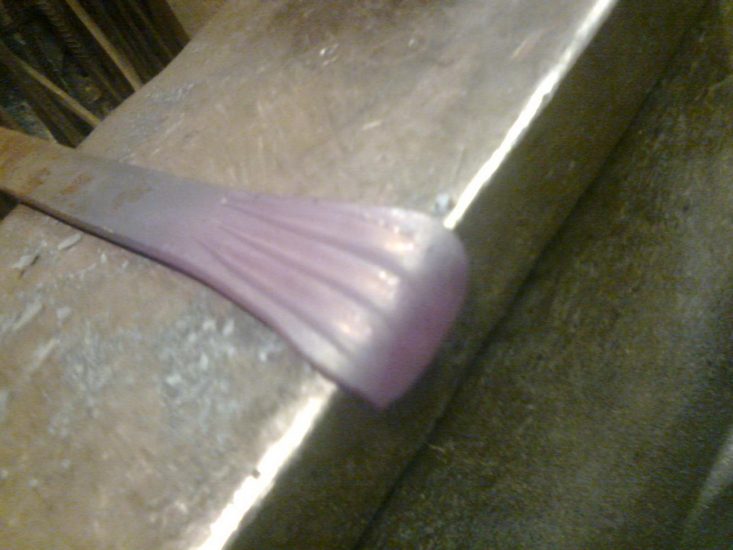

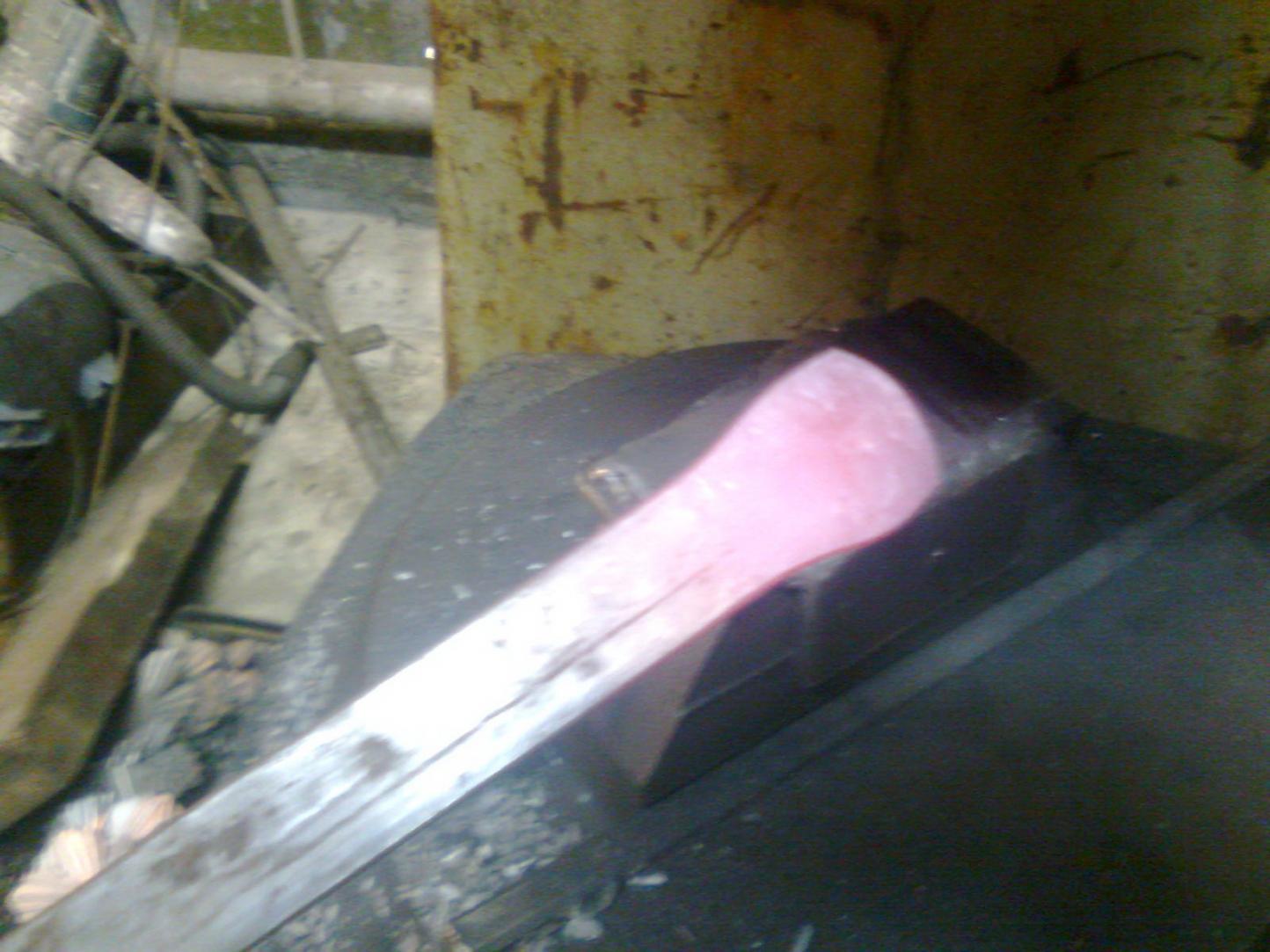

    I have a lot of conductors but mostly I use the two how do scrolls-for example, I made ​​the scroll of the strip (20mm x 4mm)heat the end the strip in a gas forge and with the power hammer we flatten end of strip
    (You can flatten by hand on an anvil, but it is a very long and hard )Then I do Grooves,with a home-made instrument.Here we get a workpiece.Heat the workpiece once again and start hammering on the anvil to give the desired bend our blank (this requires some experience) after the given initial bending workpiece, insert it into the conductor and bend over it to the desired size to us.
    all of the above in pictures-part 1

    it all depends on the thickness of the workpiece. thin material can be a cold, and thick workpiece it is necessary to heat up strongly.
