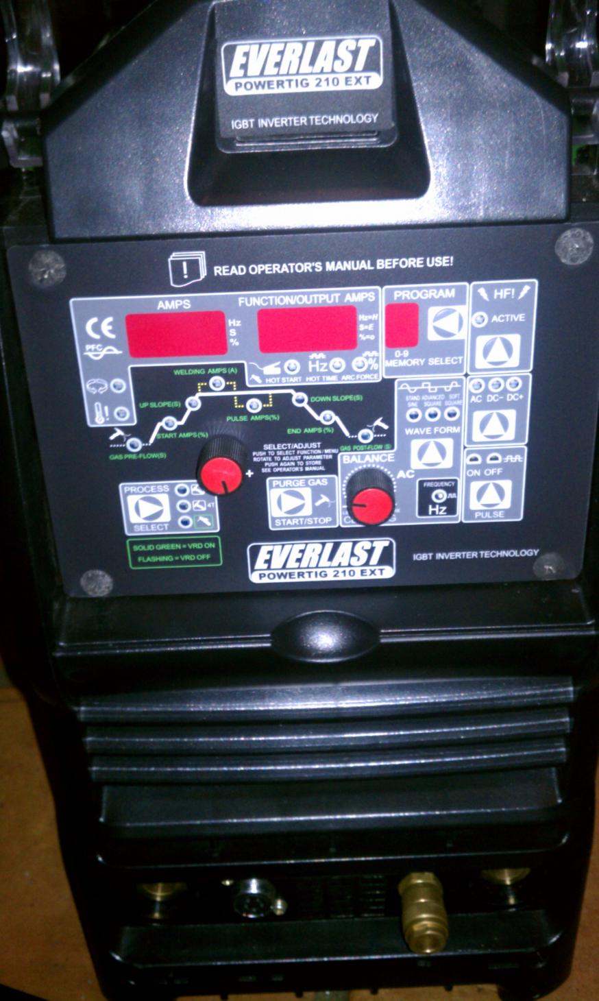

    Just received the final update unit (cosmetic changes). So far impressed and it is not out of the box yet. I will snap pictures later.
    Packaging stronger, lower profile pedal, stinger is clamp style. Little things people complain about getting fixed. It looks like a WP26 torch (I will live) and I will swap that out after playing with it first. Has a black handle over the chrome, looks meaner. Also small and light compared to the 250EX.
    All in all, excited. I have not pulled it from the box, just popped the top open.
    More later. Will see if I can break away from all the knob/settings at a glance.
    If you pre-ordered you should have yours by now as mine went from Ca to Fl.
    Anyone else here on the forum get theirs??

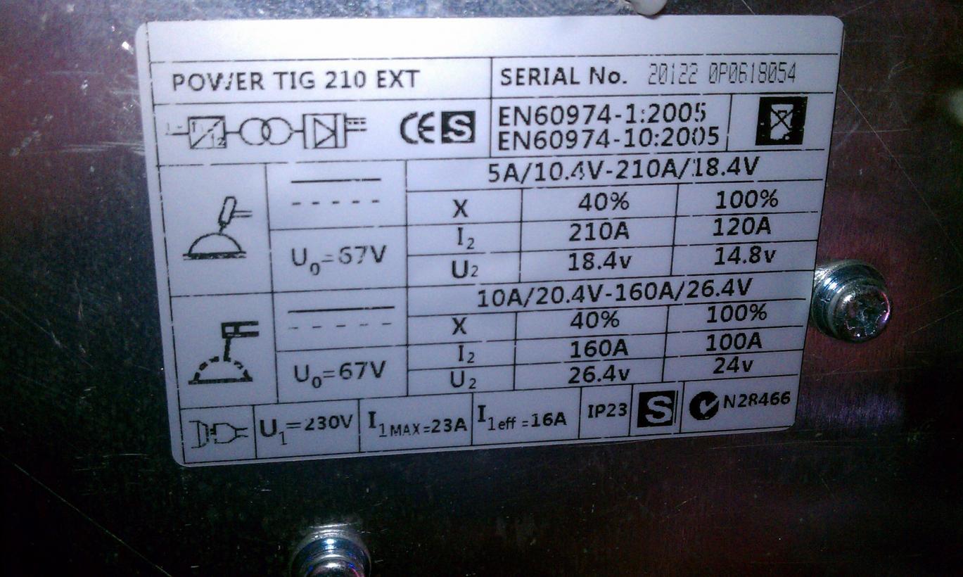

    Some pictures below. I don't have a spare 50 amp plug (will pull one off a unit or get one tomorrow), but the IMAX said 23amp/230vac, also, 210amps at 40%.
    Basically, if the imax is correct it will get a twist lock 30 amp and this unit could replace my 250EX and the 160STH. And the size it a major plus (8.5W x 16H x 18D). The 250EX will probably always be the shop machine, but I think this unit will be a great AC/DC TIG and portable TIG as well.

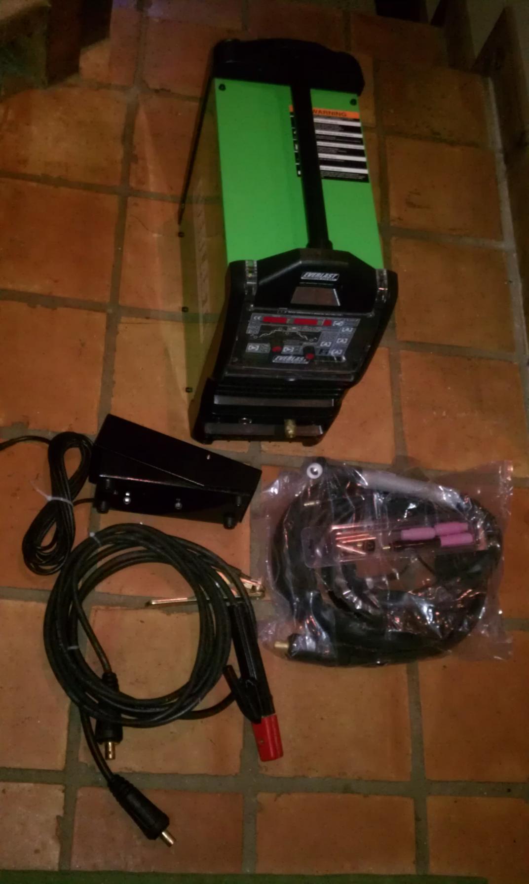

    The package. Wait.. There was no manual in the box? Don't need a manual anyway. Only two collect sizes and a 26 torch, but if that is the only disappointing part. Not bad

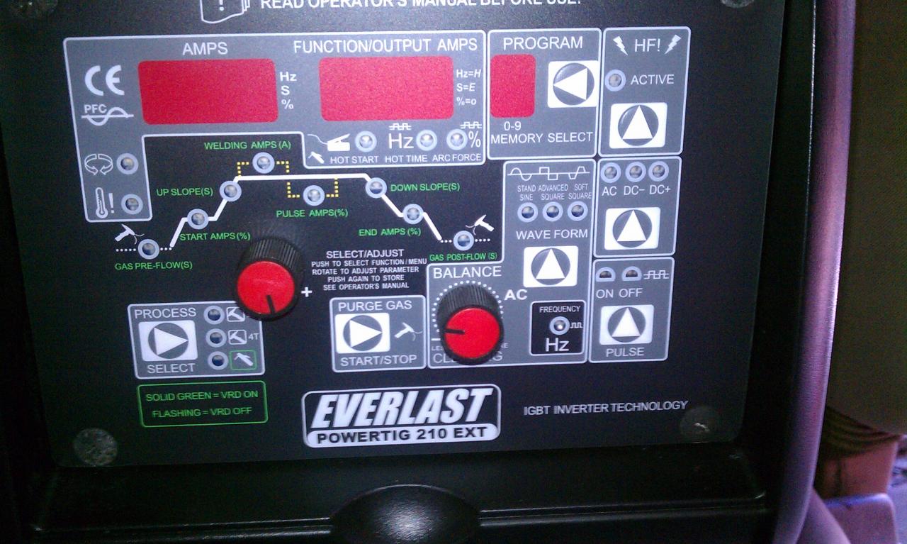

    Display, more I looked at is, the simpler it became, fist glance was I like all the knobs.

    The front.

    Specs if the android did its jobs...

    It doesn't have the thumb control, the grey fooled me too. But the pedal is much nicer than our older pedal.
    Comes with a 1/16" and 3/32" collet. For the amps that is fine. Touch is nice but no water cooled, again, for the amps it is fine.
    The quick connect for the gas, I have to ask Mark what kind and pick on up tomorrow. And there was not one in the package, or hose or regulator. I will have to ask Oleg is that is normal, or because it was send to me and I have all that (not the quick connect though).

    The panel is a dream to work not seeing the knobs I am sure will not bother me.

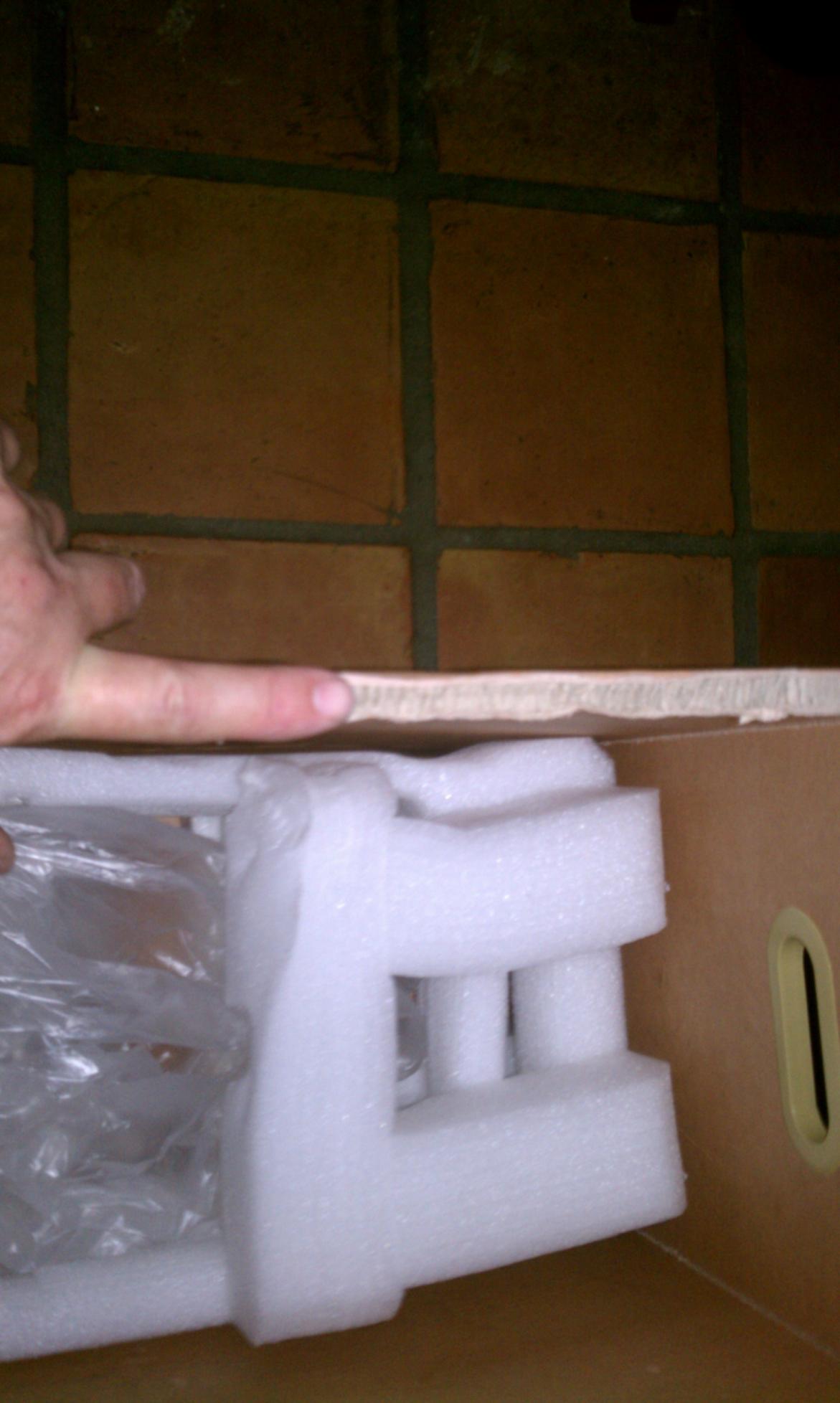

    No worries on this unit as far as shipping, IF the units are still in the same box. The cardboard on the unit they shipped from the factory was a special type, almost 3/4" thick with thicker foam around the ends. Maybe Mike can give a clue as to what the production units actually have.

    I can take a picture of it, built well. No damage from the outside. It has a lift off top, and thick, thick cardboard like you mentioned. Thick foam top and bottom as well.
    Top has re-enforced corners, handles in the sides and like Mark mentioned 3/4" thick sides

    Good point and when I saw the 23-26 amp, my first thought is, we need this in 110VAC...
    The multi-voltage is a good thing (though I have never used 110vac other than on plasma, but wanted it just in case like the PA160). The 210EXT is 30amps, so a generator will cover me there.

    Mike, if you read any of my posted on the new EXT series, I mentioned I doubt I will ever not want to glance and see the knobs. This was far from what I thought it would be. I know where I set them (in my head based on the metal/thickness and not analog knobs settings either). And it takes seconds to see and change them settings.
    To be honest, I will probably keep them all. They each have features that make me need them. I forgot about the 110 on the 160STH. Maybe I will drop a 110vac plug on it this weekend. Should be able to get 80-90 amps TIG wise. I just really think I am going to like the EXT so far.
    NOTE, I have not done any welds with it (to confirm the changes on the fly). I have determined the presets do nothing for me. They do not save the 2T/4T AC/DC MODE and HF, so I see no reason to use them as we never get the same job twice TIG wise).
    I wanted to use the presets, 1 = anything on the fly, 2=aluminum, 3=steel. But without the AC/DC saving, easier to just hit AC/DC button.
    For me HF always on. If steel, hit DC, else hit AC (normally run 100hz and -25 on AC and they are saved now as default in preset 1). Push function knob, click to each spot and set (by a push, turn and push). Then weld. Pretty simple.
    Kind of odd that the AC/DC does not save? Seems it would just be controlled by the software anyway. I woudl think knobs woudl be a bit easier to switch from steel to aluminum settings since you can see which ones you forgot to turn.
    Does it at least save your EP settings and frequency if you set them in AC, then go to DC, then switch back to AC?
    Seems really odd to me, too. I would expect it to save everything or what's the point. Something for the first software patch. Speaking of which, is there any provision to do software updates in the field, such as a JTAG port?
    I asked Mark about that (flashing the unit), I think it has an Atmel inside so I would guess it can be updated.
    I got it all hooked up last night but the guy did not get the drawings to me for the project and did not answer his phone. So I am sure it will get used today with the 26 torch, thin stainless, so not a big deal.
    I'll re-check, but I am pretty sure it did not save the AC/DC and a couple other items. The presets are a good idea, they just don't save it all so I will not use them myself.
    Yes, it does save the EP and freq but you still have to hit AC for that preset (so a little odd). Look like something that needs to be fixed. Mark can relay that to the factory after I confirm it again today. But pretty darn sure it doesn't' save AC/DC, HF (but HF does default ON), etc I would expect it too.
    Looks like maybe it saves the knobs but not the buttons. And like I said, easy enough to tap the buttons. I am OK with it the way it is, just thought 1=aluminum (just set amps) 2-steel (just set amps), etc would make since for the presets, then tweak amps.
    Mike, I need to check, I think the program does save, but you have to select programs for AC, DC, and stick first, but each has 10???Got to check it out this week. IF you make a change to the setting in the program, while welding or anytime you have the program, the last setting on that channel will automatically be saved.
