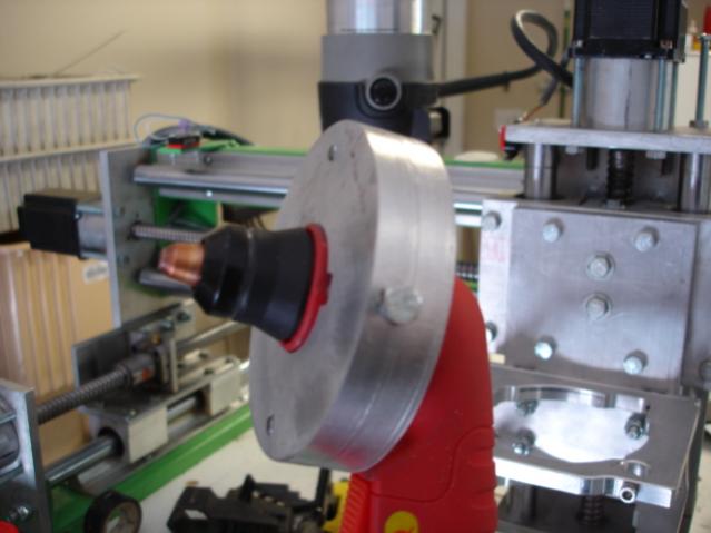

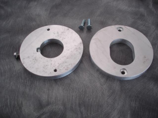

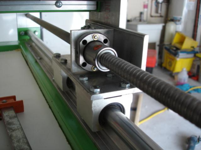

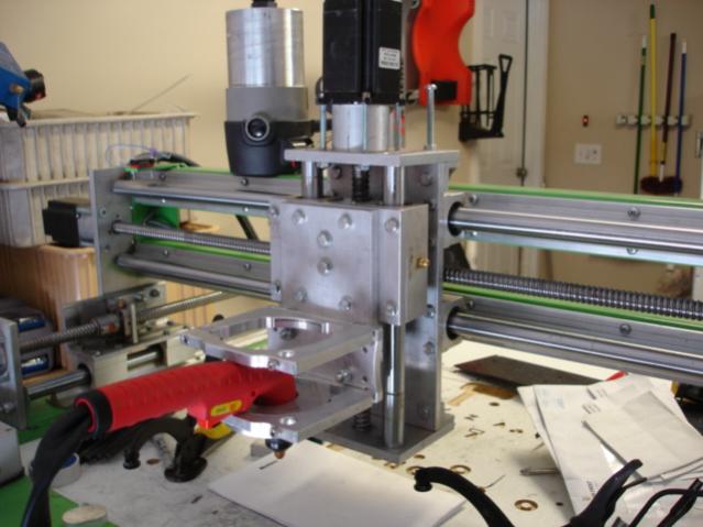

  7. Default My hardware and plasma holder
    I would like to see Everlast offer a straight torch in the future as an upgrade. In the meantime I have machined the torch holder shown in the attached pics. As you can see my machine was primarily set up for use with the Porter Cable router. The holder I made just slides in the same hole the router normally sits in. I have also included some photos of the various stages of my build.
    Geezer, for the most part the Torchmate deal seems to be a convenient way to get into plasma cutting because they offer all the software tailored for the task. For me it is a little different. I am using Mach3 and CamBam software to drive my table. Mach3 can be configured for router, laser, waterjet, plasma etc, but it requires a very good understanding of the particular process you are running. For example when I am cutting wood or metal my plunge cuts could usually start anywhere. With plasma you have to offset your plunge cut (pierce) and then transition to your cut to get a smooth finished edge. From my understanding these offsets (I think they are called Lead Ins/Outs) are handled by the cam program. Maybe the cam program I am using is not really suitable for plasma as I have not seen any settings for Lead In or Out. Someone on another forum recommended SheetCam so I might give that a whirl.
    So I am glad I will not have invest in torch height control. I am still curious to know how your table knows whether ignition has taken place. You obviously have the trigger switch routed to your controller. Is that the only control that your table uses? Is there a current donut or something you place on your cables?

    Generator,
    We are not a torch company. Just as Miller doesn't provide WeldCraft, or hypertherm torches and doesn't provide every possible torch combination, we are in the same boat.
    However, Trafimet, offers a compatible s-75 machine torch for this application, which, can make up a torch to your specifications. Typically they run about 400 dollars.
    Depending upon the system a simple delay or a voltage flow sensor tapped into the main power line to sense arc transfer could be required. There are several ways that these smaller and cheaper units are configured for plasma operation to diversify the types of plasma cutters that can be used with the equipment.

    Your set up for the torch holder looks just fine, the machine looks great,as far as a feed back loop or donut sensing ring on the cables, there is none. Cadlite from torchmate is used to set male or female entry paths on the parts to be cut, other programs can do the same.
