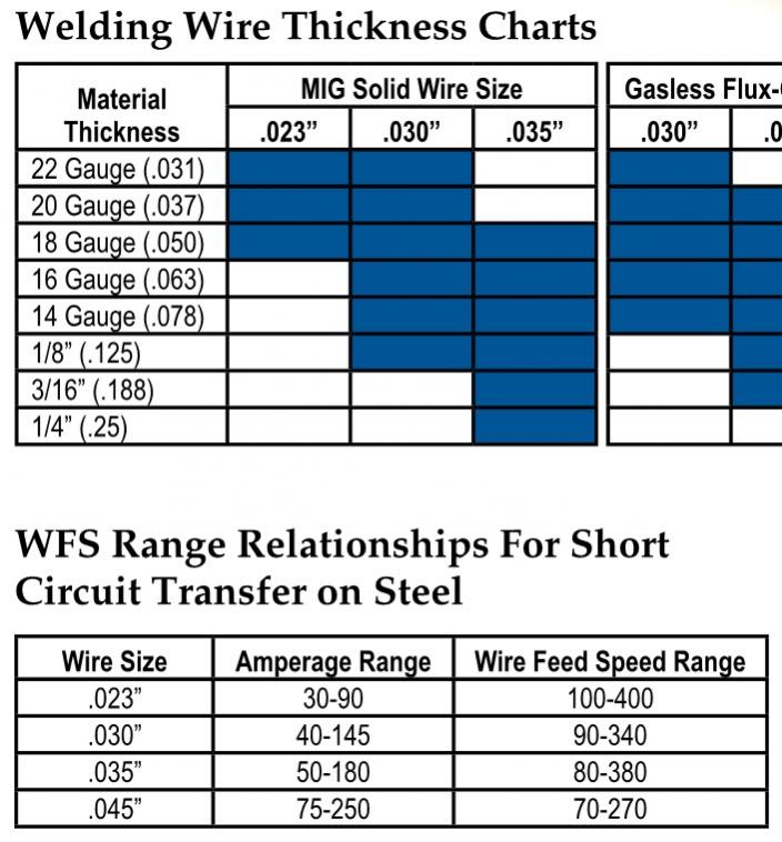

    I have no experience with it but looking at the radnor chart it should work up to 50 amps or so wouldn't it ? Click image for larger version.

    With the I-MIG 160 at 590 IPM: http://www.everlastgenerators.com/Sp.../PowerIMIG.pdf
    the 200 and 205 at 600 IPM: http://www.everlastgenerators.com/Br...-I-MIG-200.pdf, http://www.everlastgenerators.com/Br...-I-MIG-205.pdf
    and the 250P at 700 IPM: http://www.everlastgenerators.com/Br...I-MIG-250p.pdf,
    I don't understand why there would be any issues at all when that chart tops out at only 400 IPM.

    My understanding is that the wire speed specs are not correct due to some confusion with the manufacturer. I measured my 250p once, I think it topped out around 435 ipm.
    Yet another metric conversion error, no doubt. Sure would be nice if we would finally give up on inches. Even England has, mostly and they invented the damn thing.
    You can expect somewhere around 325-375 for the smaller i migs...depending upon model.

    That's not too bad I guess, at least it is faster than the Radnor chart you posted.
