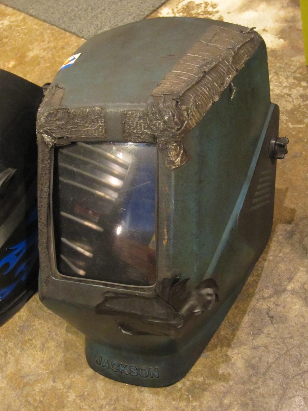

    We'll start with the fixed shade unit... the Jackson HSL-100 with green glass fixed shade filter.
    This HSL-100 with the glass lens weighs in at 1.28 lbs:
    The headgear really sucks, and has an annoying habit of catching on hair. It feels heavy, with the large glass lens, (I'll bet plastic would lighten it up some) and I am sure that my opinion is worsened by the particularly worn out condition this one is in. It's pretty nasty. On the plus side, it's fairly cheap (about $40 or maybe less I think, would buy you a new one that is probably much nicer than this one) and has a large viewing area. The shell is pretty hard and rigid, but seems a rather clumsy shape/design to me.
    How does the helmet perform? What can I say... when there is no arc struck, here's what a test viewing area looks like, compared next to what the same area looks like with no helmet on:
ID:	7851 Click image for larger version.
    ...as it pretty clear from the above, it simply makes whatever you are trying to see pitch black. This is *not* the hot ticket for getting your arc to start where you want it. Once you get your arc started, I suppose it's OK. It's got a quite large viewing area. I never reach for it though, because of it's bad headgear design, it's heaviness, and inability to see before the arc had started.
