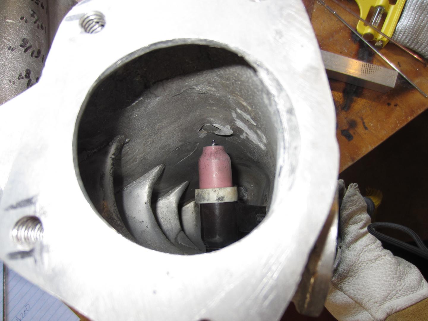

    I found a situation where the arc sensors didn't trigger. I did have their sensitivity turned down (perhaps more than was needed) when bright daylight coming in through a window was triggering it. I was welding through one hole on the inside of an intake manifold plenum, looking in through another hole (about 2.25" diameter).

    It was not a typical welding situation, to say the least, I barely fit the torch in there and only managed after putting on a stubby backcap and flexing the head "just right". Anyway, what I discovered is that if you are looking into a hole that is smaller than the "viewing window" of your helmet, it can put all four sensors out of direct view of the arc and possibly not make it trigger.
    A downside to having a large window I suppose, is that the larger the window is, the more the sensors will tend to get pushed away by that large window, further away from where your eyes are actually at. This makes them more likely to be occluded by something that is not occluding the view seen by your eyes. To compensate for larger windows, I do think there is value to having more sensors as the window size increases. (And/or something like an X-mode feature.)

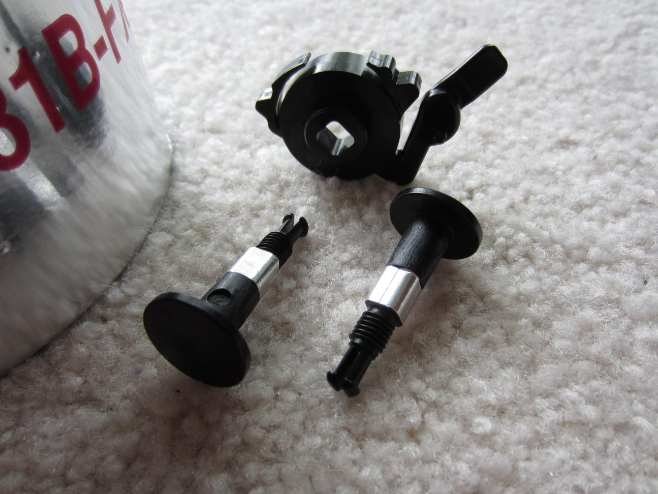

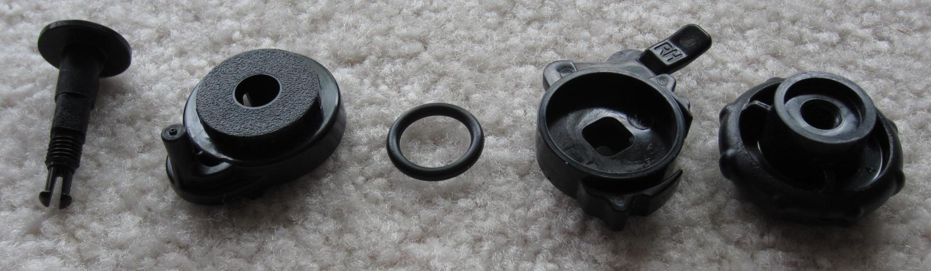

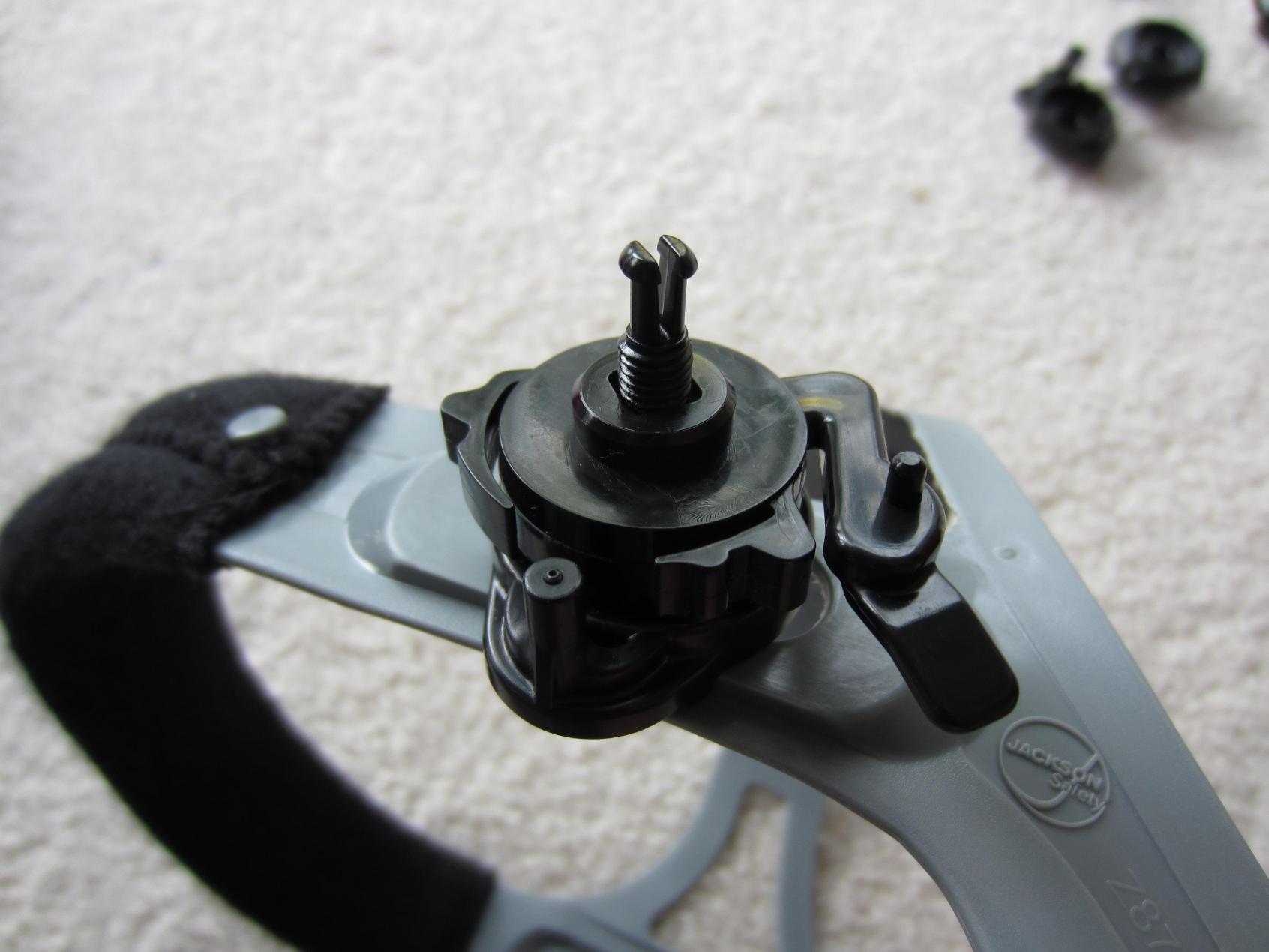

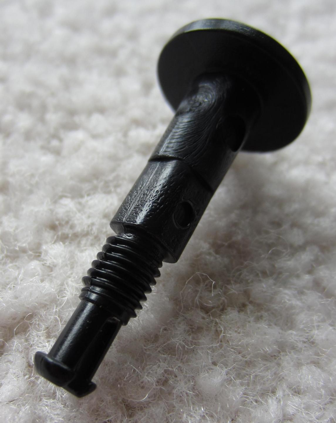

    Here are the pivoting components on each side of the Jackson headgear:

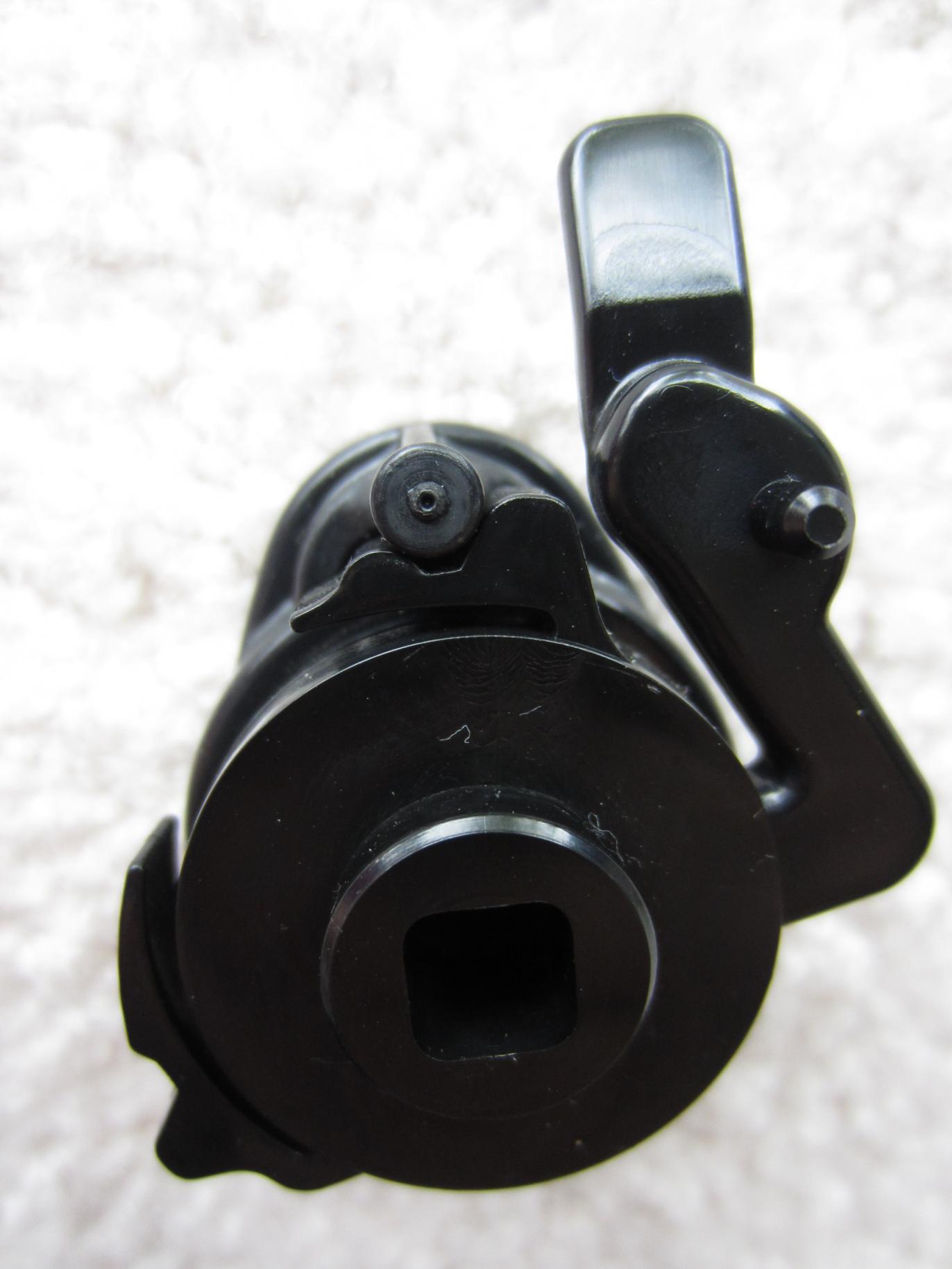

    This part appears to be the culprit:

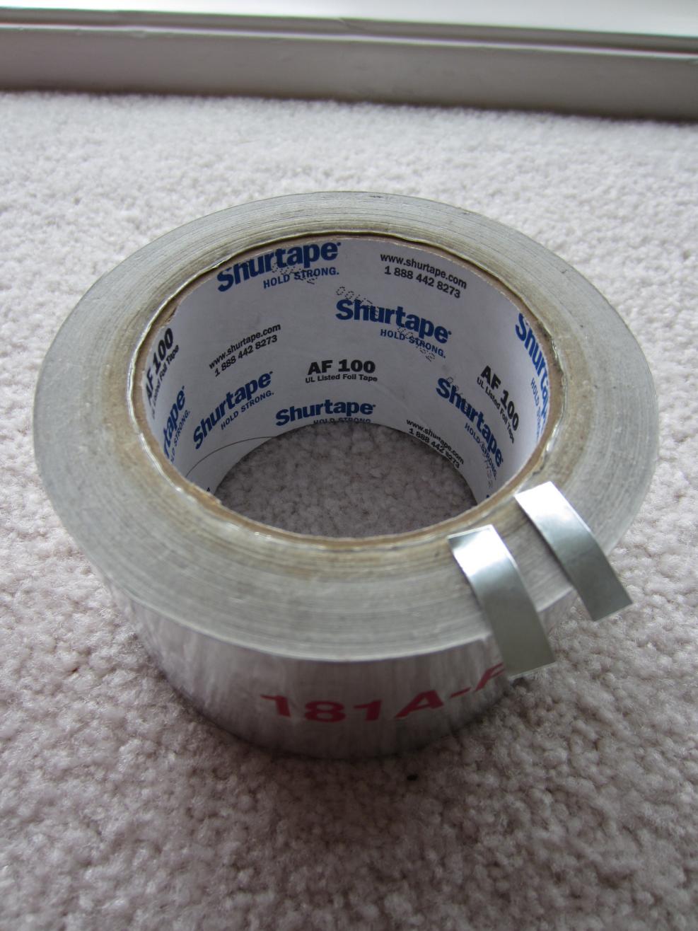

    Sloppy tolerance in the square shank was causing rotational play with the mating part. This rotational play between these parts was causing the friction adjustment knob (only on one side of the helmet, which I never figured out why) to rotate back and forth some each time the helmet was raised and lowered (and possibly, loosening up over repeated up/down cycles).

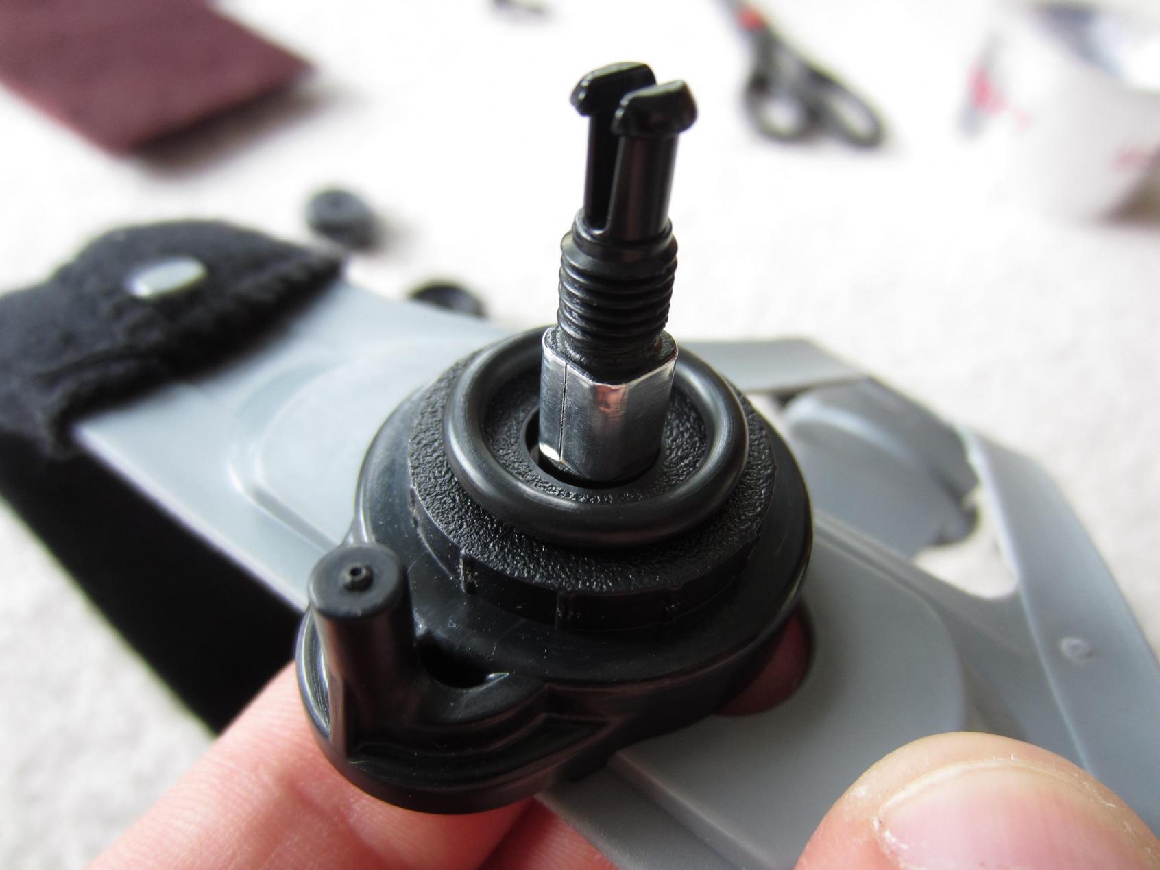

    My solution to eliminate this slop was to carefully cut and apply some aluminum foil tape to the square shank of the post:
ID:	8234 Click image for larger version.
ID:	8235 Click image for larger version.
    The foil tape seemed to give the needed dimensions to take up the play between it and the mating part:
    Initial testing of the pivoting mechanism shows that raising and lowering the helmet no longer causes either of the friction adjustment knobs to rotate, so I think this might have fixed the problem with the friction not being consistent. However, I'll have to put some longer term use on it to be sure that this is the cure.

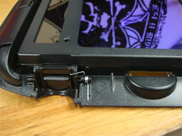

    Also, I thought I'd add a pic showing how the up/down detent mechanism works. Here it is in the "up" position:
    (It's interesting that there is also a weaker detent for the "down" position; I didn't realize this before.)
