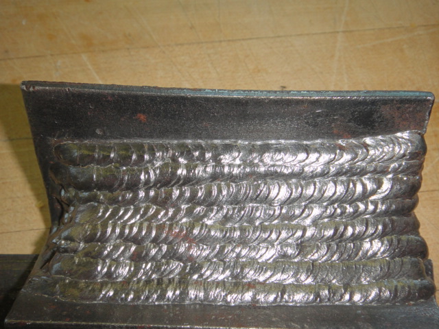

    For years I used strictly 75/25% mix, always heard of bad welds from straight CO2 gas. When I finally went into the local university to get some credentials (helped with insurance and credentials for getting clients) I saw they only use CO2. The head guy said it was for budget reasons. Anyway passed my cert plates with straight CO2 and the welds look great. A little dark when finished as they lack the argon cleaning bennifits but nothing a little wire brush can't clean right up. So when my 150 mix bottle ran out last month, I went down to the local AirGas to get some more inert gas. I owned my bottle, and a refil once all the costs were paid was going to be $83. I then asked about a 35# bottle of straight CO2. a 35# bottle of straight CO2 has considerable more volume of actual usable gas than a 150 argon bottle. Anyway the straight CO2 was only $34. AirGas let me swap my argon bottle for a CO2 one, and I was out the door. The only modification you need to do to your Mig is to change the regulator out from an argon one to a CO2 one as the fittings are not the same. They do make an adapter that will allow you to use your argon regulator which I bought since it was only $15. I have since built an 8x12 trailer, and some other small projects using straight CO2 and it works great. My only problem is when hitting it hard my argon regulator gets cold and has stuck once. I am told a straight CO2 regulator will not do this. I have one on order from Ebay - costed me about $50 deliverd. So if I had to do it over again I would have just bought a CO2 regulator up front to save some cash in the long run.
    My advise is give it a try for yourself. It cut my gas costs by over half and that means more money in my pocket. My welds to wet in fine and look iditentical to the ones I made with the mix in the past. I will post some picts of the welds on the trailer tomorrow. Heck, I may even weld up a demo plate as I have some scrap lying about.
    I hope this was helpful. Wish someone would have given me the straight along time ago on gas as I would have saved a lot of money over the years.

    I found these two welds lying about in the shop, one is a 3/8" plate 2g and the other is an 11 or 12ga 3f. Hope the 11 or 12ga is thin enough for you DaveO, I do not do many sheetmetal projects.
ID:	7831Click image for larger version.
ID:	7832Click image for larger version.
    Just remember to clen the welds with a wire brush - I use a 4.5" grinder with wire wheel installed and it cleans right up in seconds.
    Hope this is helpful.

    A couple of things about CO2. I have used both extensively...so.
    1) CO2 is NOT inert. It is an active or oxidizing gas. It does introduce impurities into the weld as it is superheated. The top of the weld isn't in the condition it is because it isn't cleaning...it is in the condition it is because it is oxidized by the C02. CO2 does better than nothing for sure, but it isn't ideal for a quality weld
    2) Voltage required for the arc to bridge the gap using C02 is higher. This means you are naturally going to run hotter, and have a more violent AND unstable arc situation.
    3) Clean up expense and time, if you are into that sort of thing (making a weld look clean and nice), can make up for the clean, pure look of the weld, because much higher rate of spatter also sticks harder when CO2 is used.
    4) Regulators, even CO2 ones, will freeze. They make "heaters" for the regulators you can use.
    5) Gas flow rate requirement for CO2 seems to be higher, so consumpution is higher.
    As far as the price difference, I have kept up with my labor for both, and the specific blend I use, and for me it pays to use a higher amount of Argon, even though it is more expensive. I personally use an 18% CO2 content.
