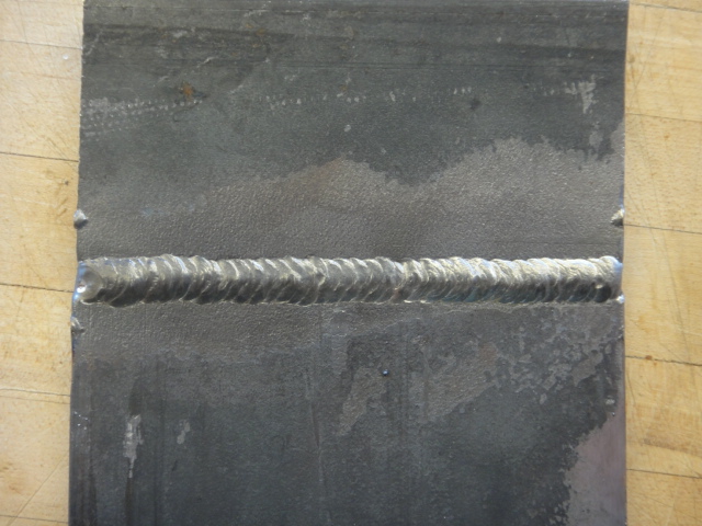

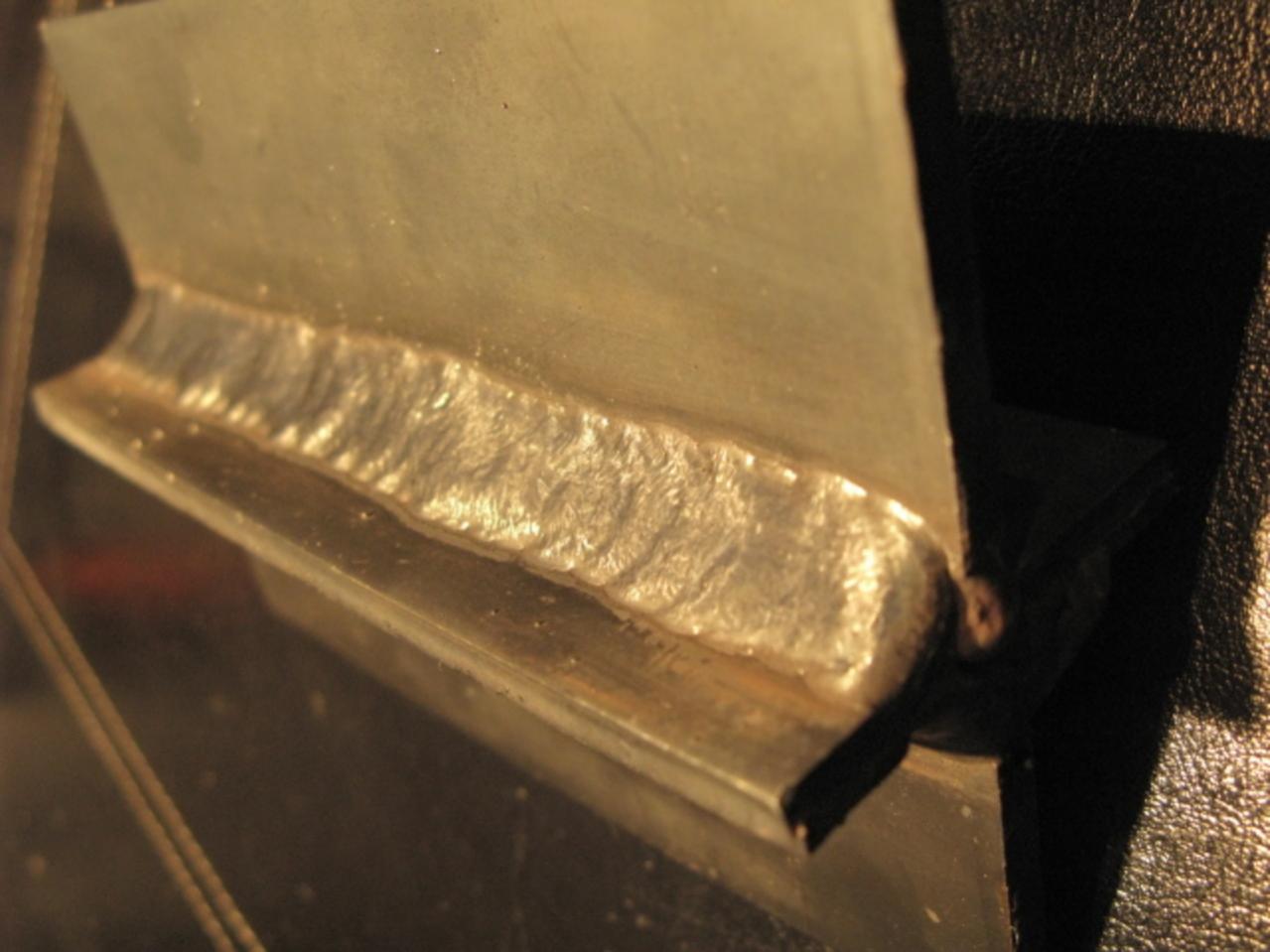

    Ok no chance to get a video but here's a pic of a 2F 2 pass weave. Click image for larger version.
    It's been quite a while since I've seen a fillet block! It always seems like you weld block after block up in welding classes and it's never ending, but that's certainly the best time to try new things and learn as much as you can without anyone "breathing down your neck!" Nice welds by the way.
    Have you done any dual shield welding in your class yet? I always loved playing with all the different welders and processes in school since you don't have access to all that equipment at home. I'd love to go back to college and brush up on my skills and knowledge one day (probably never happen though).

    Yeah, sorry that weave was flux core I love school! I'm glad I found an instuctor, school and trade that I enjoy doing...it really helps. I agree I have learned so much since I "thought" I knew a lot. The more you learn the more you understand you have way more to learn. I just started pulsed spray today and it's a whole other animal.....wierd, but awesome at the same time. I'm also glad I found out about these welders...I started learning GTAW by myself with my 185 Micro. If Everlast priced these units higher I honestly don't think I would have falling in love with TIG and went back to school.
