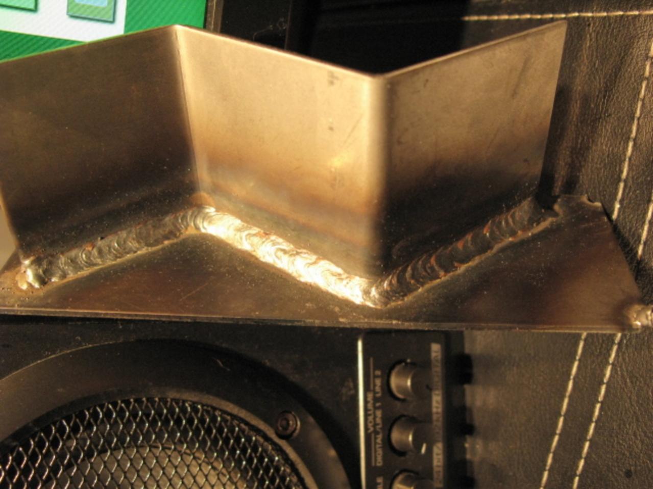

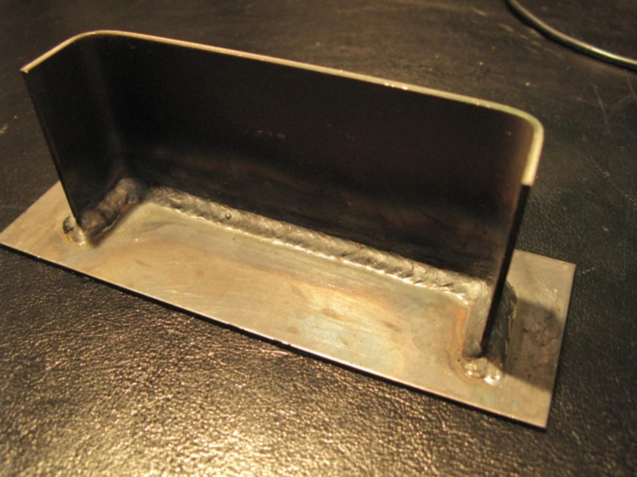

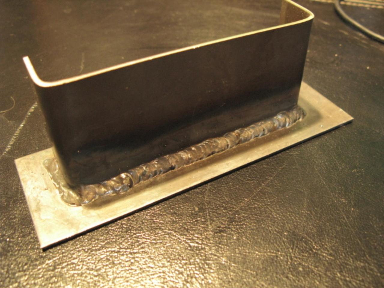

    I have used both and for short cicuit trasfer I think it is 90% as good if not almost the same. Once you get to globular and spray transer 22 volts and up it starts having a spattery arc and argon fixes that. Here's some shots of a couple test plate I welder yesterday in class....both 100% CO2 Click image for larger version.

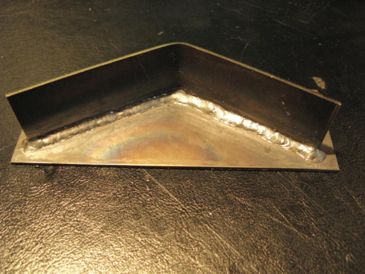

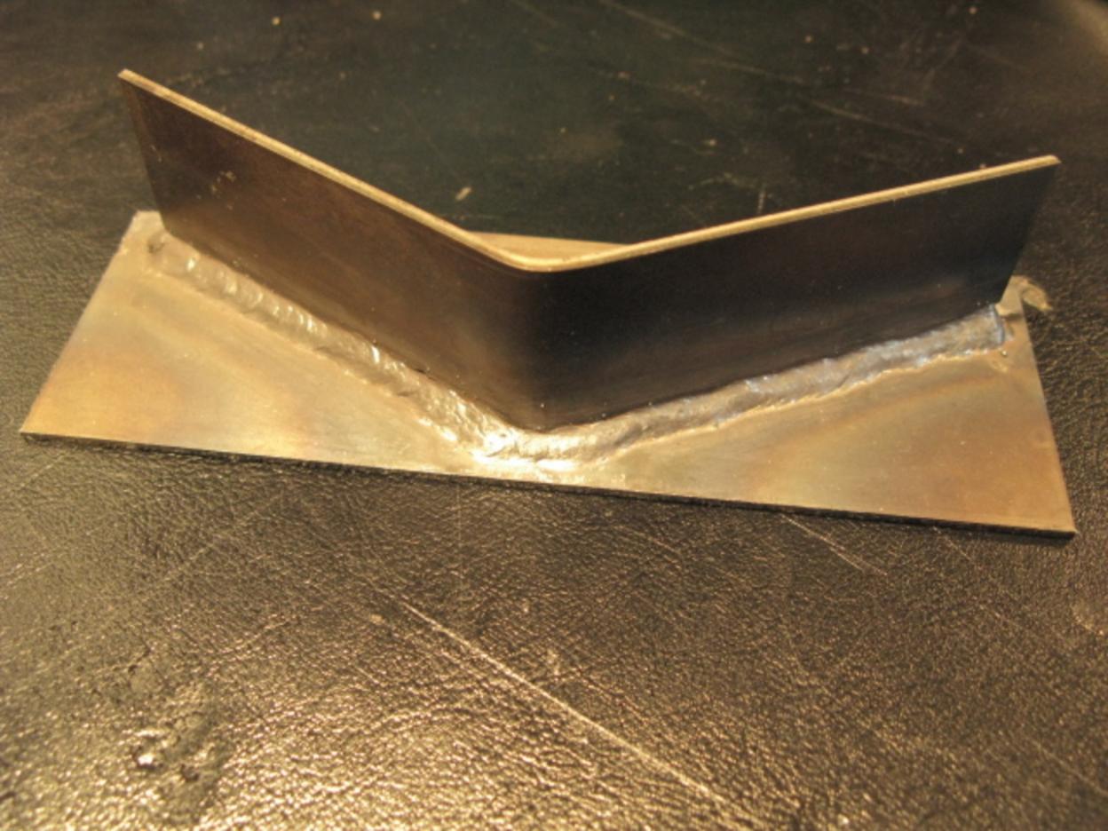

    Geeez I need to learn to type! Anyway here is a Vertical down test I did today using 100% CO2. ALso just to not confuse anyone from my last post. You can't to spray x-fer with 100% co2. You need a mix of at least 75% argon, but that is still to low. 80% is the min starting point most use for spray x-fer and 92% makes the arc more stable an you can use less voltage and amps getting same results. Only problem with spray is the deep penitration and big puddle weld deposit rate, but on thick stuff it really kicks but.Click image for larger version.

    Spell Check would be nice on the forum I have to keep check with the wife if it is spelt right or not. reason (penitration spell check penetration)
    Good welds with Co2.

    A note about spray transfer. You actually need LESS than 20% CO2. A 75/25 mixture yields anything but satisfactory results with spray...too high of voltage requirement.
    For the best test, you should do a vertical UP test since vertical downs are typically frowned upon unless you are "zipping" things together in a cheap trailer plant somewhere throwing together thin tubing...running it hot.

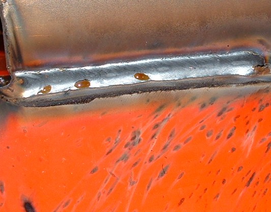

    Spray transfer is hot, and fast. Ordinary spray is for flat only. It's clean smooth and almost as quiet as DC tig. Out of position, it isn't pretty as the puddle is so hot it falls in globs and can't stay in place. The welders we sell with pulse are specifically designed for spray and use out of position because the pulse creates a dual transfer...but only one the spray transfer is supposed to transfer metal, and the arc only drops into the globular transfer range long enough to cool the puddle, but not transfer metal. Spray isn't designed for anything less than 1/8 inch and thicker. And I personally believe 1/8" is a little thin to make a long weld.
    Here's some spray I've done in the past...and the next is a conventional short circuit.
