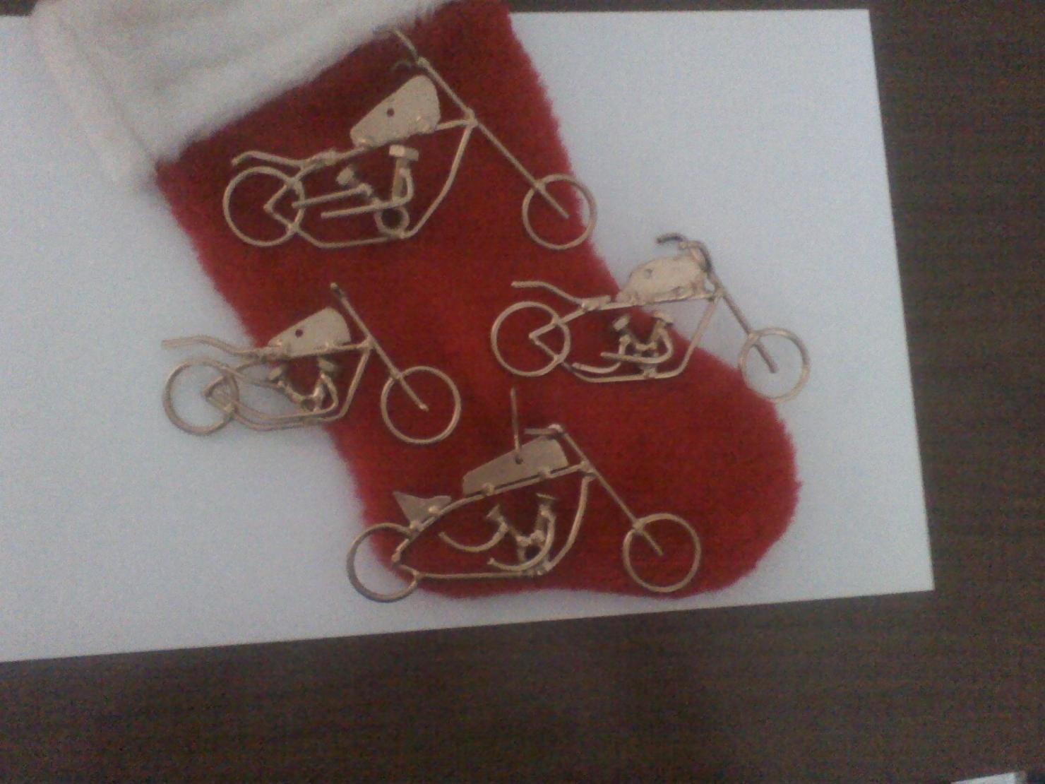

    Thanks ... it was fun to make. There were several reasons I didn't use the Tig welder ... one I needed to use one hand to hold the pieces as I welded them the other is I would use so much gas making them that I would have to raise the price too high ... they only take a few minutes to make the way I do them. They would look a lot cleaner if I tigged them but they would take four times longer ... this way I just whip them out ... boom boom boom ;-)Click image for larger version.
Name:	xmas tree orniments.jpg
ID:	7967 The thing I have to remember is if I use the 22 ga for the tank I need to turn down the power a bit ... I fried one of them lol

    On the bike ornaments, I would maybe try making them on a small copper piece to avoid the sticking from the MIG. Or worth a shot if you have a piece laying around (I know copper is not cheap). Or aluminum?

    I don't have any copper but I need to get some ... esp for when I'm tigging SS sheet metal since I really don't want to set up a secondary argon flow ... I can get some aluminum so I believe I'll do that. I have some spray no stick in a can but it's kind of messy and a little toxic. Regarding the music being up to high in the 200DX video you are absolutely right maybe Ill see if I can fix that ... only thing is the link is out there for the original one and I don't think youtube has a way to replace a new video with the old link.

    I can engrave a date on the tank but I was thinking about instead of sheet metal for the tank just bending some 1/8" in the shape of one would make them look cleaner and speed up the process ... I can add a tag or something ... that is a good suggestion. For my bigger more expensive art pieces I sign and date them with a Dremmel tool.

    Not a bad idea if you remember, some anti-spatter would do it. Or PAM (maybe olive oil) spray. Only mention the olive as I used it for my eggs this AM, but have heard people say it works. There are soap types too.
    My memory is so bad, when I am done with the MIG, I clean (nozzle and top) and spray, so it is on the for the next weld day

    That reminds me ... lol ... I forgot to clean my nozzle yesterday I did however remember to turn off my tank and pull the trigger to drain off the pressure before turning off the machine. There is nothing worse than going out to the shop when you are about to start a big project and see you're low or out of gas.

    Anti-spatter spray helps a lot, depending on the type you do have to clean that off with a chemical).
    A set on MIG pliers are a must, pop in the nozzle if really bad and twist. I use that or wiggle the nozzle off and clean it. I know, you have to stop welding.
    I just saw someone talking about needing a new gun. They are not cheap, one good wack could do it But they are tough, I watch people to it all the time.

    Myself ... I take a bore brush (like you clean a gun barrel with) and clean my nozzle with it then spray a small amount non-stick on it … I use that stuff sparingly … but it works.
