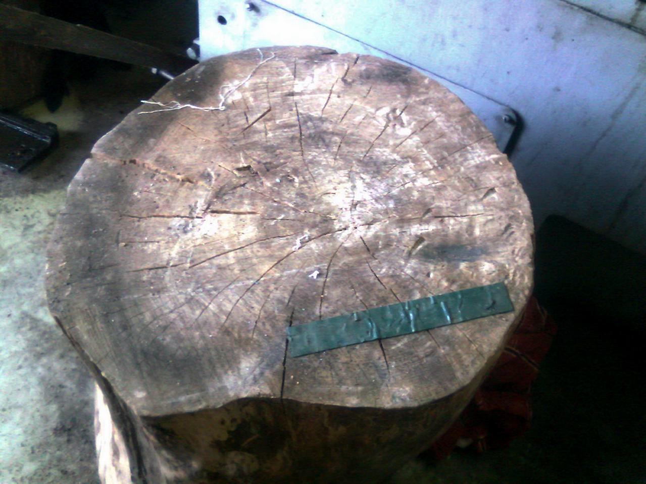

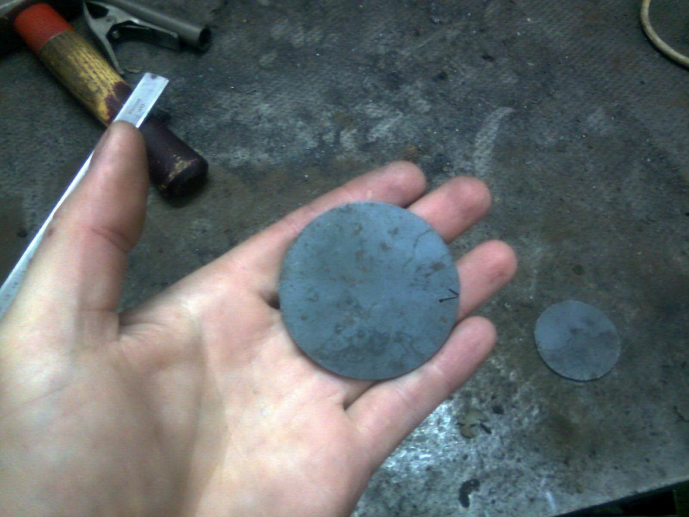

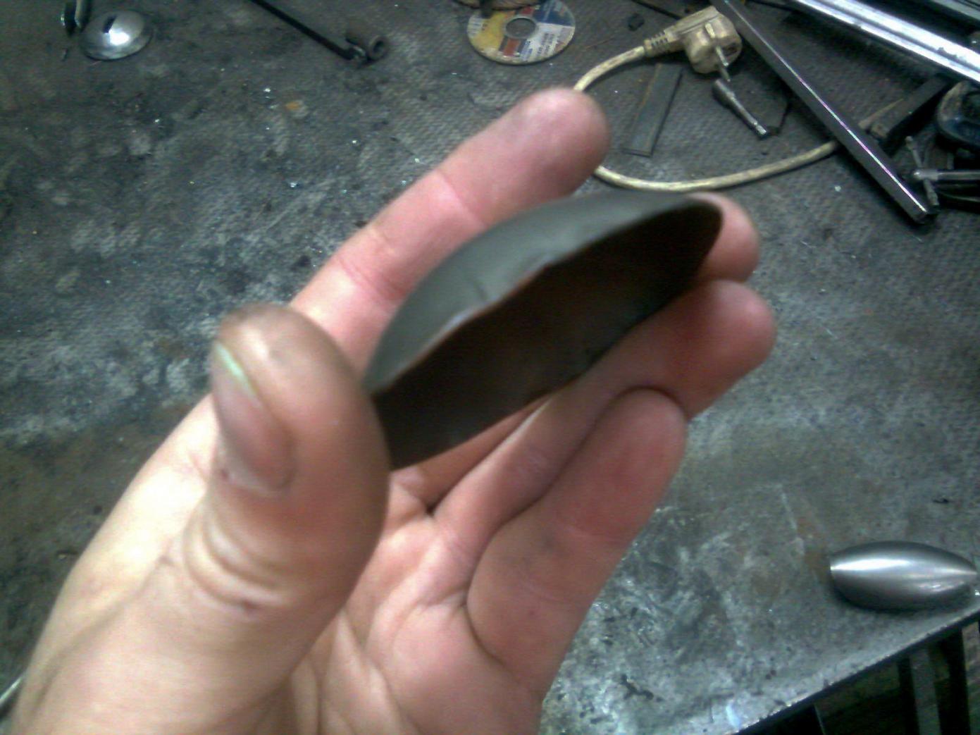

    tank and fenders are made of sheet steel 1-1.2 mm,Click image for larger version.
ID:	7822Click image for larger version.
ID:	7823Click image for larger version.
ID:	7824 forming the right curves on the stump,Click image for larger version.

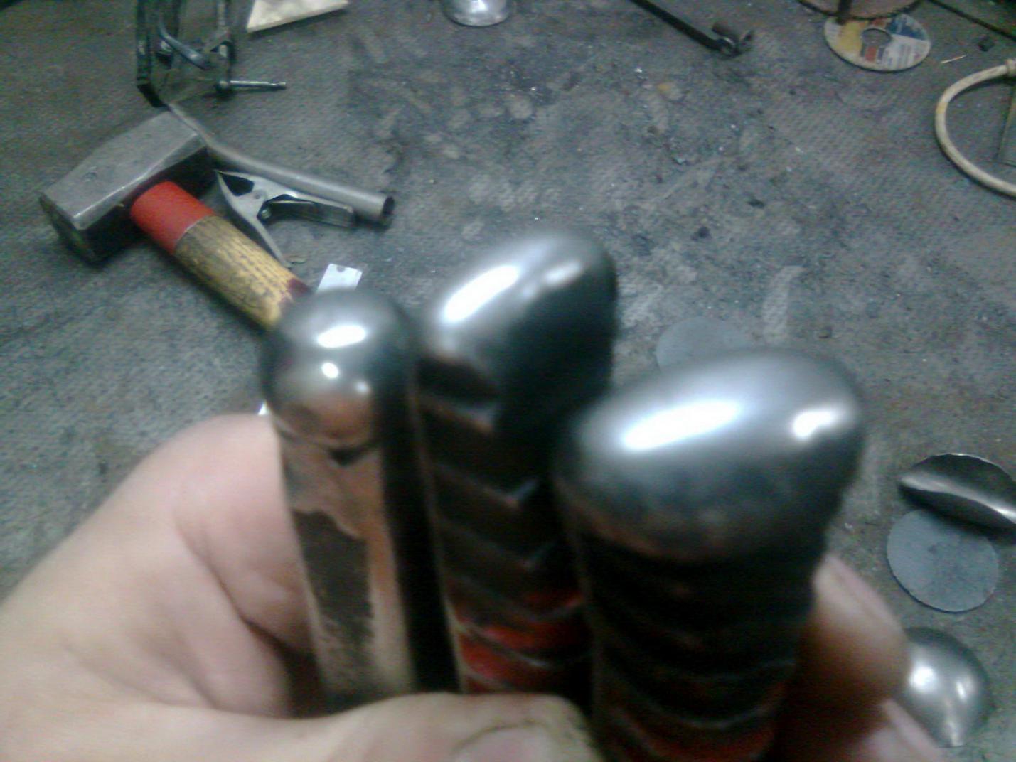

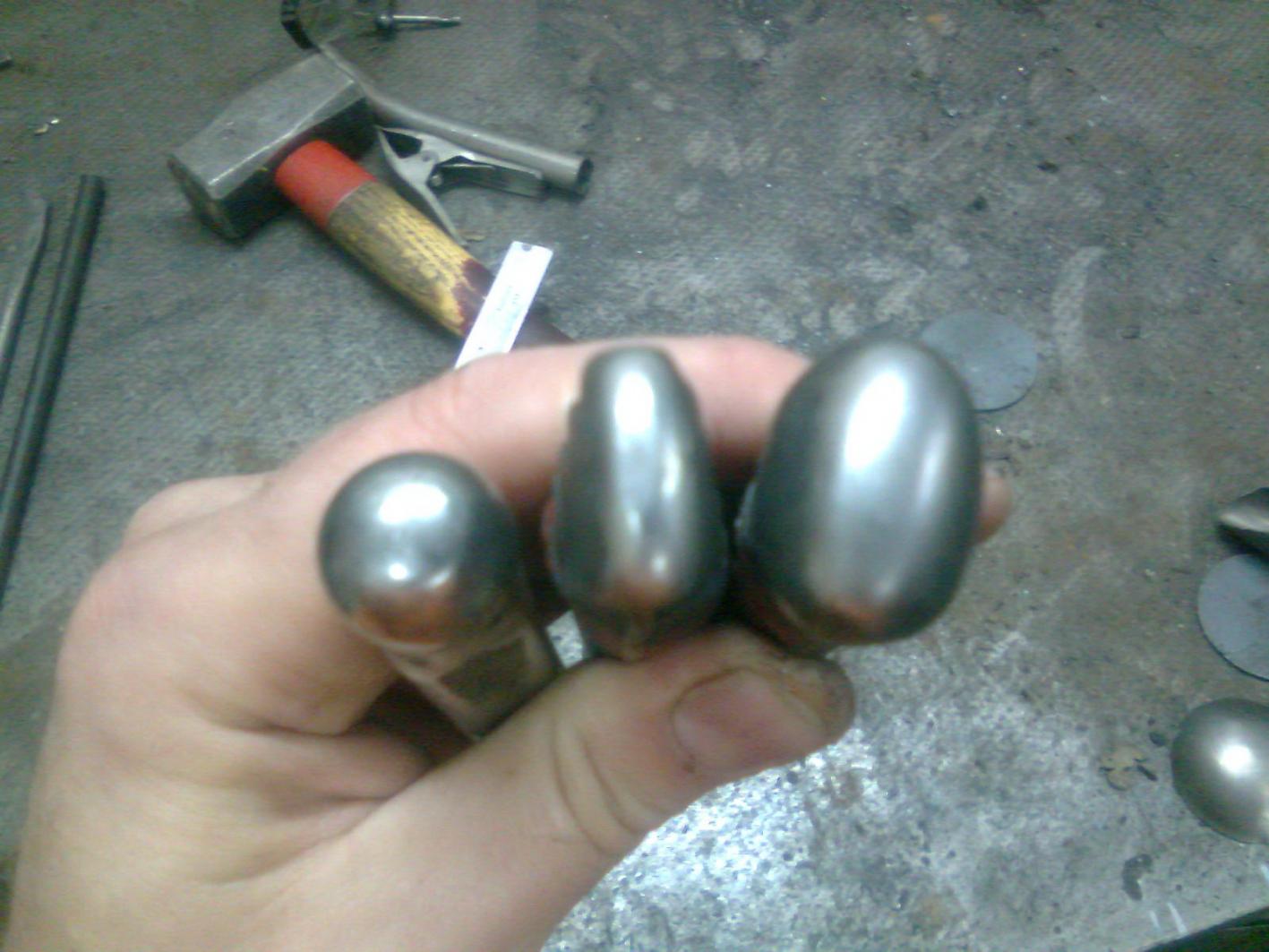

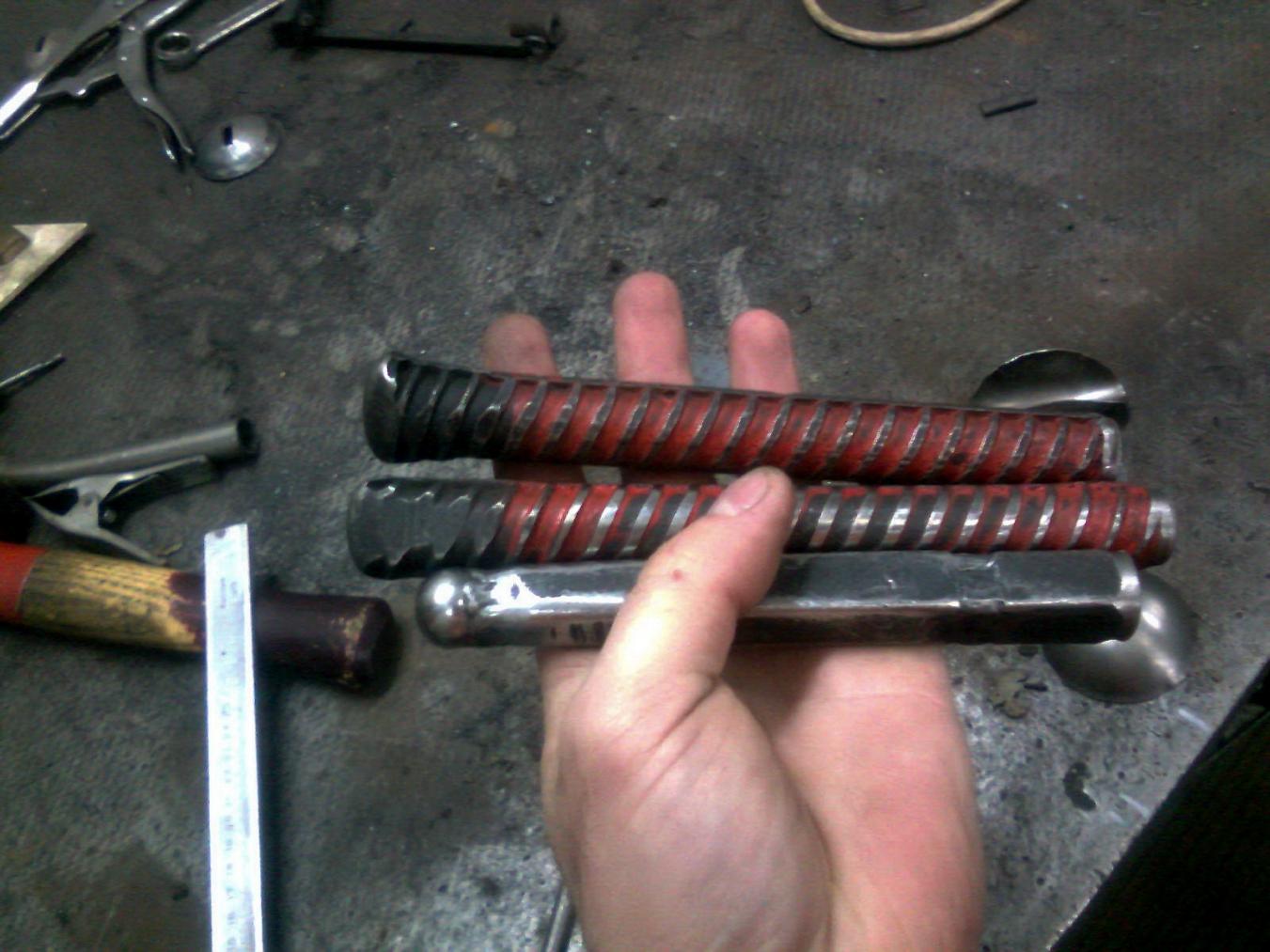

ID:	7825 using tools like theseClick image for larger version.

    offers to sell have already received, but I yet don't sell,i wait until my son will play enough

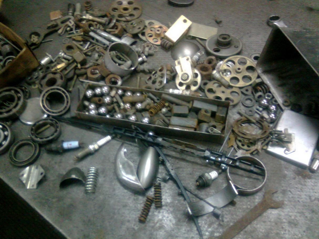

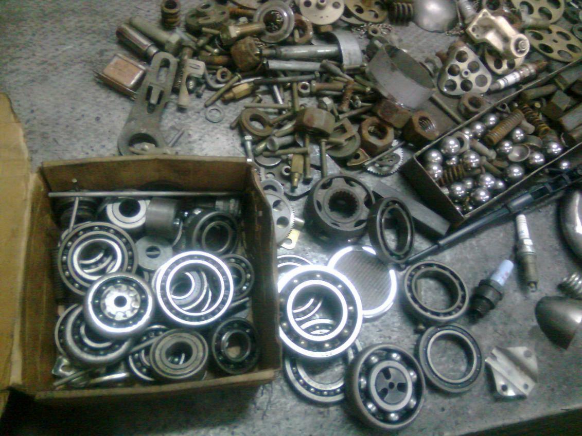

    made of all what it is not necessary Click image for larger version.

    Looks like a great use for old wheel bearings and spark plugs etc.

    I really enjoy sculptures from the scrap heap. Lots of fun to try and identify all the bits and bobs that the artist used.

    the homebrew tools he does it with
    A stump and a couple chunks of rebar. The ability to see the usefulness of those materials is as impressive as the artwork that results.
    The guy that makes the metal fish used a stump, too. The real talent is in the artist, not in the tools.
    Rebar!! That's what it is! I was looking at his tools, knew they were handmade and was trying to figure out where I've seen those before .... LOL. Amazing artistry.
