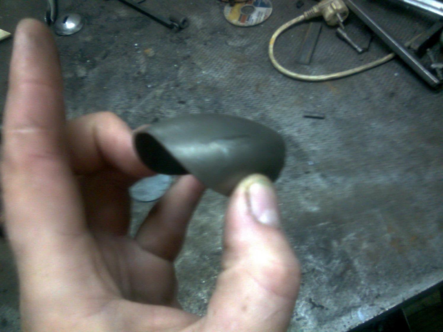

    dimensions
    tank and fenders are made of sheet steel 1-1.2 mm,Click image for larger version.

ID:	7824 forming the right curves on the stump,Click image for larger version.
ID:	7825 using tools like theseClick image for larger version.

    offers to sell have already received, but I yet don't sell,i wait until my son will play enough

    Simply fabulous. I love how you created the tank and the seat. Cute cat too!
