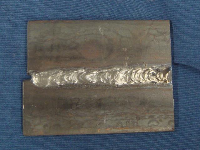

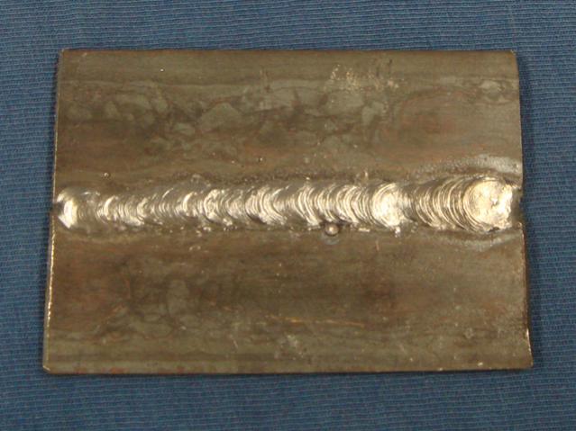

    Still playing with 6011. I can see it's going to take some new techniques. Whip and pause doesn't act like I'm used to, but it does burn in nicely. I want to get some fresh rods to try again.
    Here are a couple more tests:
    6013 on 1/8" plate closed butt joint.

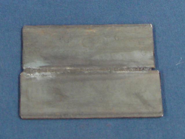

    6013 on 1/8" plate 3/32 open butt joint.
ID:	7810Click image for larger version.

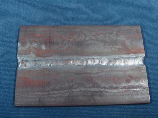

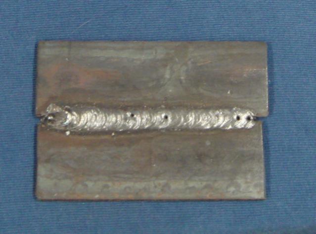

    7018 on 1/8" plate 3/32 open butt joint. Some pitting, but these rods were leftovers from a few months ago and left out. I don't have a rod oven so I just buy these rods when I need some.

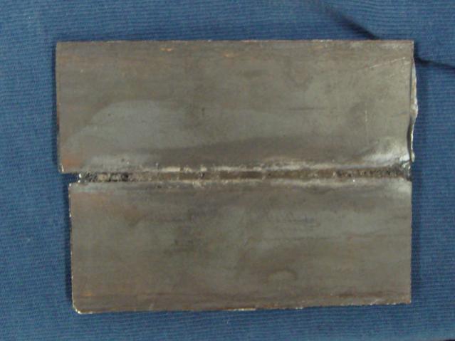

    Here is a TIG test on 1/8" plate 1/16 open butt joint.

    If you've got crummy 6011's you'll get crummy results. Try Lincoln fleetweld 87, or ESAB atom arcs. With inverters, you have an counter intuitve technique that goes against a transformer welder. Hold the arc closer when you need more heat, and the arc force will kick in. Also,the inverter is designed to shut down if too high of voltage is reached by too long of an arc, in order to reduce amp demand from wall and maintain level heat in the circuitry.
    That makes sense. I did notice that it got hotter with a close arc. I've never been a big user of 6010 or 6011 except when I have to burn through a lot of crap. I think these were Lincoln Fleetweld, but probably pretty old. I just wanted to try everything I had around. After a few tries I got pretty good results, but nothing I wanted to photograph, yet.

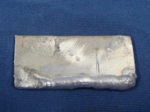

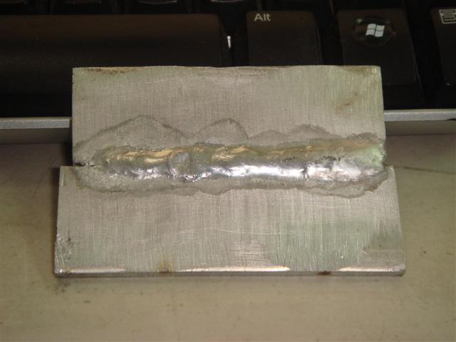

    More to prove it could be done, but not something I ever expect to try again. (unless I have to) Not the nicest looking, but considering how it fought me, I'll take what I can get. And I'm not going to spend time trying to figure out the best way to do this.
    1/8" aluminum tread plate, I think it's 3003. Welded with this little 140ST on DCEP. 4043 filler, 1/8" 2% lanthanated tungsten.

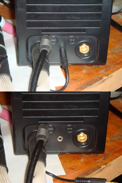

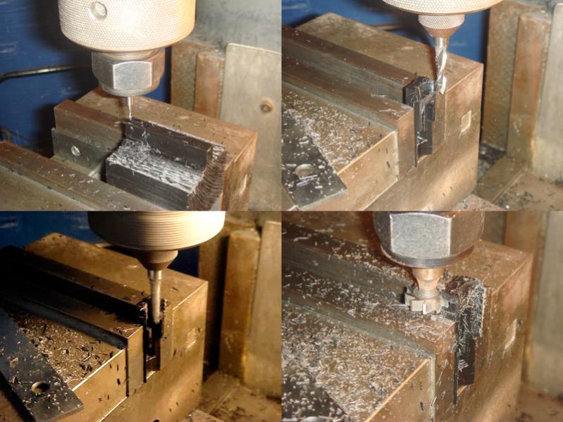

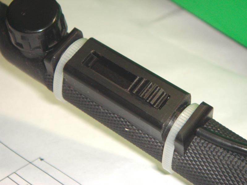

    This is a TIG project, but no welding required, so I figure I'll just stay in this thread. I had an idea to build something like this into the euro torch where the dummy button was, but had to rethink things when it shipped with a different torch. I think I like this better as I am really used to the round handle torches anyway. At first I was going to use a thumbwheel type, but the more I thought about it, the more a linear slide seemed better. I ordered a handfull of different types to see what looked like it would work best.

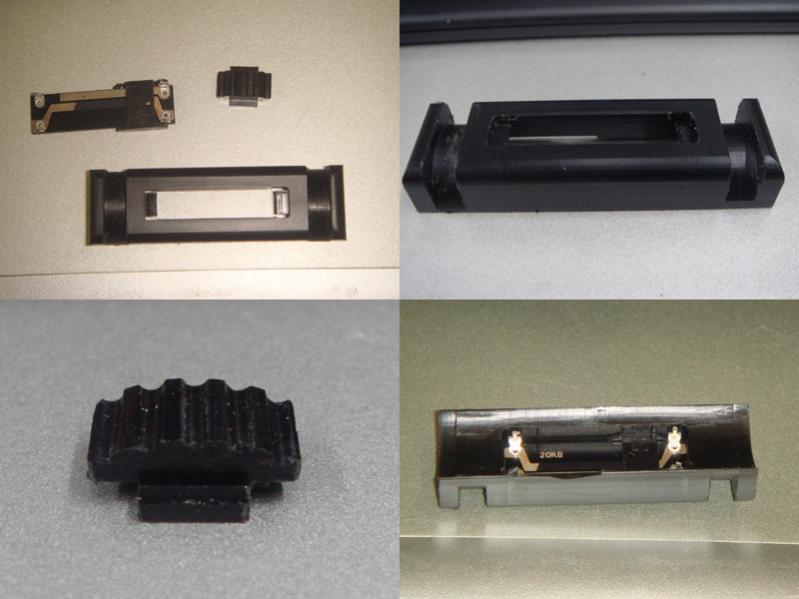

    I made the mounting block from a piece of acetal so it would slide smoothly and be insulated.

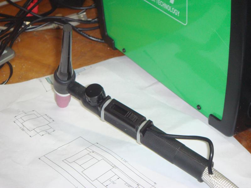

    I also made the sliding piece from the same material. I curved it to fit the torch handle and made a couple of grooves to tiewrap it in place. I wanted to keep it small, so I couldn't think of any better way to mount it.

    Here are the finished parts, and the complete unit.

    All mounted up and the shielded cable is run inside some fiberglass sleeving to protect it and the torch cable. The handle will rotate around the torch for different positions.

    I used a switching audio jack, so the panel control is disabled when you plug in the torch control. I thought about having the panel set the max, but for only a 140 amp welder (85A on 120VAC) I figured this wasn't worth fooling with.

    Presto! Now I can downslope at the end of a weld, or get a little extra heat if I don't have the panel set right. To be honest I've used a foot pedal so much or welders with vague amperage controls, that I really don't know how many amps I weld with. I just know when it's right. I used a Syncrowave once with meters on it, but they only worked when welding, so I never saw them move.
    Very detailed and nice work.
    What cad or cad/cam program did you use and does it tie into the mill (assuming yes)? Where did you buy the 20K slider board (not sure what the 210EXT uses but the all the other pretty much are 47K). Do you weld overhand with it and use the thumb or under and index finger?
    EXT 210 uses 1k.
