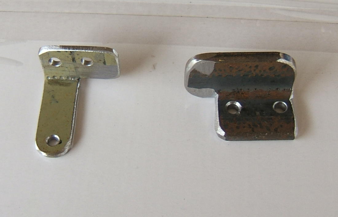

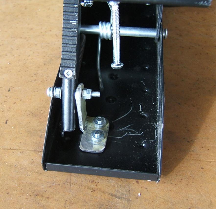

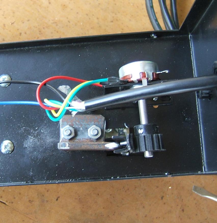

    I did some mods to the foot pedal that came with my PM 256. I read that other guys had probems with the timing belt shaft getting off the pot and not working. See attached pictures. I made 2 brackets on of 1/4" X 1" X 1" angle about 1-1/2" long and the other is 1/8" flat cut to shape and bent to a 90.
    I used 10-32 screws and nuts to hold them on. The 1/4" bracket has a tongue that sticks info the back of the timing belt shaft as a guide.
    Have fun

    Hi acourtjester good idea i took your ideaand brought it up 1 more stage
    the shaft is long and was flexing at the gear i made a nylon block that suports the shaft
    bolted it through the top
    the hole is 1 size over 1/4"
    now it will not dut exesive wear at reastat
    thanks for sparking an idea
    Jim

    Update on Pedal Mod
    after trying it it worked better with nylon block and acourtjester's mod but it still skipped
    after watching the action of the belt had a cam style action
    i took a small spring and bent it to go over the lower belt screw and to the box aprox
    1/2" from the bottom with a 6/32" machine screw
    this light spring keeps it in contact with gear
    spring came from Home Depot tn a package of mixed springs its about 3/16" x 2"

    I've got one of the first Everlast Super200P's. I do remember making some mods to the footpedal.
    Mine arrived a bit torqued, (maybe from shipping maybe was put together that way.) The main thing I did was fix that, so the frame was square, and I removed some play in the hinge (I added some bronze bushings on each side.) I got the toothed rack nice and square, and tight with the pot gear also, so that should work well for a long time.
    Also I used a multimeter, to test the range of the min (which is when the microswitch engages) to max, when the footpedal maxes out, and I made some adjustments that extend the range. I can weld with the footpedal as low as 10 amps. I think pressed down, I get pretty close to 200 amps, just a bit under. My footpedal is made of steel, and has a knob on the side. Its held up well.
