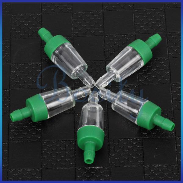

    these work good inline plastic check valves . i use these for my hydrogen generators when i made them http://www.ebay.com/itm/Aquarium-Ant...item4cfcbc8550Click image for larger version.

    Cheap but not sure they're going to match the color of my new welder.

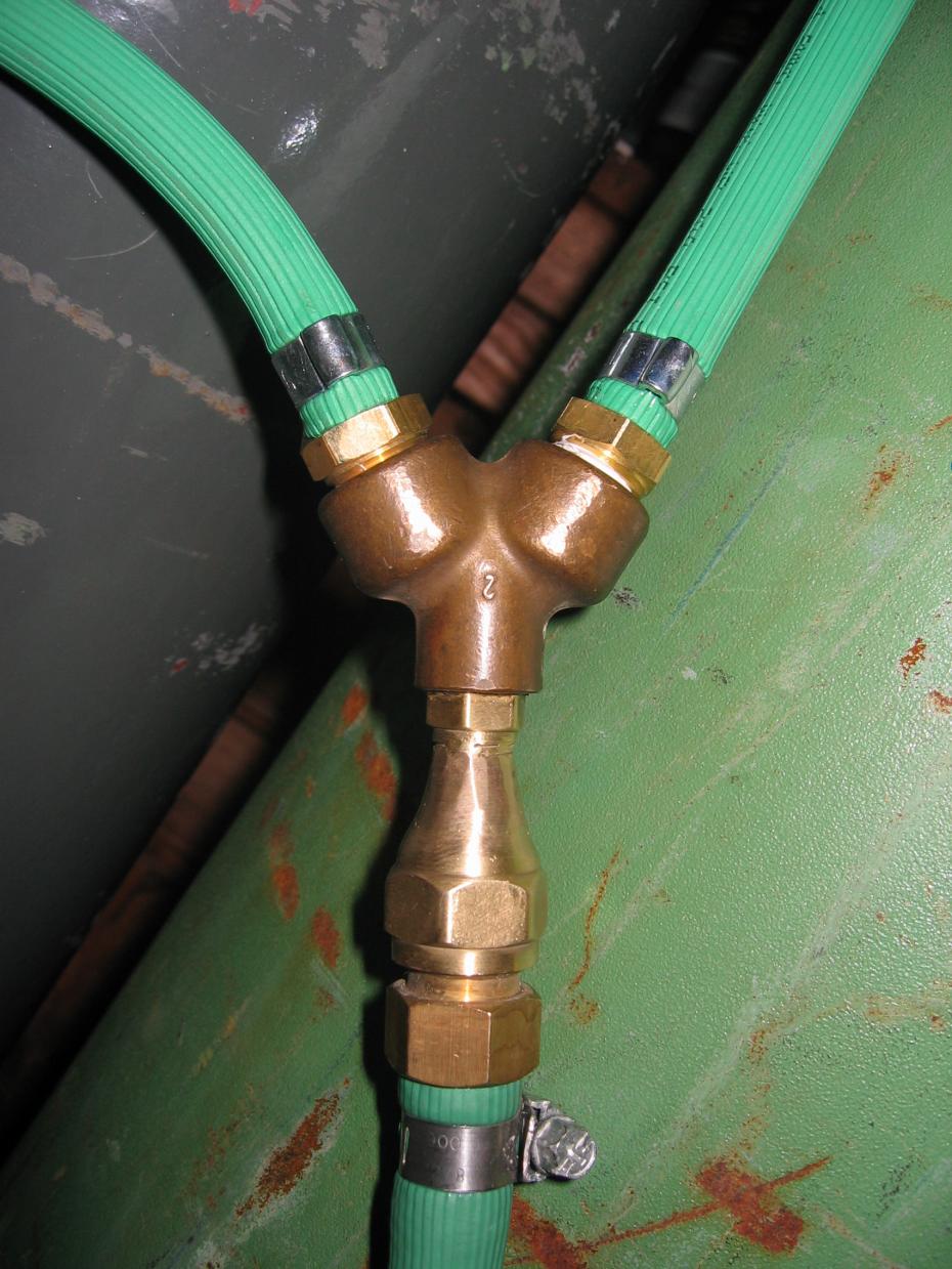

    I have a He-Ar "Y" setup without the checkvalves, and haven't experienced any problems.
    Get two flowmeters that have compatible output pressures (e.g. the same pressure ideally... and one simple way to ensure this is to use two identical brand & model flowmeters), and also close off the tank valves when they are not in use, and you should be fine without them.
    Here's some pictures of my setup: (apologies for double-posting, the time limit for editing the last post seems to be awfully short!)

    I made up the lower brass fitting shown in the following picture by TIG welding:

    I believe it's just a precautionary measure to prevent reverse flow damage to the regulators when the welder's electric solenoid valve is closed.
    Rod - a plastic Y fitting like you've shown I'm sure would work in a pinch provided you got one with the right diameters, but for durability I'd recommend stainless or brass.
    On mine I set it up with a threaded fitting that is the same as on the outlets of my flowmeters, so I can unscrew the hose connecting to the machine, and connect it directly to a flowmeter if I want to remove the Y. Then the removed Y stored compactly, and doesn't waste much hose, since it only has dedicated for its purposes two short lengths of hose, rather than a third longer hose.
    As for why Jody uses check valves in his, I believe he told me in an e-mail response to this question (when I asked him a while back) that he did it to prevent losing gas if he forgot to turn off a cylinder valve (which apparently happened to him once over a weekend, and cost him a lot of expensive Helium that he had manifolded together with multiple cylinders.)

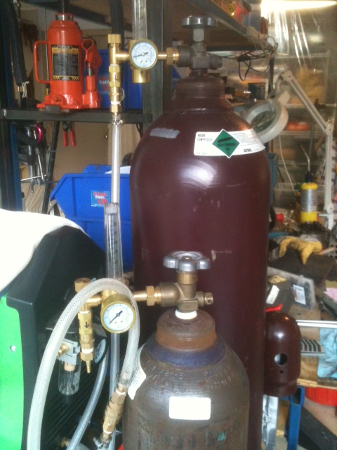

    Quick update about the check valves... Sure enough, the Y connector was the wrong gender (despite calling and being assured it was compatible for my purposes). No problem, they're good about returning things and the correct one is on it's way. Aside from that, I ordered 2 of the following flow meters and I like them a lot. Really good price and an added bonus is that the check valves shown in the previous post fit directly to the flow meter. That saves a couple connectors. Just waiting for the Y connector now. When it's all rigged up, I'll post a pic and links to all the correct parts that make it work.

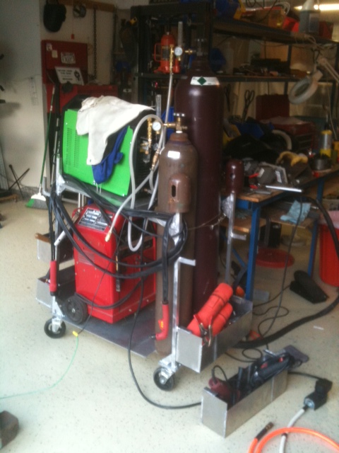

    Here's a pic of those HTP regulators (mentioned in this thread) and the check valves (also mentioned earlier). The check valves fit the outlet (9/16" / 18 TPI) and the barbed coupler fits the check valves. Still waiting for the Y connector....
    And just for grins, here's a pic of the finished cart with 2 more toolboxes added on the back. They're removable and hang on hooks. The cart serves me well so far.
