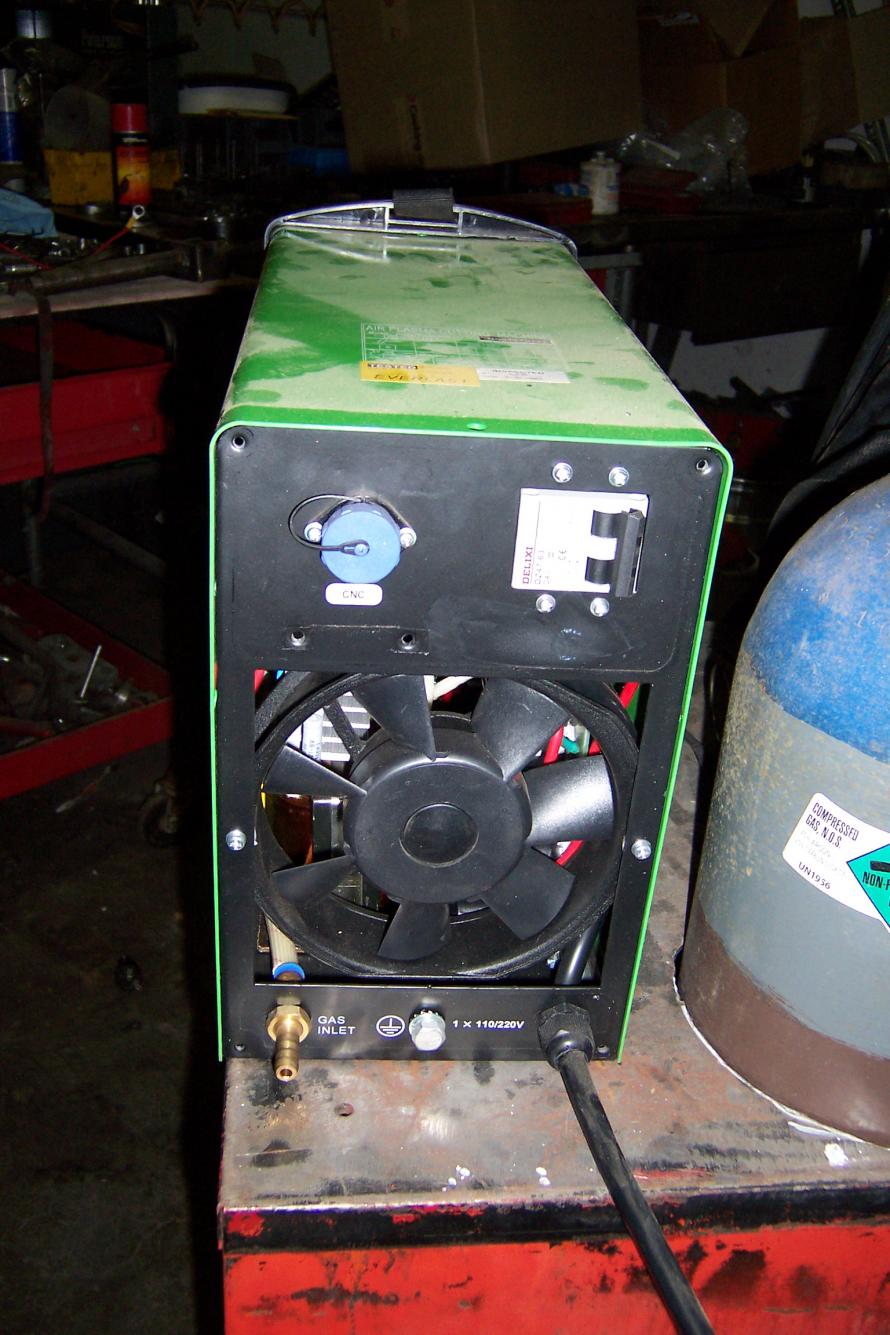

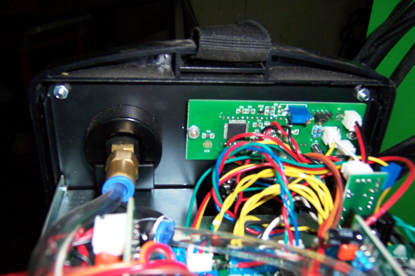

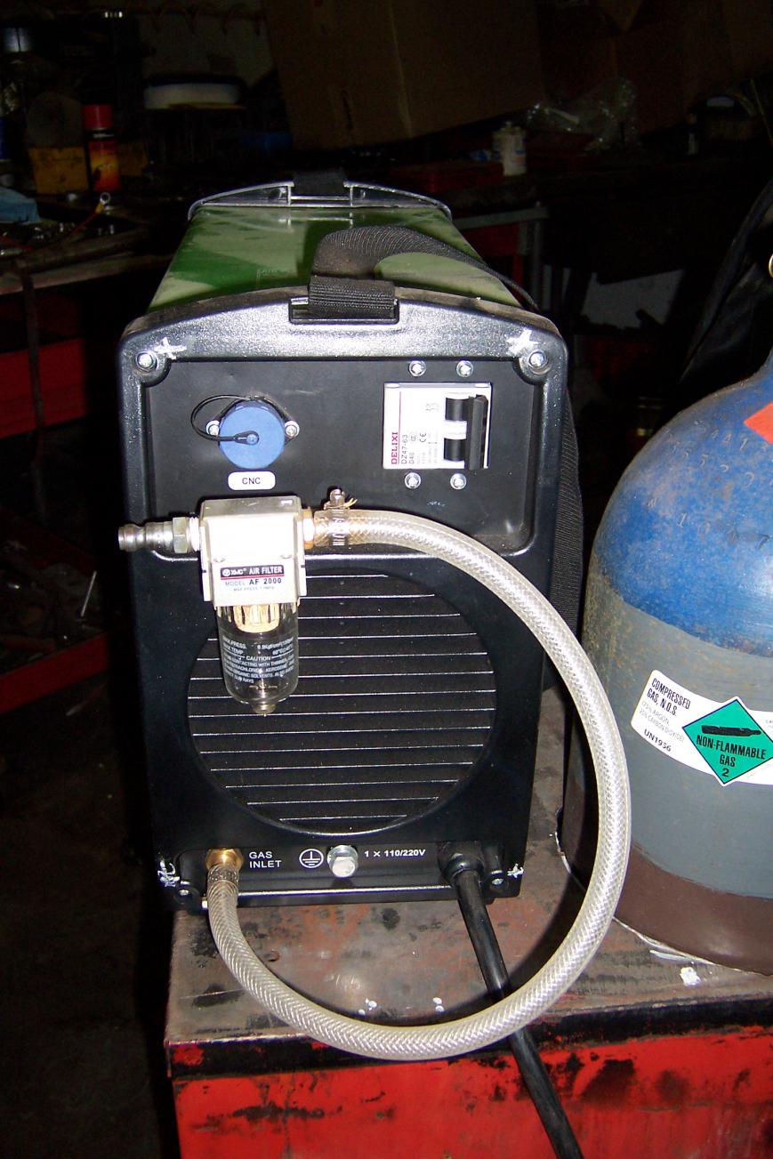

    Ok do my front bezel was damaged during shipping, so I was going to take it off to check for more damage. I can't seem to
    Get it off for some reason. It's a pp50 ...help!

ID:	7733ok did you remove back cover first , after removing remove cent cover screws slide back center metal cover it will lift off have to remove back and center cover to get front of since has small nuts on front screws
    Wow, I knew there was nuts on those screws lol! Thanks a lot brother!
