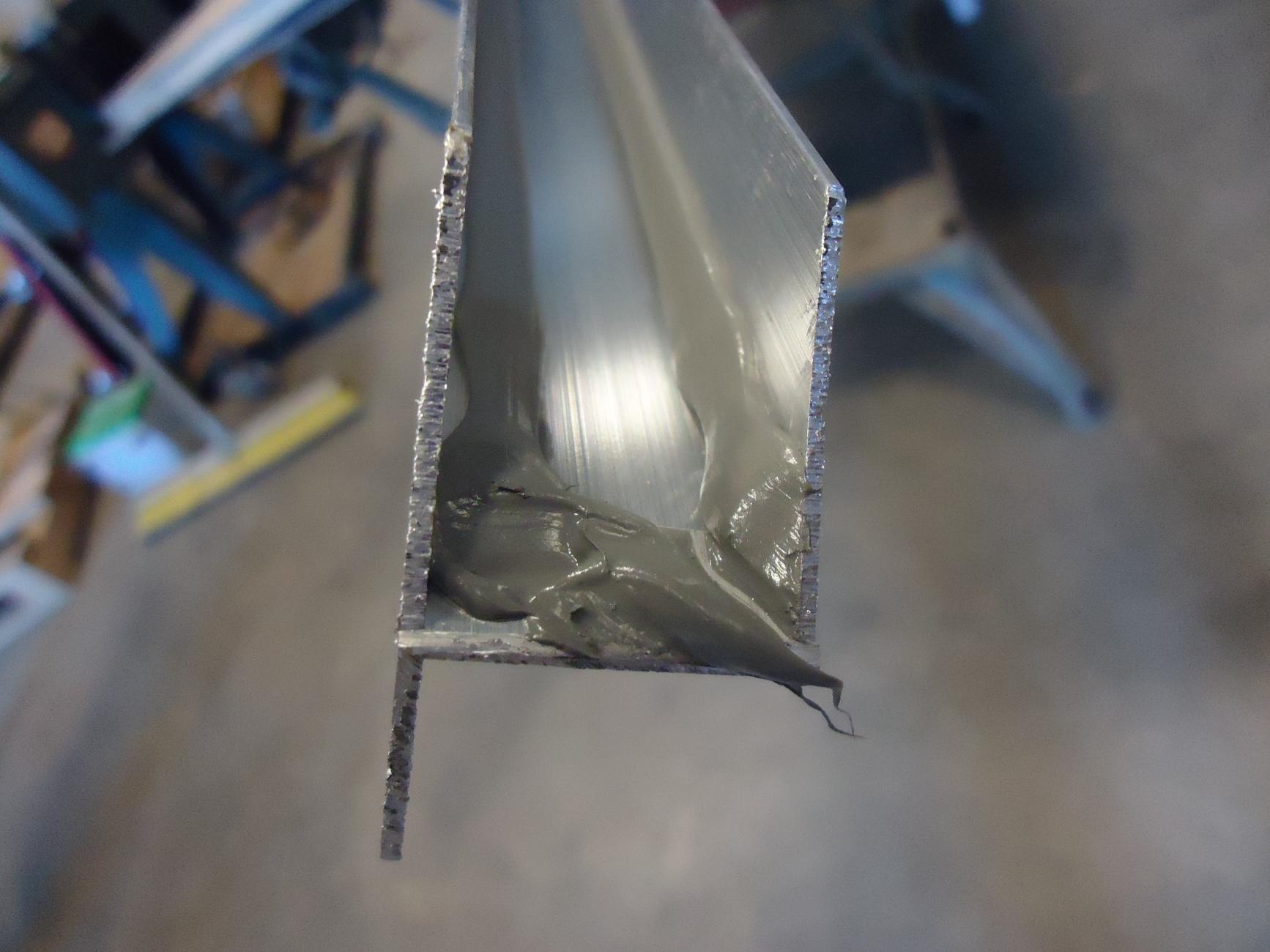

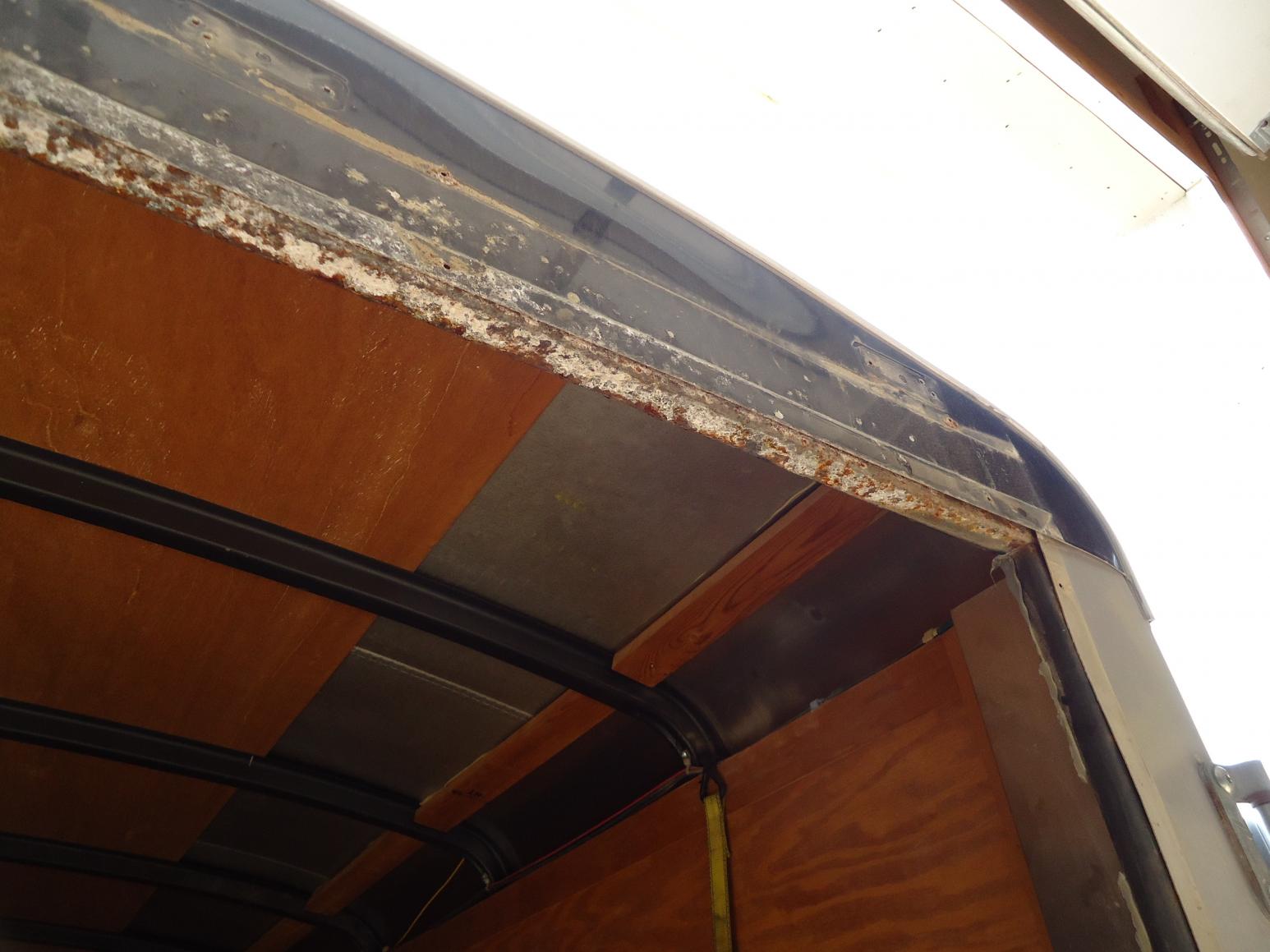

    Here is something i need to do before the weather changes, Our mule is too tall to go inside the trailer.We need 2.5" now to get the mule in but will add as i have room for.Looks like there is enough in the rear header above the door to add about 4" or so to the opening height.I removed the doors and trim this afternoon and will cut out the old header and add a new one.Will try to get this done this week.The rear aluminum trim was all screwed around the rear opening ,as you can see they used no sealant and the corrosion has started to eat away, I plan on putting on new door skins when the doors are made larger and maybe a new rear skin also . Here are some pics of the problem and possible remedy.

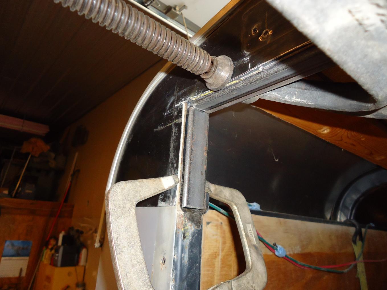

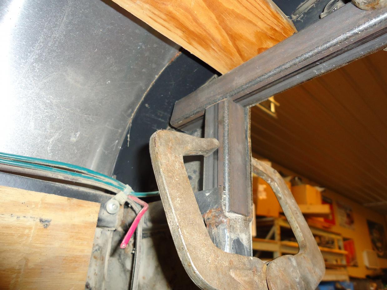

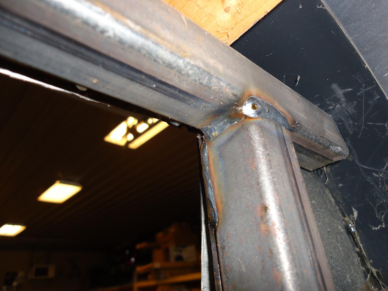

    Got the opening cut this morning , Used a saw to keep sparks from getting behind the walls, Added a new brace and upright to the inside of the header out of 1" 11ga square tubing, Will get that welded up and add a gusset on each side and put on the trim and start on the new doors.

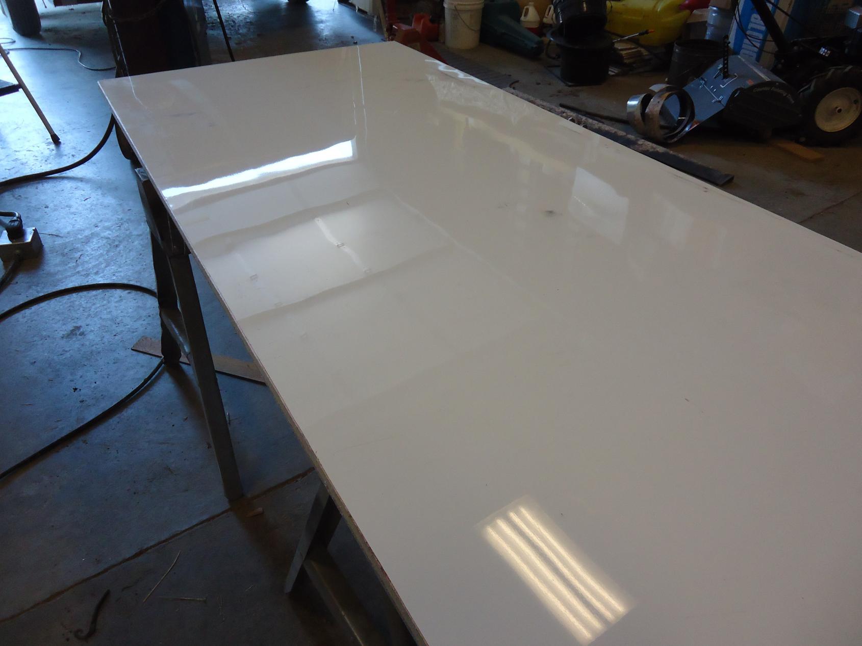

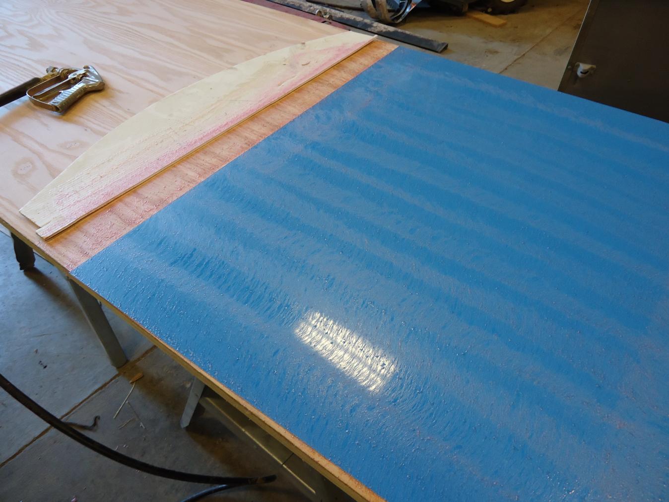

    Here is all the progress for the day, A couple of pics of the doors being laminated with plywood and the inside lower aluminum skin and the outside skin, Door material is 18mm 11 ply hardwood plywood with a 6mm plywood laminate inside ,Aluminum skin was .90mm .They are of to paint the matching silver and get installed in the morning.Fedex should have my new door trim by Thursday afternoon to finish up.Will add some new clearance lights and the drip rail to the header in the morning.

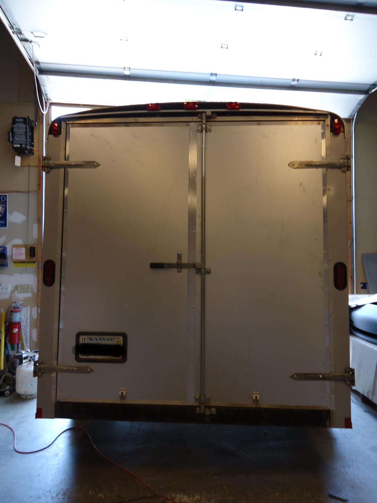

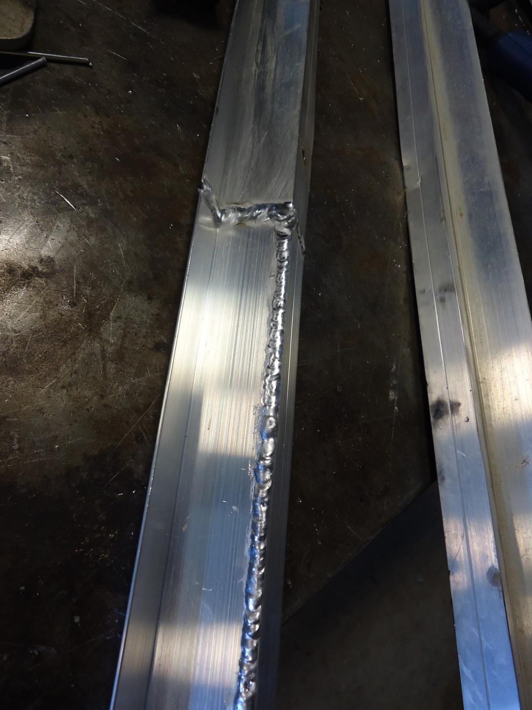

    Here it is all back together , i had to order new extrusions for the door edges and trailer sides, they came in this morning so i finished up the doors ,Reinstalled them added some new clearance lights and we are ready,I did have to use the Power Tig 185 ,The z channel that came was the wrong size so i cut up some .050 aluminum and made my own extensions for the door opening.They were a little pain to weld the 7 year old material to the new but it worked out.All the door edging and trailer trim is now sealed to keep moisture from getting in.Here are a couple of pictures.Click image for larger version.

    Thought i would load up and see how much room i have now cleared by 1 3/4" . Now i can make those 6-7 hour drives in the fall and winter and not have to worry about rain and snow and all the salt spray getting all over everything.Not to bad on price a little over $200.00 in material with the plywood aluminum skin and the extrusions i had to order.Saves buying a new trailer.Click image for larger version.
