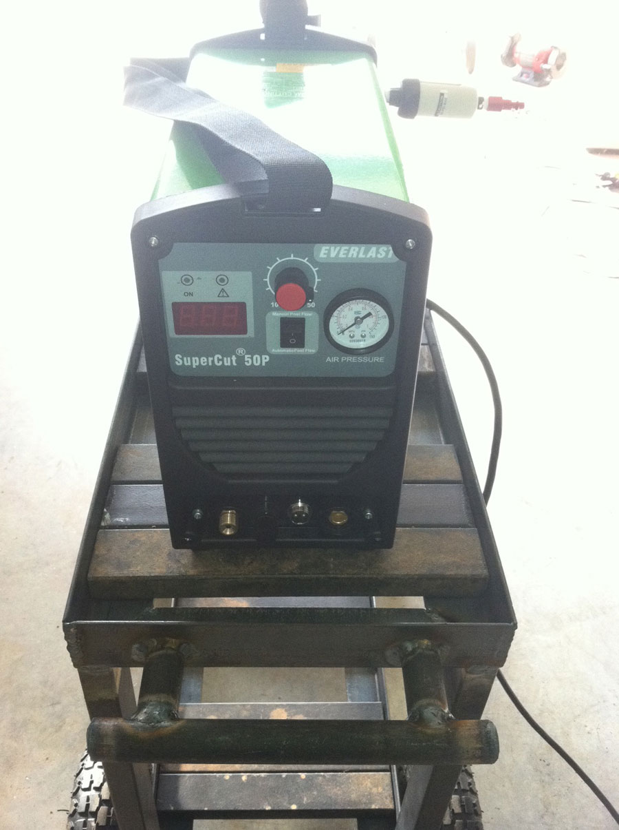

    Ok need a little input. I FINALLY have everything together to start the build (I think - 2" angle). But I want to run these numbers by everyone to get some input on the size.
    I was planning on going with a 1'x3' wide base. I am basing this off the measurements for a 200DX = 20.2Lx8.6Wx15.5H in. or if I were the lucky 1st place I would go with a 210ext at 19.3Lx9.5Wx18.5H in. (is that height correct???)
    Based on the height and the 2" lip I was planing on putting the top at 24" That would give me enough room for a 3.5" drawer in the future. The wheels sit approx 6" off the ground... So the top would be at approx 30" from the floor.....
    However I was thinking, since I will be putting my plasma cutter on here maybe I should go with a 3 level... I would need to put the second level at 20" high and do away with the drawer idea.... The add a top at 16" above the second (Supercut 50P is 11.5" tall). That would give me a top at approx 42" high.
    Also should I make it 4 wheel or 2 wheel and legs on the front....
    Any thoughts???

    Another option is to go wider and do the side by side setup. A lot depends on where you will park it, does it need to fit under something, what size and number of gas bottles, cable/torch lengths, etc. One thing I've always liked to have mounted on a welding cart is a small Halon fire extinguisher.

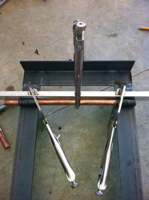

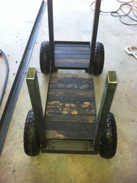

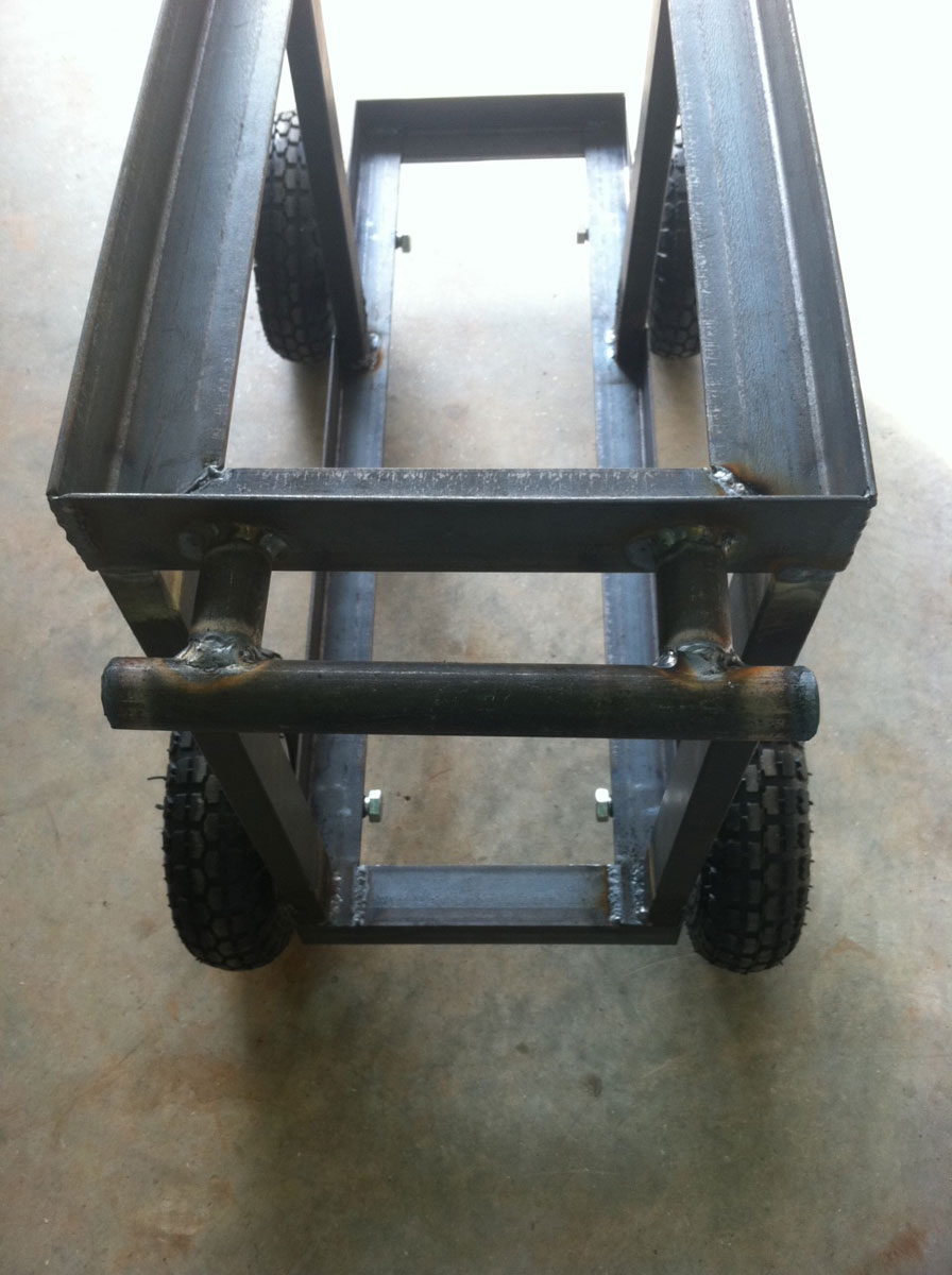

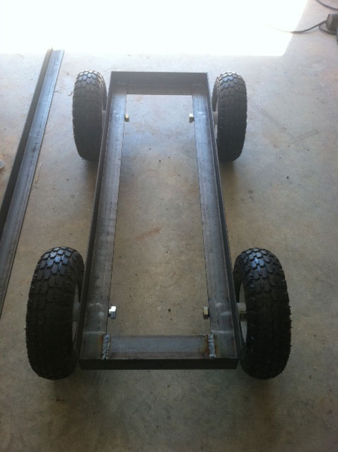

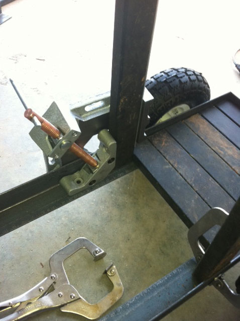

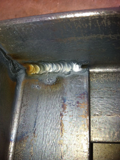

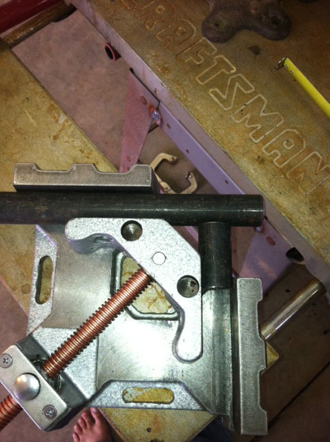

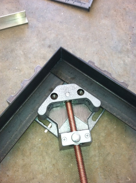

    Well yesterday and today I broke bad and built my welding cart. My wife was a little pissed as I put off having an appraisal done today so I could get this done. Refinancing the house to lower the interest rate.
    I used my PA140ST in TIG mode. I was using a 3/32 2% thoriated with a #5 cap. Amperage was 100 - 120. Filler rod was a 1/16 ER70S2. The metal used was 2x2 1/8 angle, 1x2 1/16 box, and .50" black iron tubing and 2" nipples. Wheels are Harbor freight 10" $4 tires. Bolts (axles) are 5/8 x 5". I also used my Strong Hand WAC35D. It made the build a lot easier.
    I ended up building it 1x3 and the space between the top and bottom is 20" . The back area for the bottle is 1x1 so It can hold a 330.

    I left the 1x2 flooring loose for now. I may tack it later.. The hardest part was putting on the handle. Well actually tacking it. Had I had a mig it would have been easy, with a tig it was a little tricky. Now I have to decide on the paint.... I am thinking GREEN would look nice. Oh and I need a nice new welder to put on the bottom.
    Back to work on the house... before my wife beats me.
