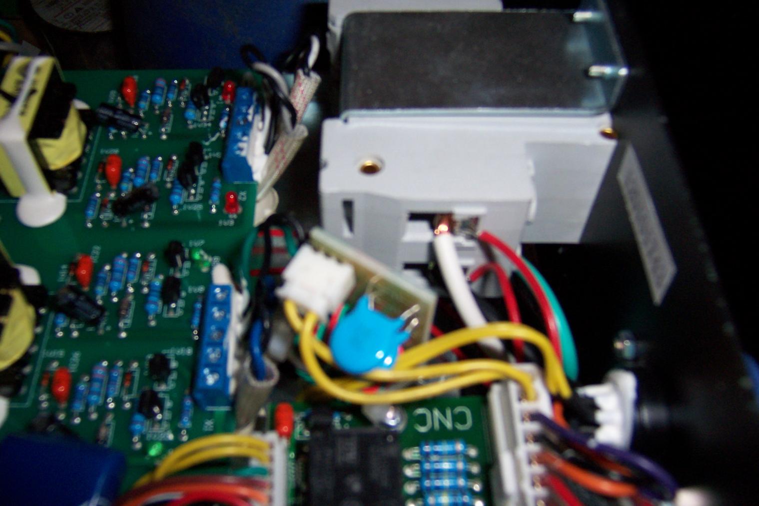

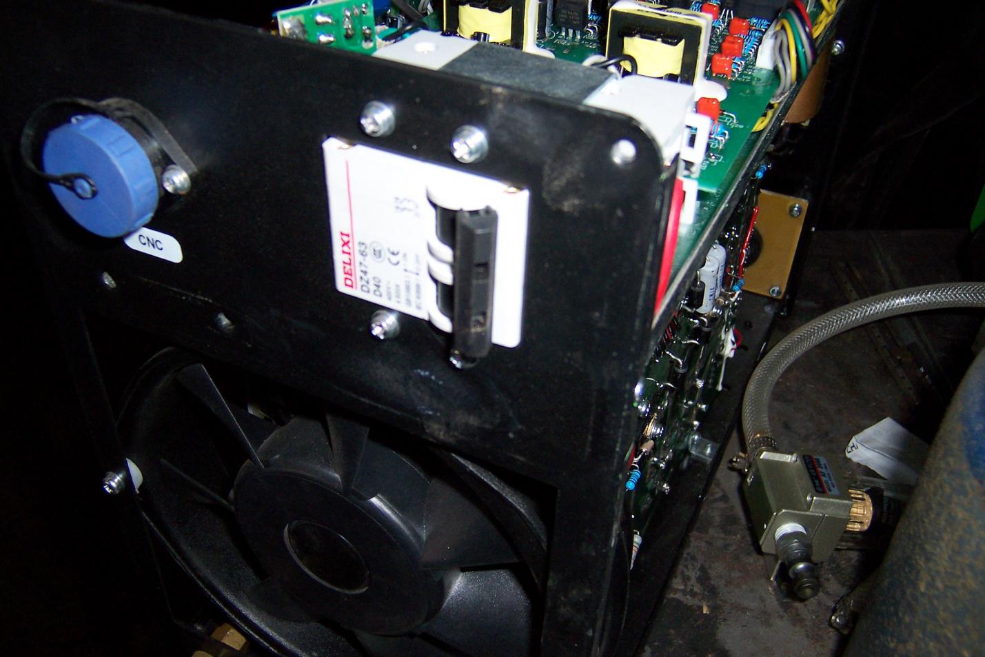

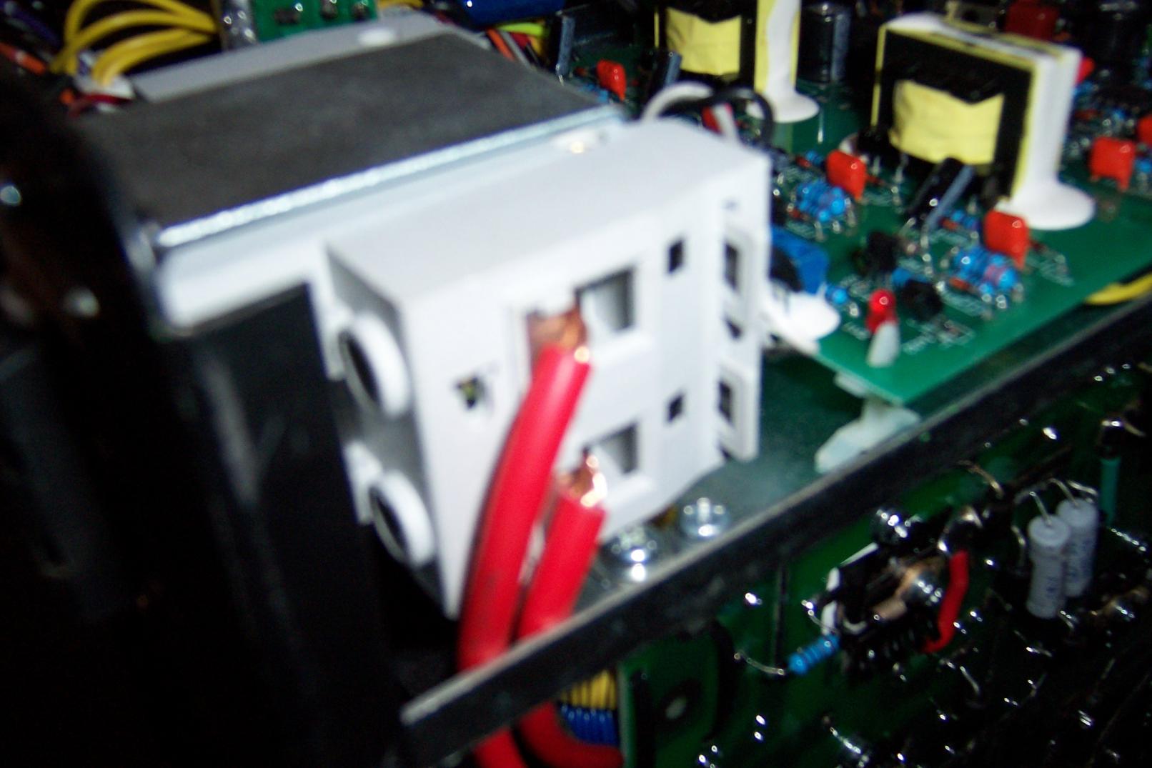

    Have you pulled the cover and checked the on and off switch with a volt meter to see if getting 240 volts . have seen a couple of posts on pad switches , if only one pole is working on switch machine will not work rite . i just had my cover off to show a person on the site how to open up pp50 Click image for larger version.
Name:	86 truck 001.jpg
ID:	7745Click image for larger version.
Name:	86 truck 002.jpg
ID:	7746Click image for larger version.
Name:	86 truck 003.jpg
ID:	7747and noticed my wires on switch was not tight the white one pulled rite loose when i lightly pulled on it
