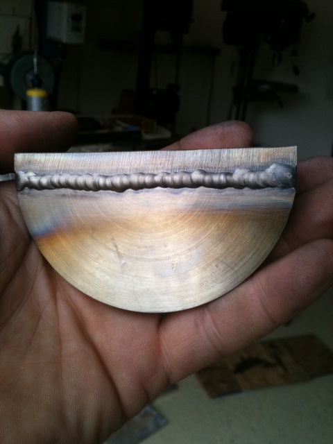

    PS: Can you tell I just did my first practice TIG welds on SS this weekend? Here's are some pictures. The semi-circular piece was the very first attempt. Figure-8 on the inside seam and standard pause/push bead on the backside. The other plate was experimenting by cutting the plate into many pieces and welding it all back together using different heats, filler size, etc. After that, I cut it up to inspect penetration and did some bending to test. All welds had full penetration and the piece only bent when clamped in a vise and manhandled with a 24" crescent wrench. BTW: the SS is unknown type and I used 308L filler. The pieces are 4" diameter between 3/8 and 1/8" thick.
    Anyhow, back related to this thread, after welding those pieces, it doesn't seem they will ever return to the bright shiny chrome appearance they first had.
    They will if you pickle them. They may require polishing if you need a reflective surface but it'll put it back to matt.

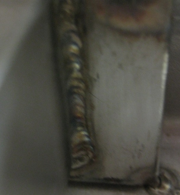

    Here's a few stainless pics showing some typical defects. These were from a pretty good environment for stainless (washdown, occasional passivation), if it was brine or marine they'd be a lot worse.
    Typical pickled weld @ 10 years service. A bit of black oxide remains (pickling won't work well on that) and there's a spot down at the bottom where the colour was never scrubbed off. Also you'll see a slightly gray haze at the edge of the HAZ, which is typical:

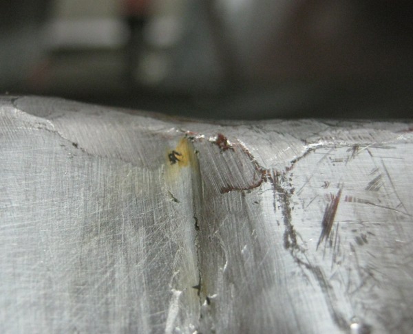

    Sugaring causing crevices. This is one big problem with sugaring; it creates a pit that can't be ground out without going deep into the weld. This weld was ground and pickled.

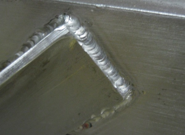

    Incomplete penetration causing a crevice (butt weld, ground and pickled, #18 gauge, back side):

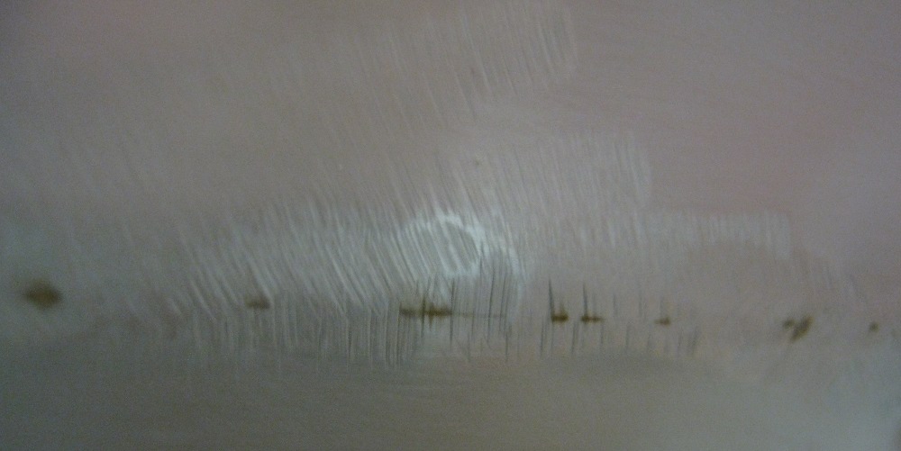

    Contamination. Weld was originally wire wheeled with a steel wire wheel. The weld was then immediately pickled, but the area above the weld wasn't. This defect has been passivated many times, but continues to rust. (I think it's the rust pits from the original defect.) I don't have a picture of grinding contamination caused by grinding steel in the vicinity of stainless, but it's similar. **Do not grind steel near stainless or you will contaminate your stainless with embedded steel**
