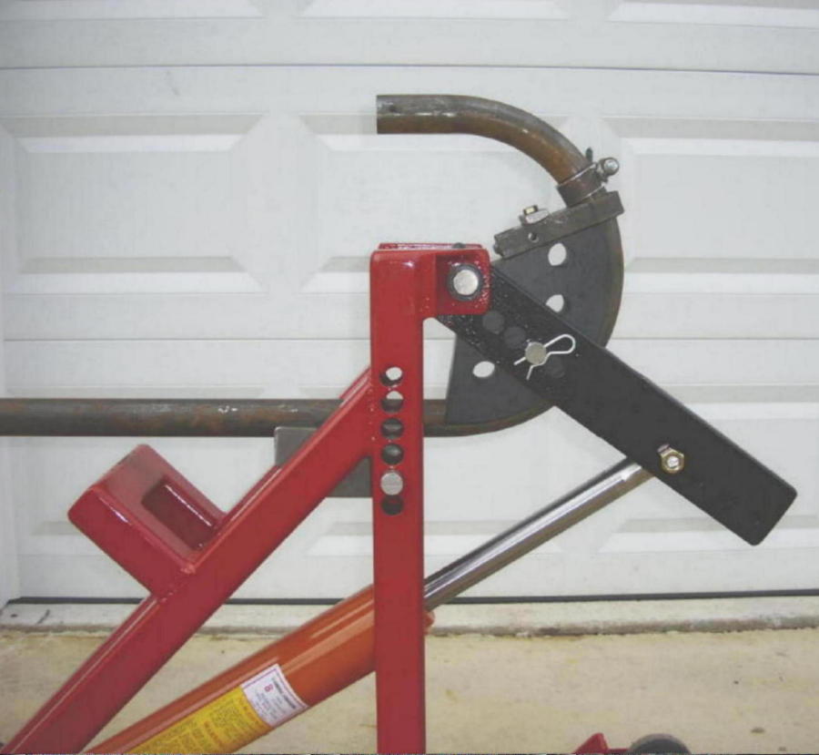

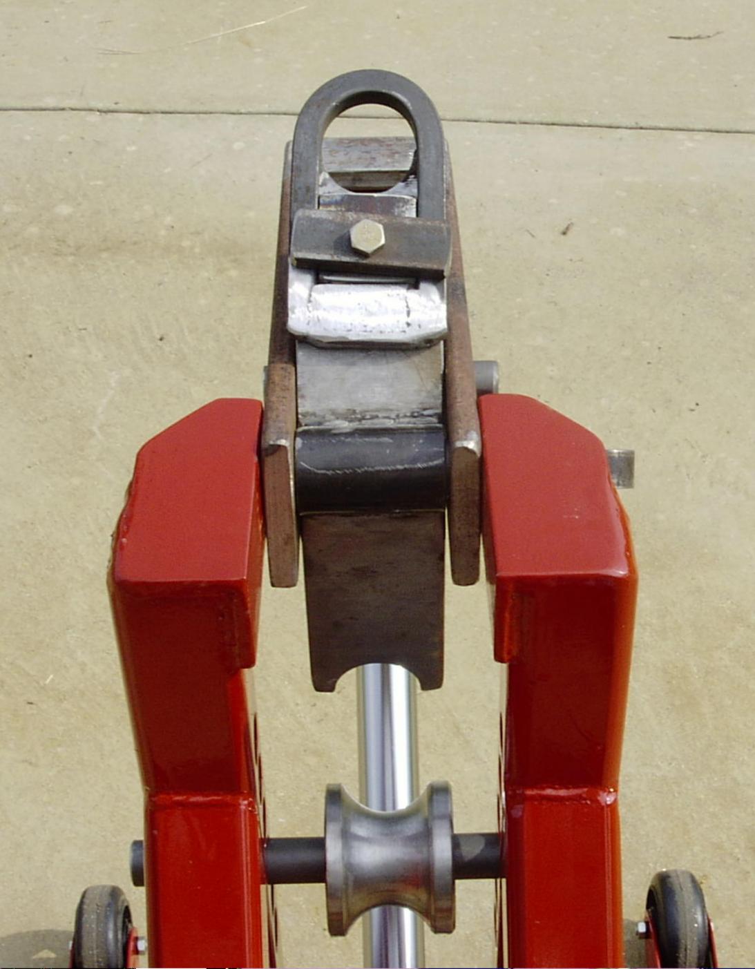

    You will be very happy with that bender I built 2 years ago (sold the first one changed to air/hydraulic on #2). Being mobile is a great plus wiht Franks bender.
    I replaced the slide block with a roller.
    have fun

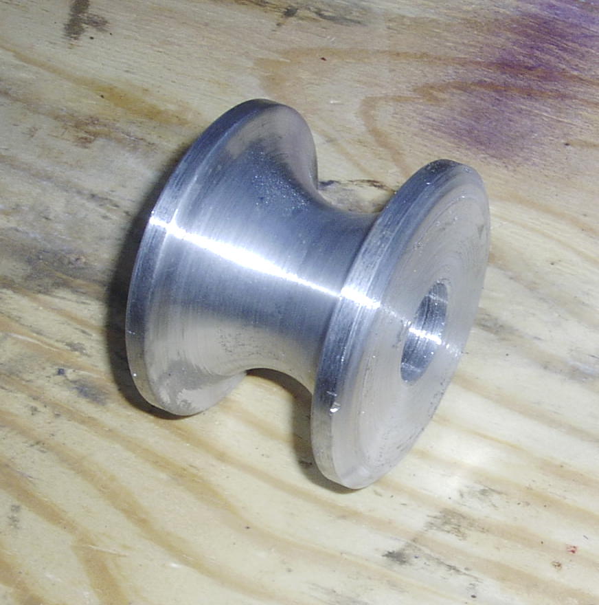

    Where did you get the roller?
    little shop behind my home (DIY roller) I machined it. I also modified the 90 degree die so I could bend over 90 with it as shown in the picture.
