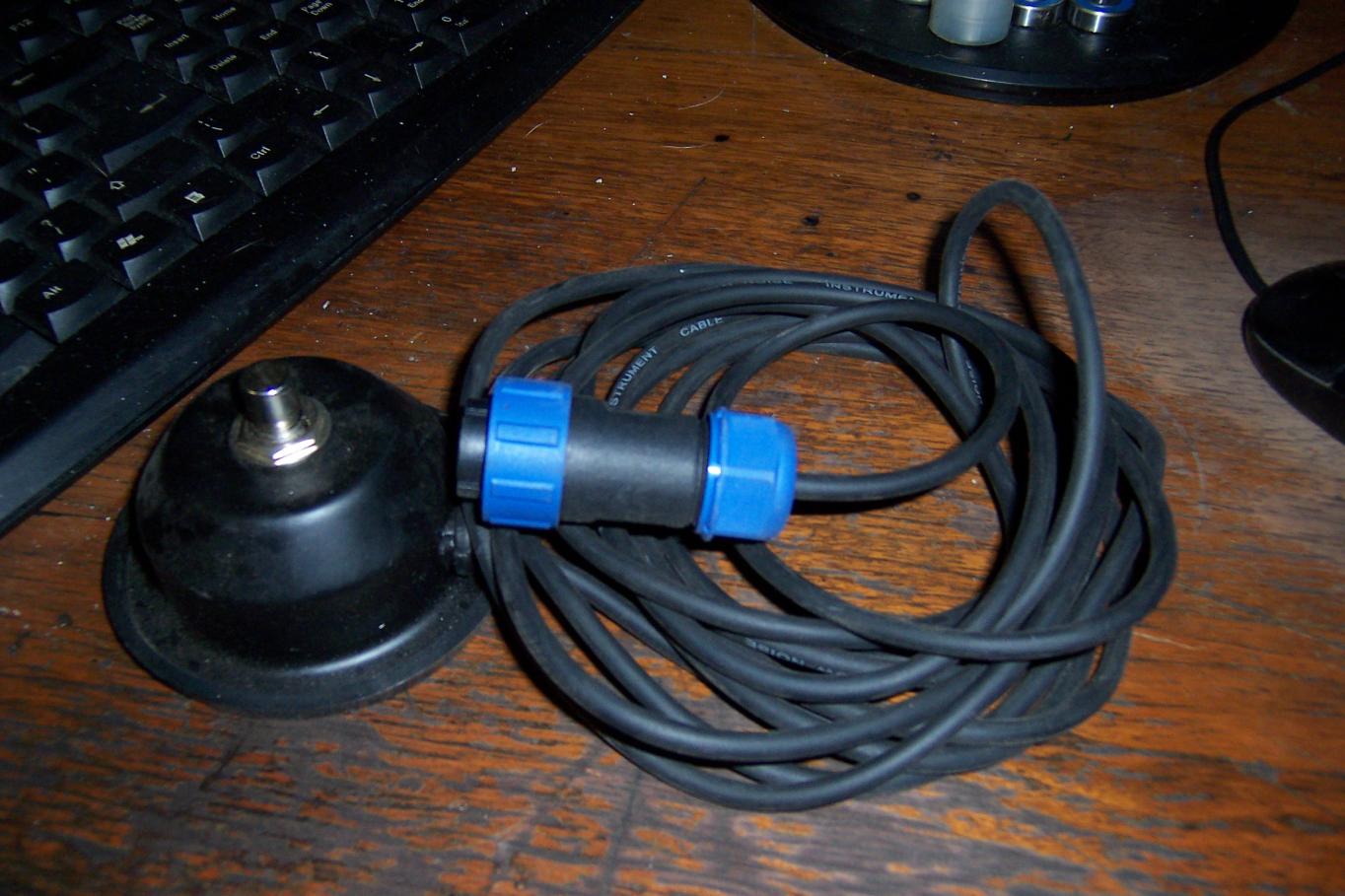

    http://www.ebay.com/itm/Single-Butto...item27c17635e5 i used this switch on my plasma cutter

    Attachment 7689lol i know i cut the end off switch and installed the cnc plug on it . it works good on my tracing table to turn torch off and on Click image for larger version.
Name:	86 truck 001.jpg
ID:	7688 its a when pushing down it has connection when not pressed has open circuit , when pushed down torch activates and when released torch turns off . connected wires to pins 1 and 2 on connector

    1. Check the pins in the plug on the end of the plasma torch cable with an ohm meter or continuity tester, while pressing and releasing the torch switch. That will tell you which pins are used to activate the torch.
    2. Get an extra plug to mate with the front panel connector (everlast, digikey.com, mouser.com, etc).
    3. Wire your foot switch to the two pins you located in step 1.
    4. Connect the torch as normal (dinse, gas, pilot arc), but plug in your new foot switch instead of the torch cable plug.
    5. Be careful as with the torch and switch separated it might be easier than normal to hit the switch while the torch is not pointed in a safe direction.
