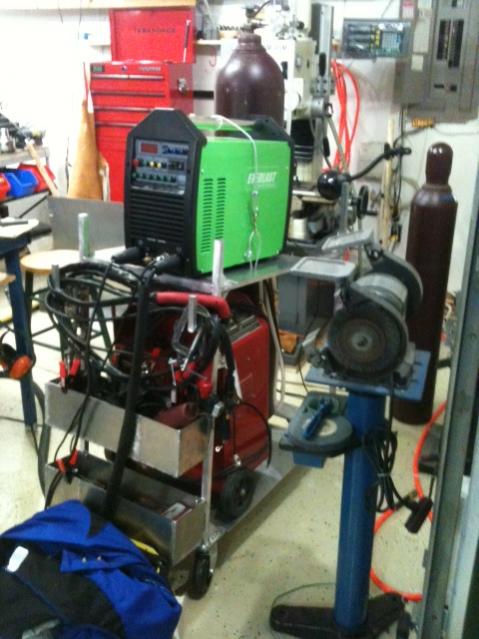

    And just for completeness, here's the latest pic of the welding cart with some front hooks and boxes mounted and a tie-down for the Green Hulk. I knew I'd find a purpose for that piece of coated cable that's been in the shop for the last 5 years...
    Just as I feared, the cart "over-runneth" with stuff. Need to put some boxes on the back and a filler-rod rack under the top shelf... Probably 1-2 years from now, I'll be done with it
