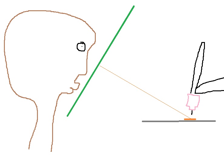

    I just got a 250ex tig and a fabricator mask. It's pretty sweet getting to learn on the 250ex, but I have a problem (I'm probably just doing something wrong). I think it's the mask (because without the mask, the arc doesn't seem to get drastically brighter or dimmer when watching the reflection on the wall)
    When welding some 24ga sheet metal @ 20-30 amps, the shade level on the mask instantly jumps from pretty shaded, to hardly shaded. When the shade level jumps down, it's not a blinding light, but the light is bright enough where it's hard to see my weld area anymore. I was welding yesterday night with my friend (who has some weld experience, but none with an auto dimming mask), and he had the same problem. I tried to make sure the sensors were right perpendicular to the arc, but I don't think that made a considerable difference.
    sensitivity was set to 3 bars
    shade level was 8
    delay was fast
    any ideas?
    Thanks,

    I meant that my line of sight is perpendicular to the mask, like in the attached picture. I thought this was the best way to do it so that there wasn't any reflection due to the "critical angle" of the transparent shield in front of the sensors. I had about 1/4" of tungsten sticking out of my torch at all times, if not 3/8", and I was about 1/8 to 3/16" away from the workpiece. I'm obviously learning, so I don't know exactly what I need to do here, should I stick the tungsten out further? Do you think there's intermittent shade interruption because the light goes away? or it's just not enough light at 20-30 amps?
    I also tried to mount the sensors upside down so they would be lower, relative to my eyes, but that didnt seem to help either.

    The stick out and standoff height is actually too long. You should have about a credit card thickness under the tungsten between it and the metal. The stickout should be 1/4" or less. One thing is possible: that you were varying your arc length (with such a long one), tricking the helmet into thinking the arc was going out.

    I agree with Mark, check that the stick-out out less than 1/4", arc length short, helmet in tight (maybe turn your head to the side more to expose the sensors and see if there is a change). Also try different angles on the torch more towards vertical and see of that helps. You have nothing above that would be blocking the sensors on the lens right? Like working around a vertical piece.
