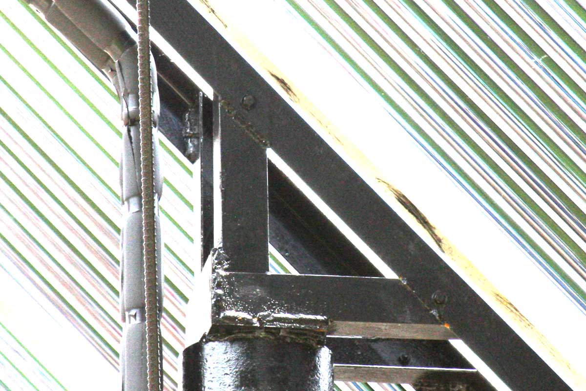

    That may be true for good fittings, but this cheap chinese fittings are so crappy they will not seal no matter how tight without some sort of filler. I actually split one fitting tightening it trying to stop the leak. it bottomed out and then broke.
    What I ended up doing (and the reason I was up so late last night) was just rebuilding the whole top section of the work station out of copper. If I remember correctly I removed 13 connections (leaks). The top is leak free now, unfortunately the bottom is not. It is only a very small leak but a leak none the less. What I will probably do is move some of the fittings around on the bottom as the leak is where 2 of the crap fitting meet. There are no leaks on US (most likely made in china but to higher quality) to the crap fittings. I added a fill port on the bottom with a shutoff valve, so I can most likely just move it and not have the 2 crap fittings together.
    It has been a real pain and if I could do it all over again I would just buy the controller and pump and build the work station myself (which I ended up doing anyways!)

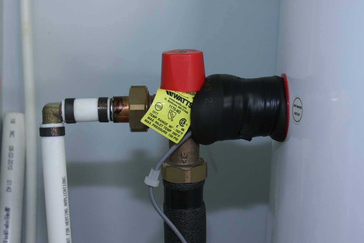

    The first picture is the tempering valve as mentioned in the post below. Not only is this a great safety feature but it also effectively increases the capacity of the tank by allowing you to have hotter water in the storage tank. This 100 gallon tank at 180deg will put out the same as a 200 gallon tank at 120 deg (assuming 60 deg inlet water). To me this should have been standard in a solar setup, but it was not!

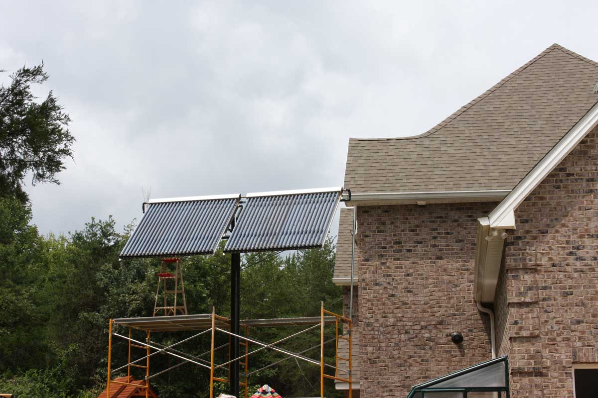

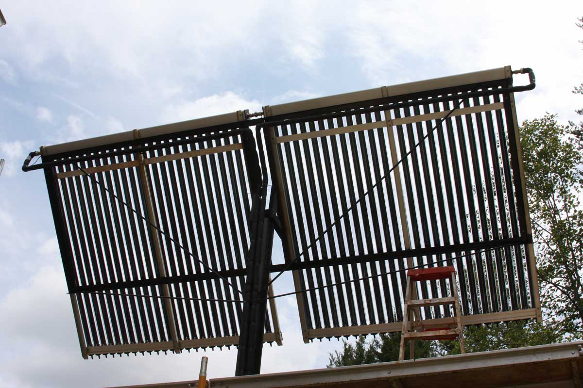

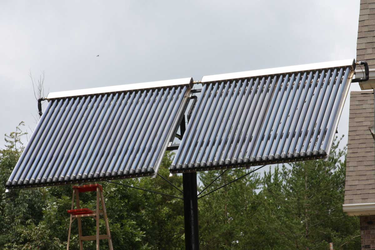

    The 2-4 picture is of the solar collectors.
    The 5th is of the top portion of the workstation. A little work and copper but no more leaks.

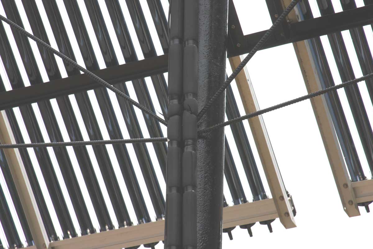

    The 6th is showing how I mounted the collector to the 6" pole. The mount is made from scrap brick lentil (.250" thick) and 4 pieces of .125" 2" angle 12" long. I bolted it together in the ground and welded the angle to the .250 plate. Then unbolted it and welded the plate to the pole. The the fun part was lifting the frame up on the scaffolding and bolting it to the mount. Once that was done I welded it all together.

    There are 2 reasons I did not mount on the roof, 1st is I did not want any possibility of roof leaks, and second (and probably the real reason) is the damn roof is steep and I don't like heights. The panels (tubes) are facing south so they do not need rotating. Also since they are tubes the surface area allows for better solar collection the entire day (different angles to the sun).
    It is fairly cloudy today but when I took the pictures the collectors were at 127 degrees with the lower portion of the tank at 118 degrees. So they seem to work fairly well even on a cloudy (but bright) day. They should work well in the winter also as the tubes are vacuum tubes and well insulated. Or at least that's what I have read. I will find out in a few months.
