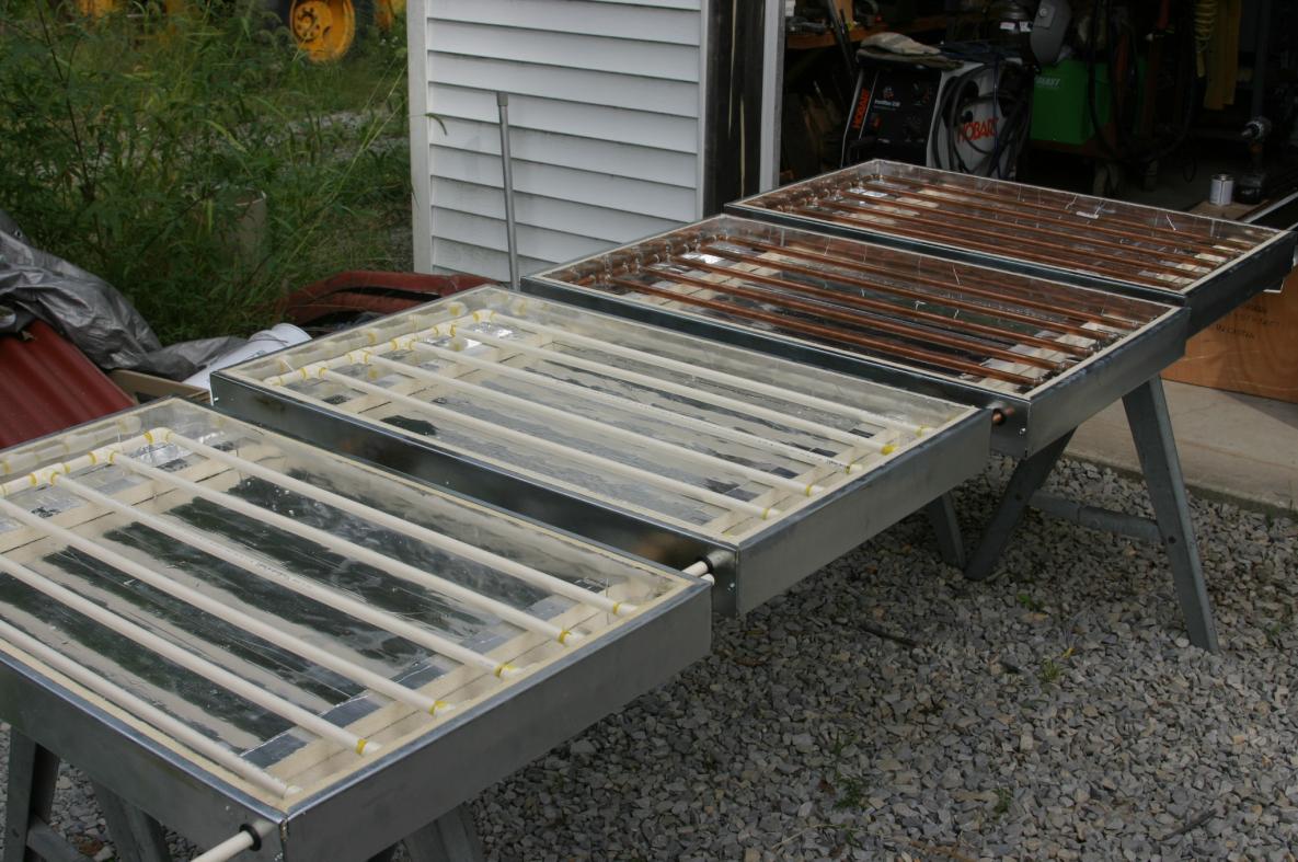

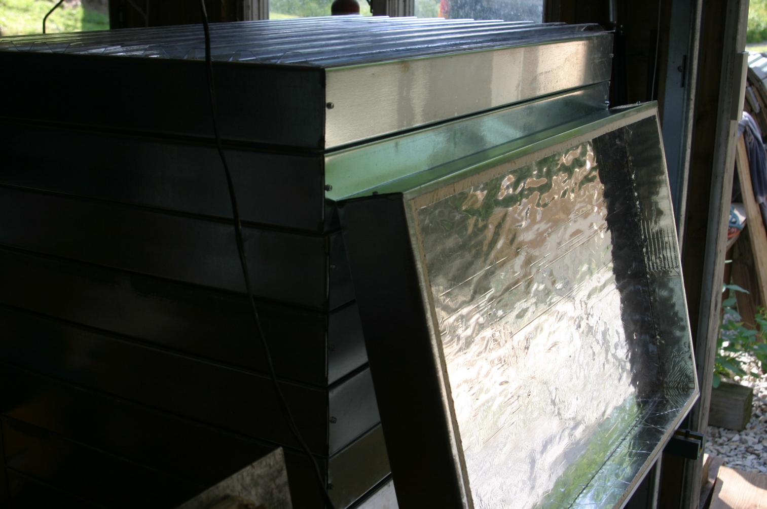

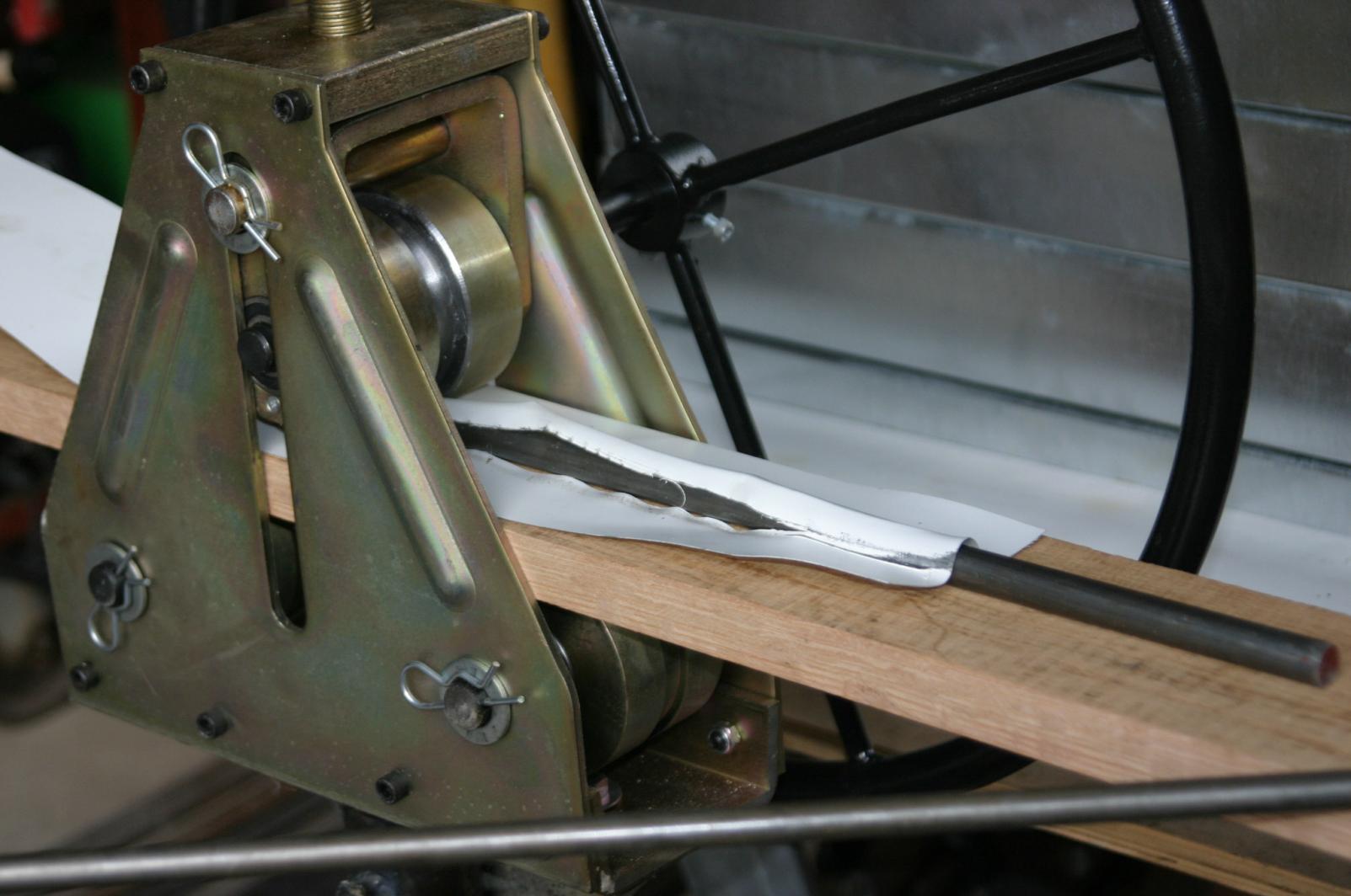

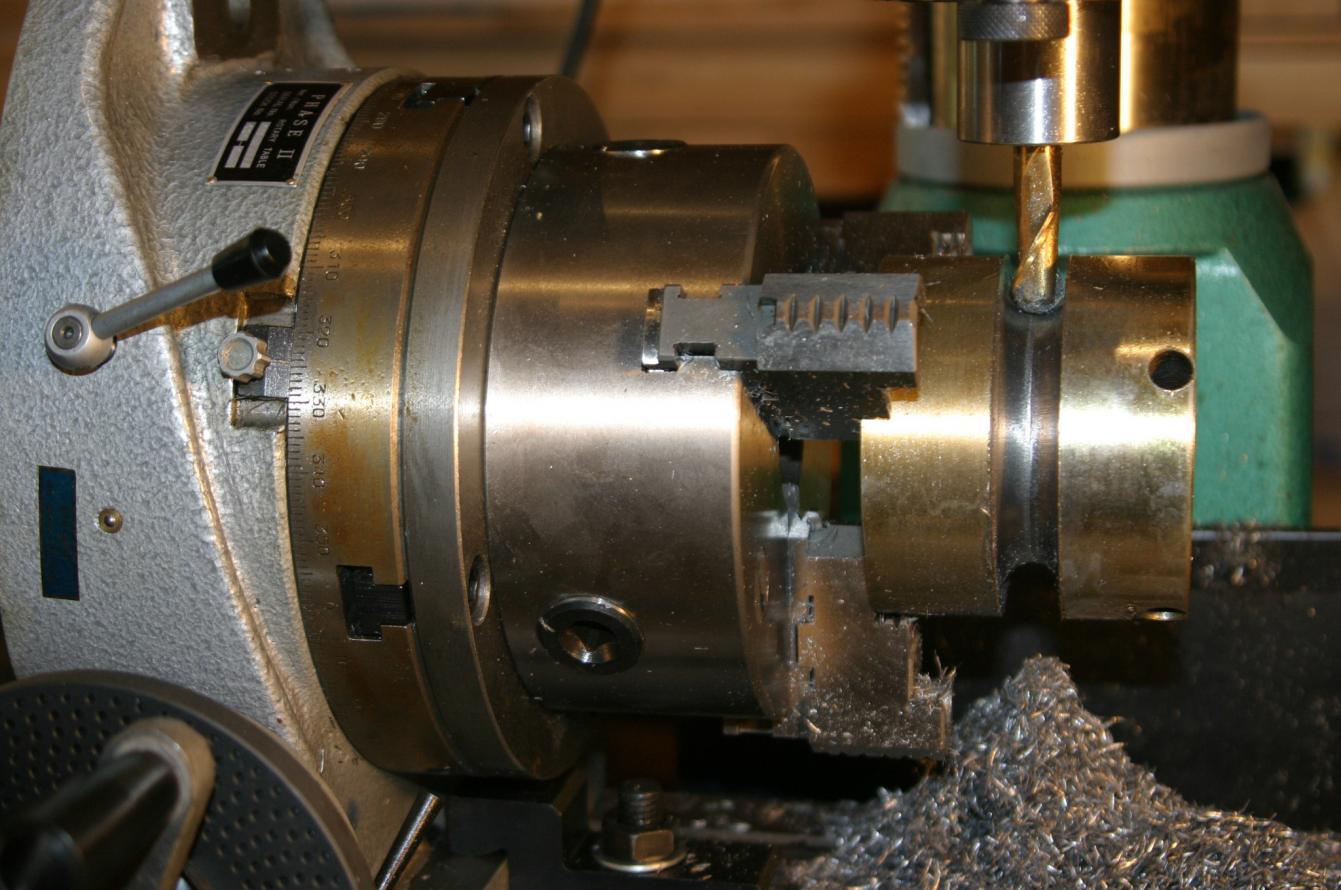

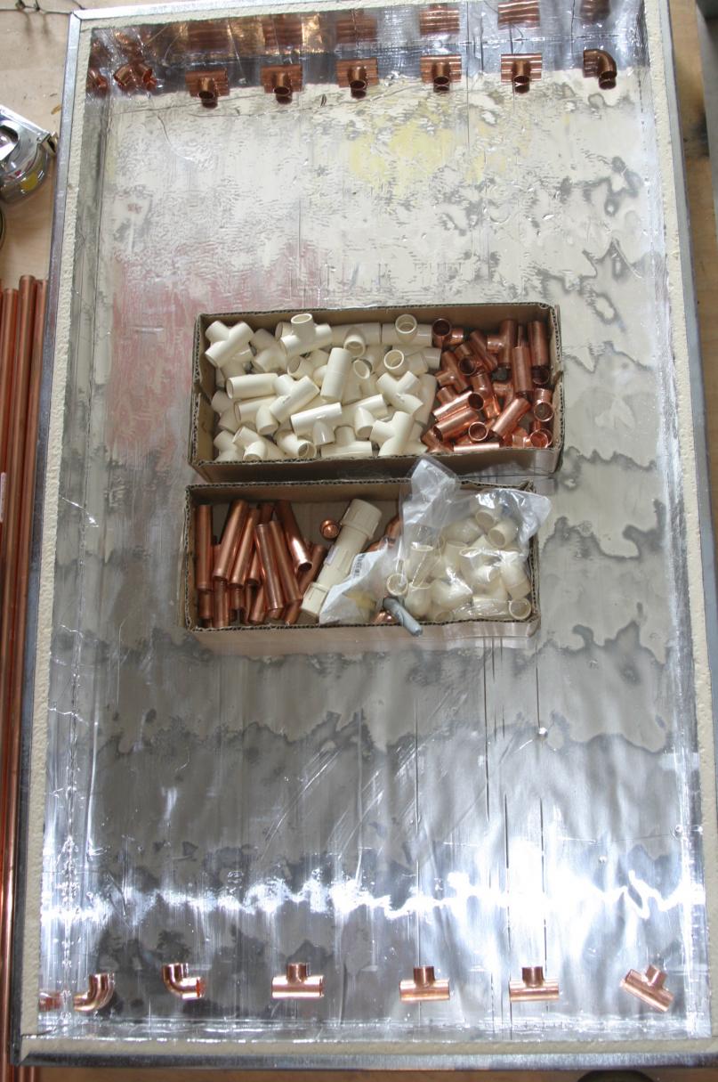

    I have a solar project that is on the back burner. Heard that the % difference between CU and CPVC was small, so I'm going to test both. Modified a HF tube roller to make fins, FAIL.. have to work on that one, or just bend them in the brake.

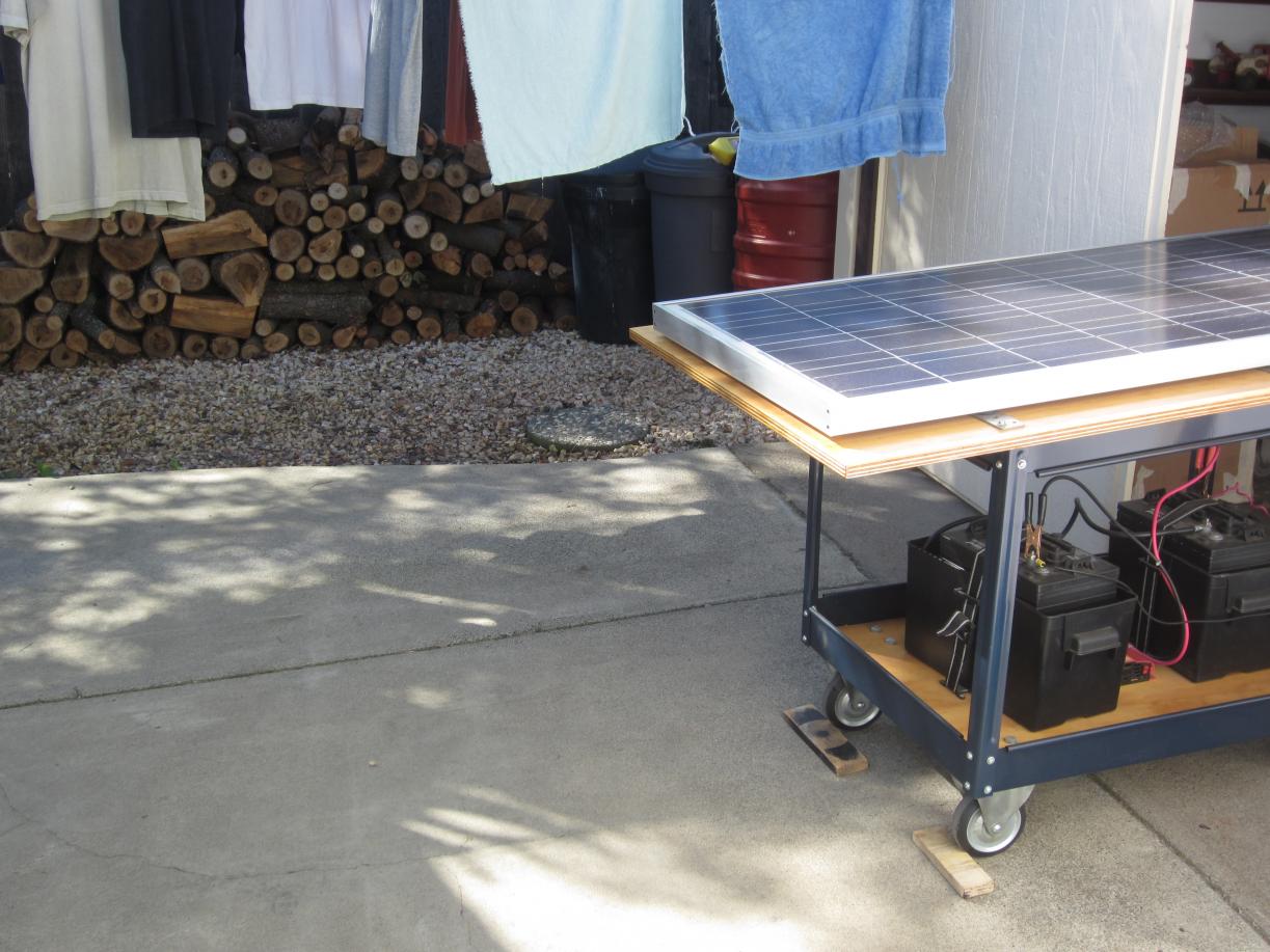

    Pics of one solar cart (losing daylight by the minute!) and the leaky stainless water (pre-heat) tank are attached. The neighbor's think we're idiots for trying to save on our household expenses...yet they complain about their $200-300 PG&E bills constantly and they're never even home!
