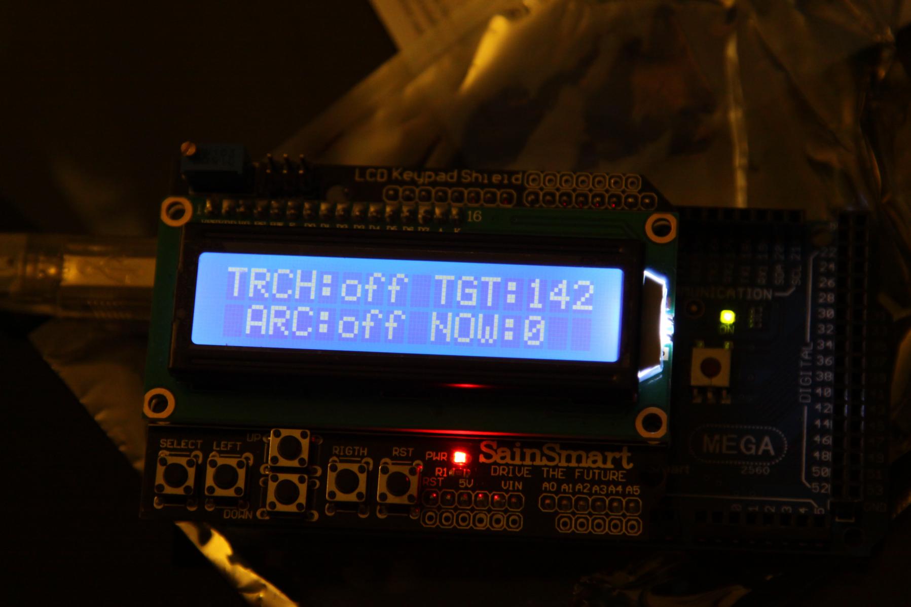

    I have a 16 character by 2 line display that came with the Arduino Mega 2560 I bought on eBay.
    I've been thinking about what type of capabilities I'd want on a THC and how a menu system would work on the small 16x2 dispaly. Assuming the use of four push buttons (<Up>, <Down>, <Menu/Select>, <Cancel>), I came up with the following:

    Thanks Ram.
    I menu I have now gives:
    • Torch on Status (on/off)
    • Arc good status (on/off)
    • target voltage
    • current voltage
    The display is too small to show the up/down arrows, but that makes sense. I'll have to abbreviate more.

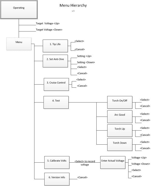

    Spent some time working on the menus. Rearranged and simplified them as I worked on implementing them. The new structure is below.
Name:	THC Menu Hierarchy - v3.jpg
    The "Cruise Control" name was Rambozo's idea. It will allow you to run without height control until you adjust the height to where you want it. When you hit <SELECT>, it will then take that voltage readnig as a setting and start running (at least in theory).
    I'm still not sure if I need to keep the "Calibrate". It's intent is to allow adjusting the actual voltage display.
    "Tip Life" is a simple time counter that can be reset. (Potentially could used to compensate for electrode wear in the future.)
    "Anti-Dive" would attempt to detect when you're crossing a previously cut line and not send the torch crashing down. This would probably work by detecting a more rapid change than with curved metal. I'm wondering if the setting might be able to be caclulated by using the cutting speed (in IPS) to calculate how fast the drop would be and how long it would last when crossing an existing cut.

    I would keep the Calibrate option. Since there are inline resistors in the full arc voltage output lines and several possibilities of voltage divider circuits (external and internal) It would be nice to be able to measure at the torch and calibrate the system to read correctly. That way you can use published data tables as a starting point for materials you have never cut before, and be pretty close right off the bat.
    Okay, I'll keep it.
